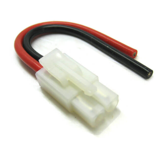

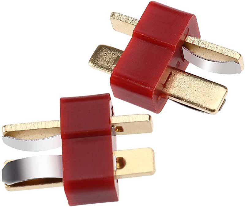

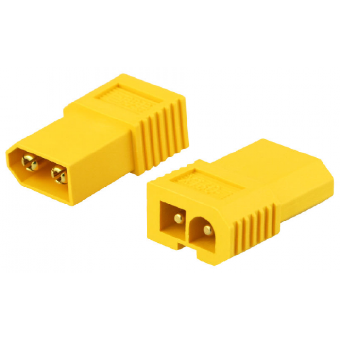

the voltage 7.2 volts, the connector? function of the one existing on the tank currently? in general, Tamiya
Tamiya :
XT 60 :
Dean :
Surely there are other types? but these are the most common
mrmetallica
Posts: 95
Joined: Sat Mar 18, 2023 10:11 pm
Location: london
Re: which battery ?
Post by mrmetallica »
Jofaur86 wrote: Fri Apr 21, 2023 12:48 pm the voltage 7.2 volts, the connector? function of the one existing on the tank currently? in general, Tamiya
Tamiya :
XT 60 :
Dean :
thank you sooo much :D

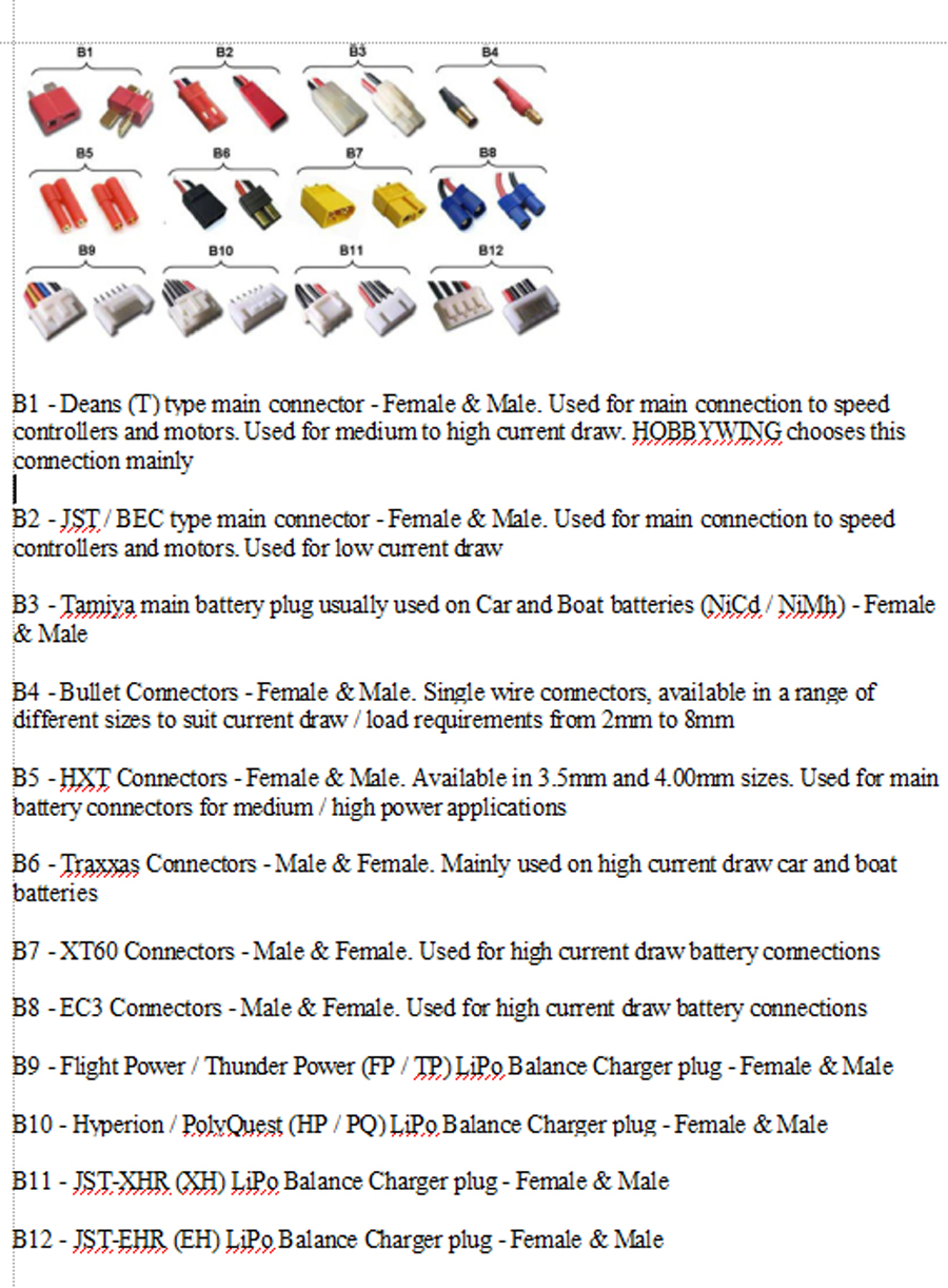

Posts: 5990
Re: which battery ?
mrmetallica
Posts: 95
Location: london
Re: which battery ?
Herr Dr. Professor wrote: Fri Apr 21, 2023 5:28 pm Connectors.jpg
wkd thank you. i feel like im at school again :haha:
