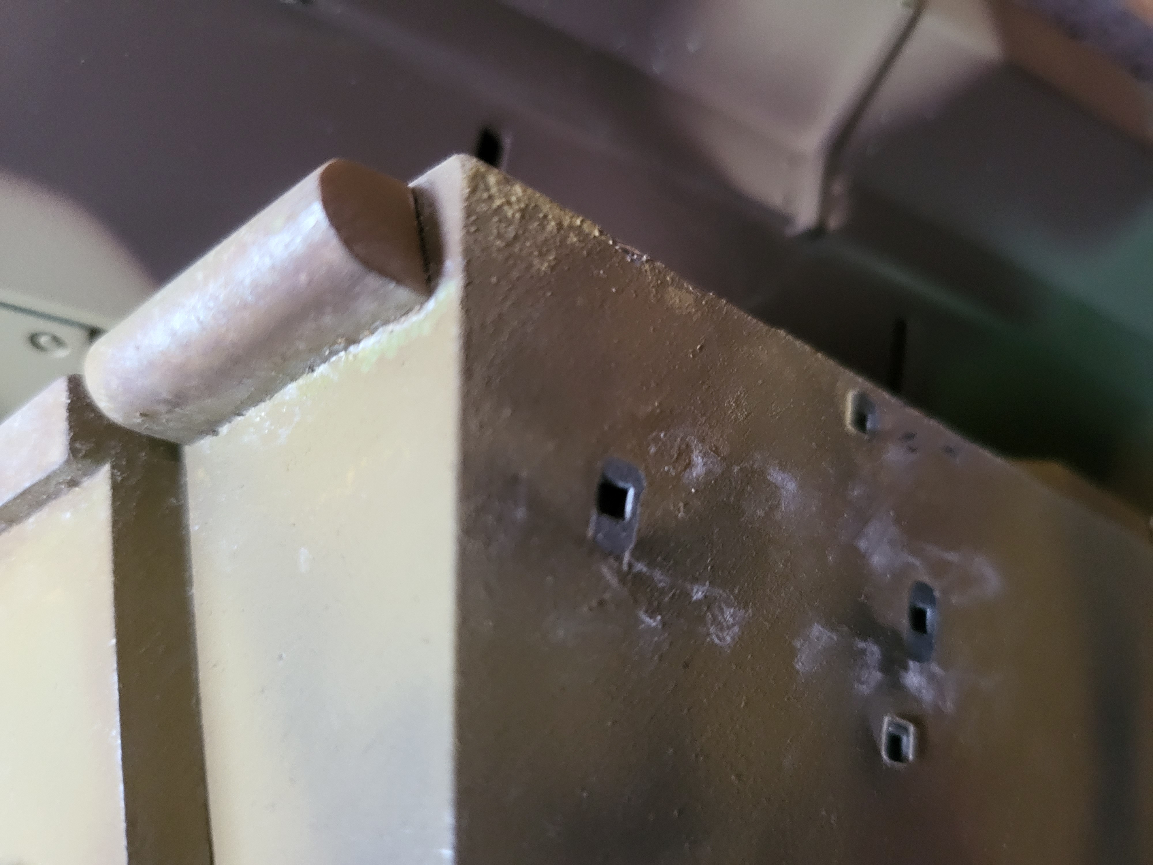

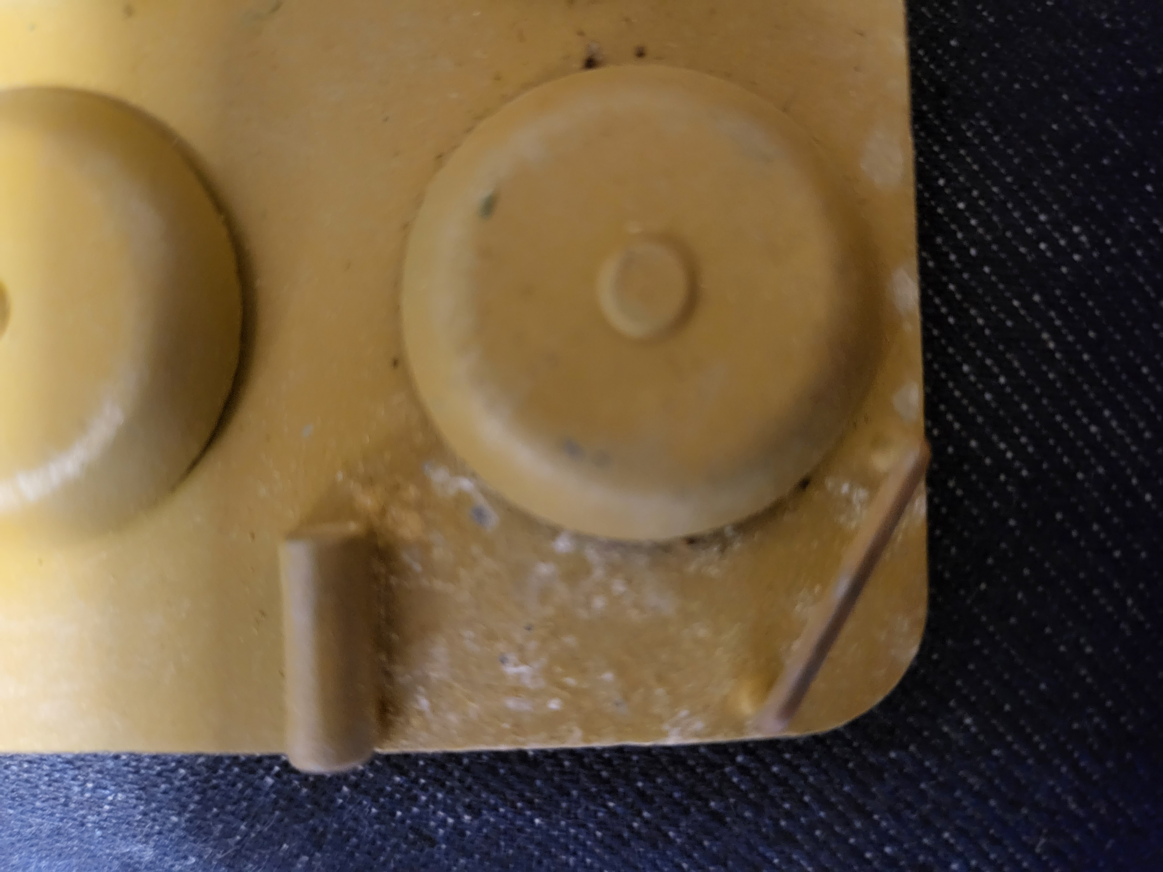

Pics of bad bits. Deck will be easy to replace with plastic but turret not so.
Apologies in advance but my camera skills are non existent
I had major problems with some die cast car makes and did not want to have to repeat it with the tanks as you were always chasing it on the cars

The first picture looks like where the tracks are hung on the side of the turret so maybe the tracks weren't finished? And on the corner edge where it looks bubbled and corroded, maybe poor or incomplete paint application? And the turret rear hatch hinge and rear deck hatch again paint application?
Heck if you didn't paint it who knows what is under the paint and maybe why it looks bubbled up on the corner.

The paint on the turret is a bit thin and not sure what or how much primer there is on it. I am now wondering when you mention that it was where the tracks would sit whether some sacrificial corrosion took place with two types of metal in contact. It would start the creep of corrosion if that is the case.
THe inside of the hatch is unpainted and does have the corrosion on it but not looked inside the turret so far. I ill take a check.
