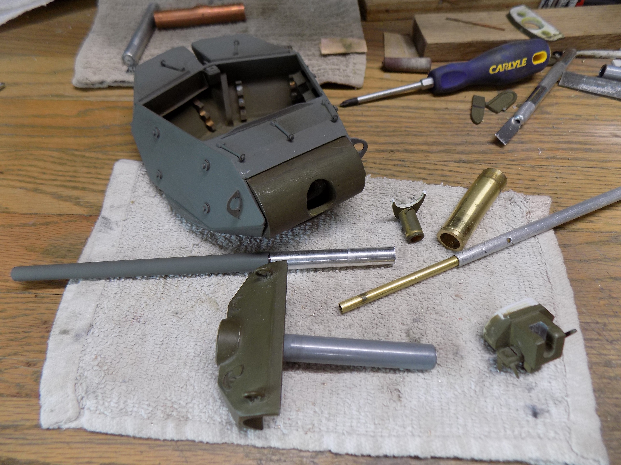

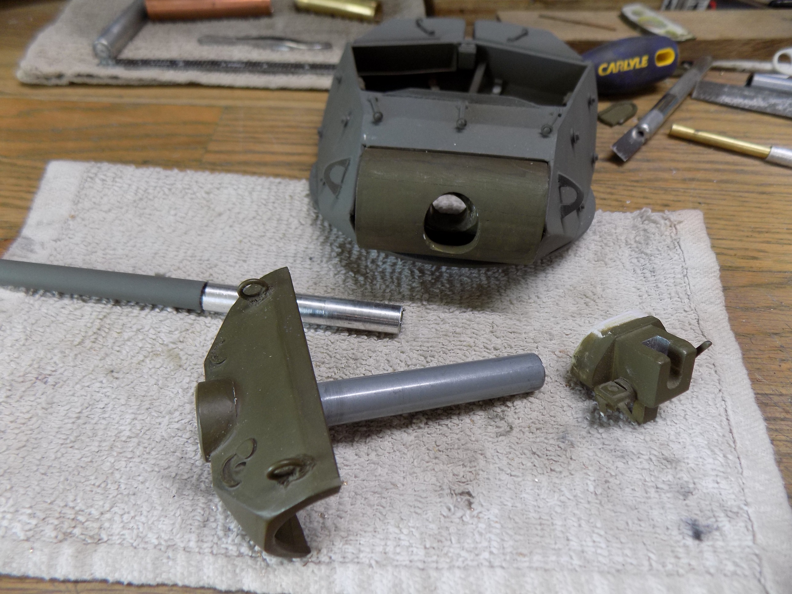

I've started with a sleeve that the barrel can slide in and also joins the rotor shield and trunion. Now it's time to work out the recoil cylinders and such. The rotor is installed from inside turret and the sleeve and rotor shield press in from the front. Working out the rest to be removable for maintenance.
Stay tuned...

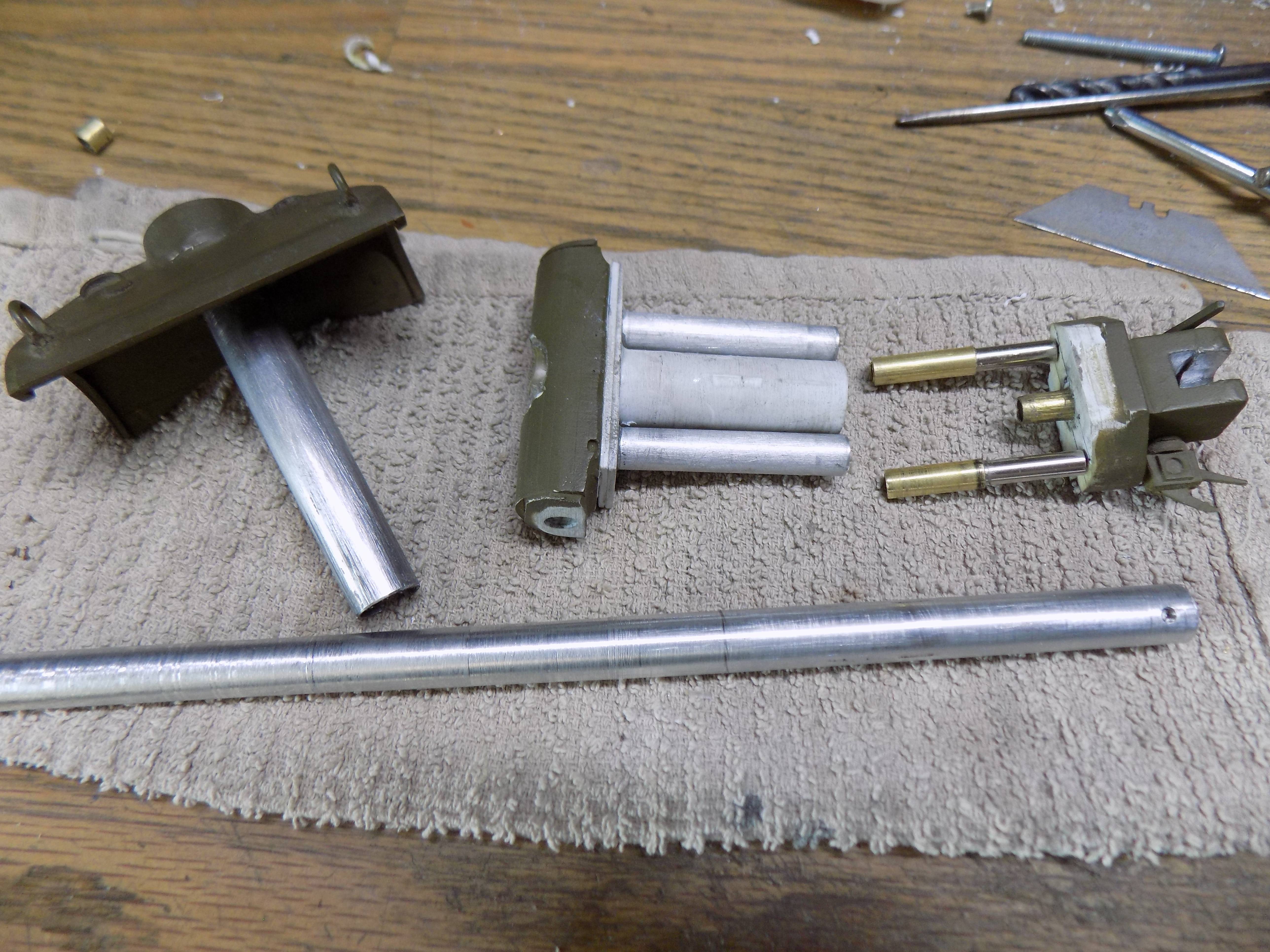

Sleeve not yet cut to length yet but does have a nice fit to rotor/trunnion.
Upper right are the old recoil cylinder and breach. The brass rod in the aluminum tube will likely become the new cylinders. This will help scale down things a bit. Mike's reference pictures of the 1/6th M10 really helps....
Again this is stuff laying around. That sleeve is tubing cut from an old camping chair that was thrown away.

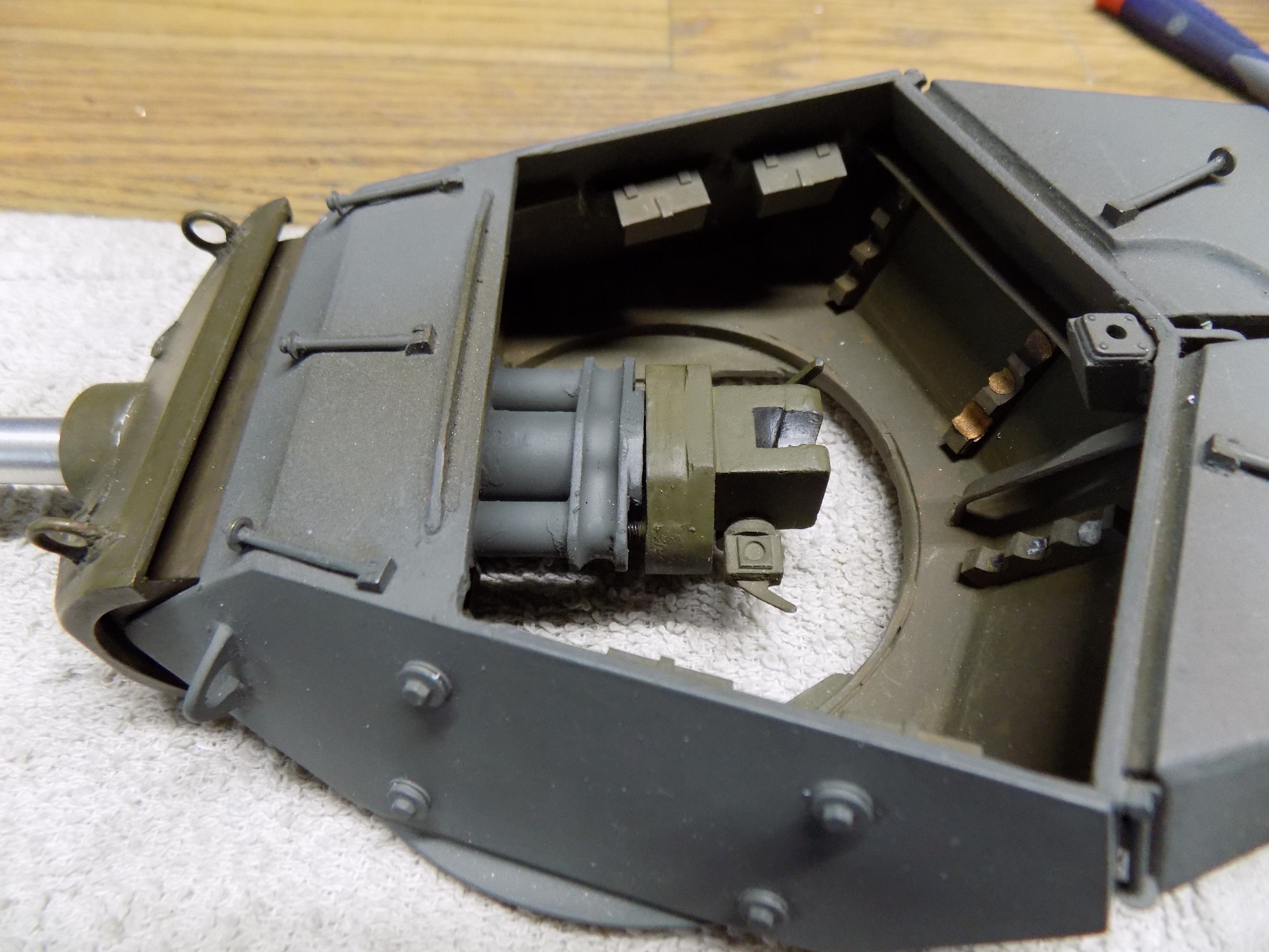

Here is the start to the conversion. Just had to save/reuse the the breach end as it was the first scratch build, couldn't bear to throw it out. Ended up turning a replacement barrel, the original was too short to reach the breach. Barrel has not been tapered yet in this picture, pencil mark shows where it leaves rotor shield.

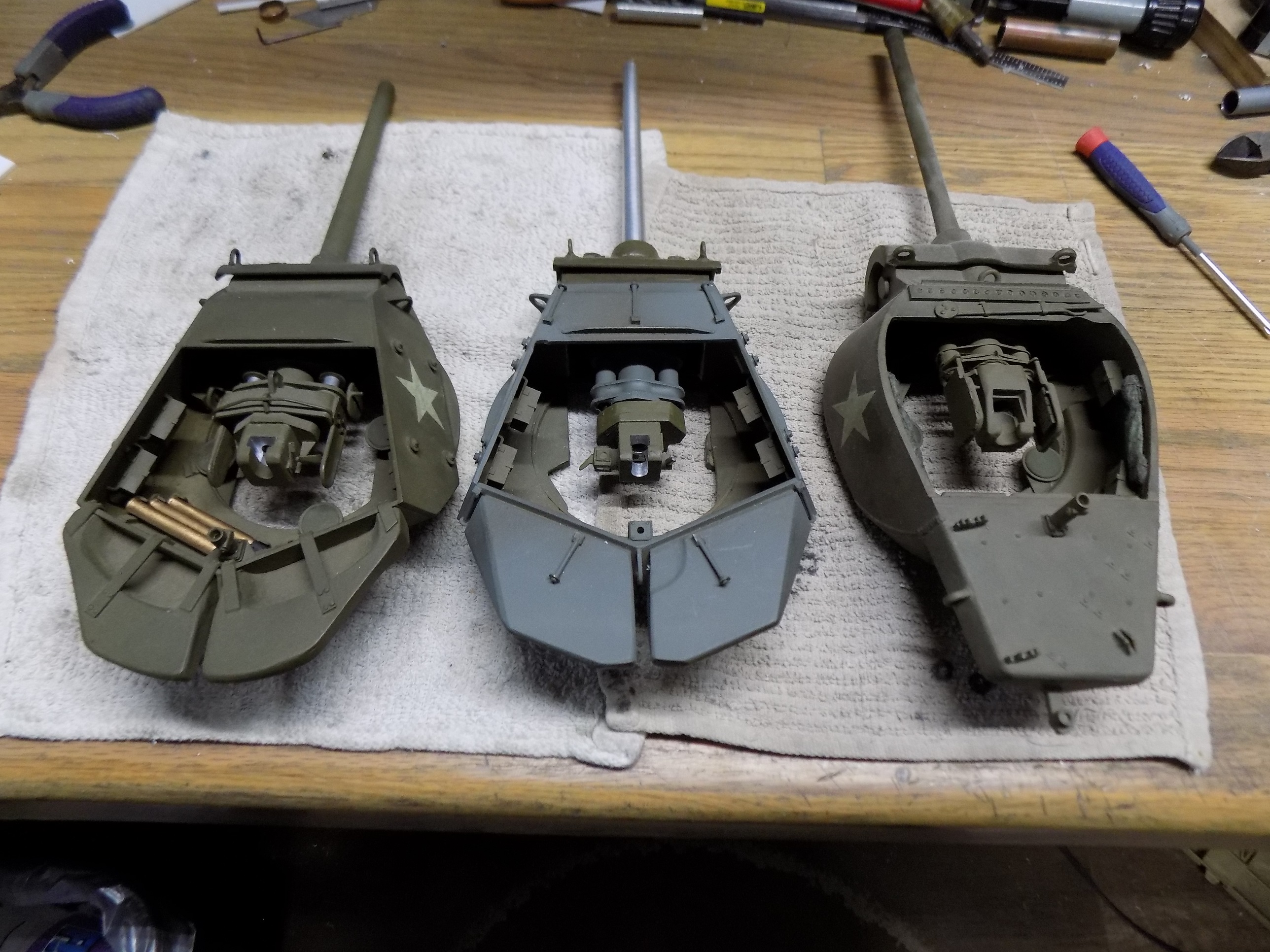

Here are the three turrets. The gun in the M10 (left side) is the same size as the center one used to be, before the rework. M36 is a Nick Aguilar turret kit (right), seems to be the right size. Barrel has now been cut to length and is tapered.

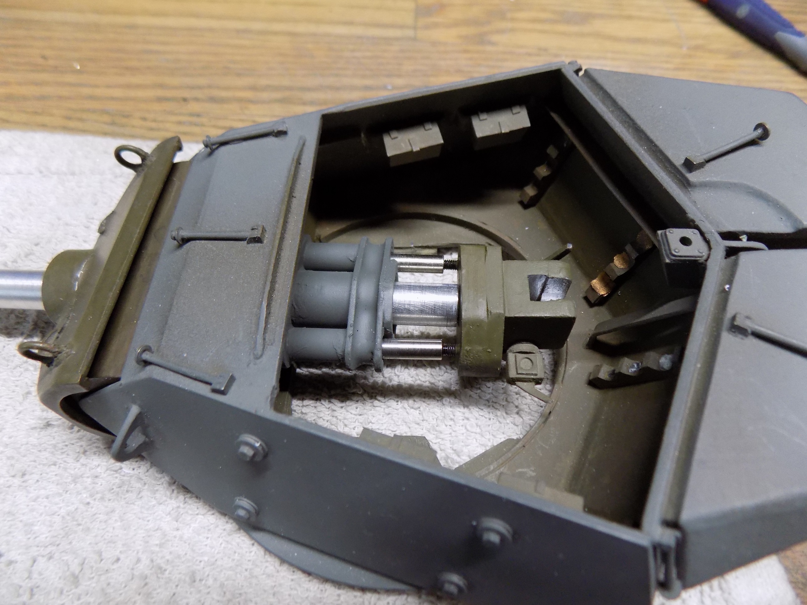

Not mechanized yet, but here is the smooth sliding barrel and breach.
On to gun detail and figuring out how this is going to have hidden recoil.
