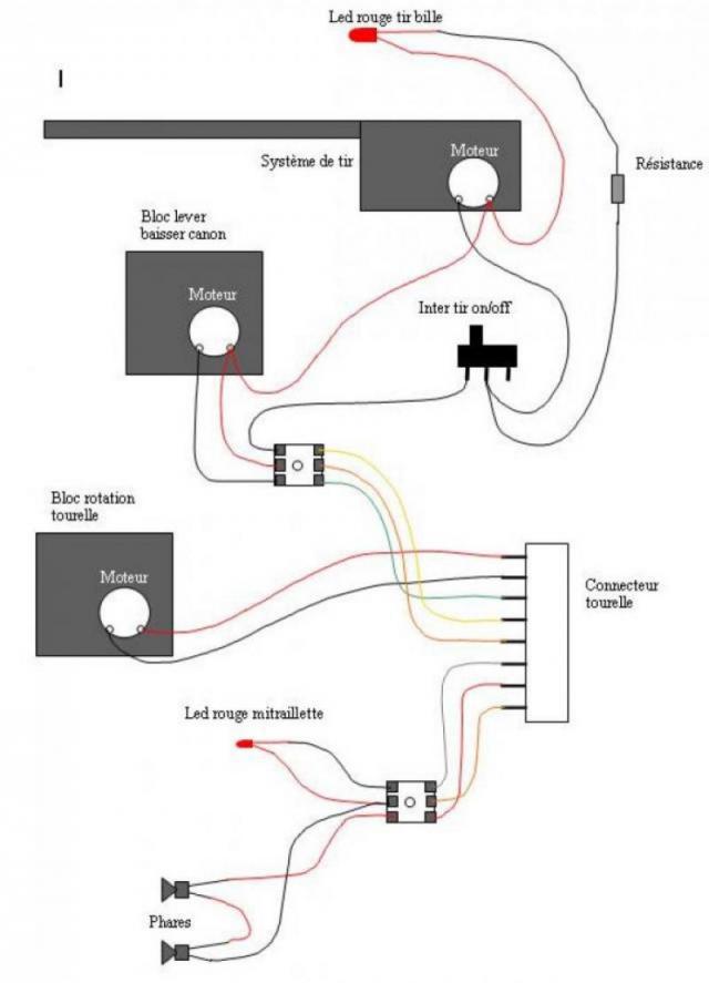

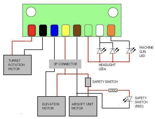

I don't understand ? that you have not found what you are looking for? I had attached the link from Rctankelectronics. Ibu supplier and on which there are quantities and types of plates, with the different connections. There are photo numbers according to plate type, and indicating the different connections
https://www.rctankelectronics.com/uploa ... h_v2.4.pdf
A photo of your turntable, will make it easier to identify

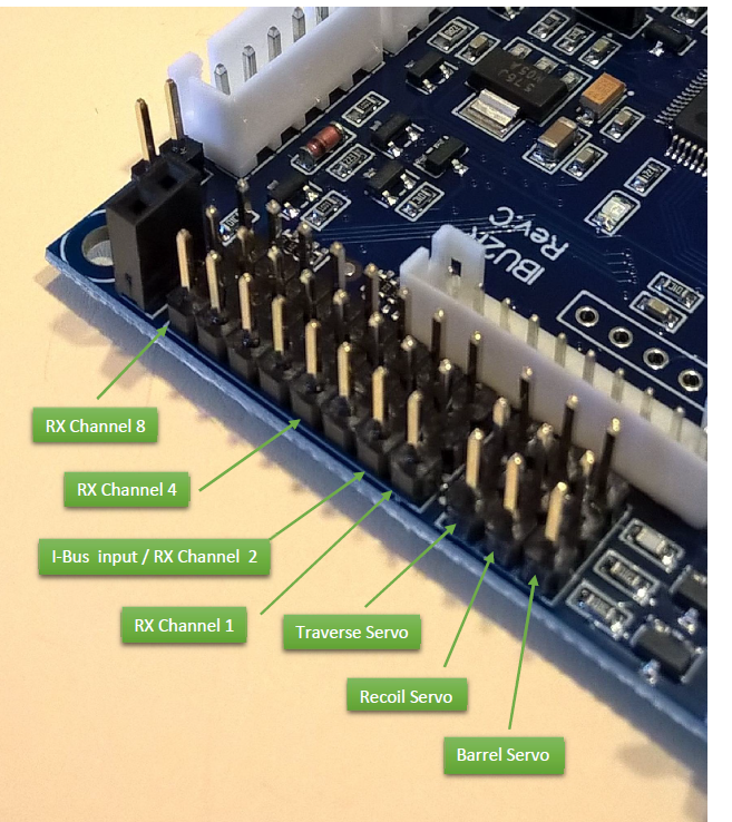

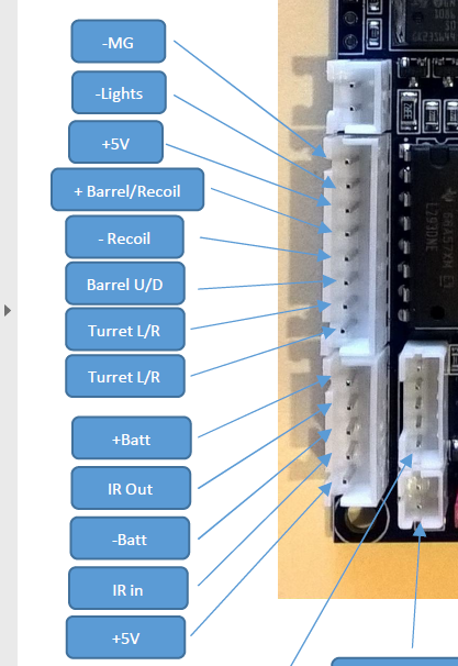

Hi Jofaur,
Above are a couple of photos of the IBU2 board.
On the bottom photo of the HL port, I have successfully connected the turret traverse, the mg and the headlight.
There is no mention on the connections of Airsoft canon. The barrel connections are for elevation and recoil, neither of which I am using.
The first photo shows the servo connections on the IBU2 board. I want to use the servo outputs marked " Traverse servo " and " Recoil servo ". I have connected the servos as the connections show and get no reaction from the Traverse servo. I do not expect the recoil servo to react until I get the Airsoft canon to operate and therefor the Airsoft switch will activate and trigger both sound and recoil servo.

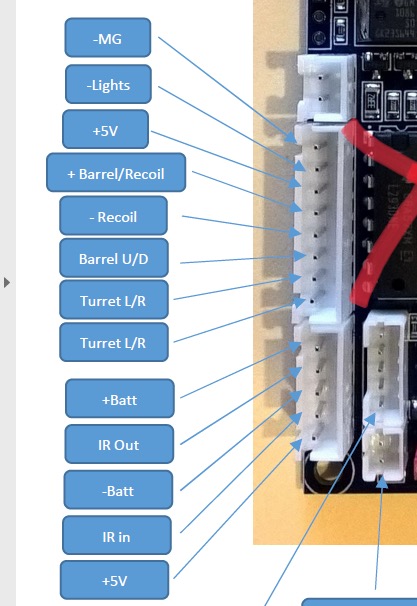

Hi Jofaur
![Image]()
On the photo, the yellow highlighted 2 pin plug is power for the Airsoft canon. The red highlighted 5 pin plug with only 2 wires in it is the Airsoft switch, this plugs into the HL Xenon socket.
The problem is I get no movement on the barrel elevation servo and do not know where to connect the Airsoft canon to.
- Turret Highlight.jpg (107.48 KiB) Viewed 3657 times
