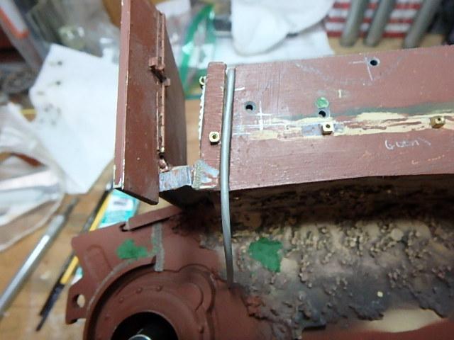

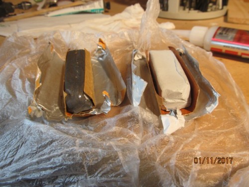

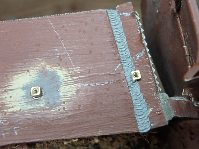

Soeren wrote:Great update :). What did you use for the Zim repair? And what wire size is it for the tie down loops?
Thanks Soeren,
For the Zimmerit repairs I used a product called "Procreate" two part putty. I think there is a joke about the name of this product somewhere on this blog. I also use this to make weld seams...works really good. If your interested its on page three of this blog.
PRO CREATE 1.jpg (47.53 KiB) Viewed 5030 times
PRO CREATE 2.jpg (54.05 KiB) Viewed 5030 times
PRO CREATE 3.jpg (40.69 KiB) Viewed 5030 times
Just cut off equal amounts and knead them together until color is light gray, and then your ready to Rock & Roll...
Once its cured its hard as a rock.
The wire size I used for the tie down lashings is .020" or .51mm or K&S #8159
It seemed to look proportional to me.

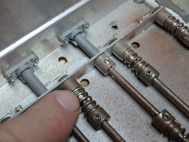

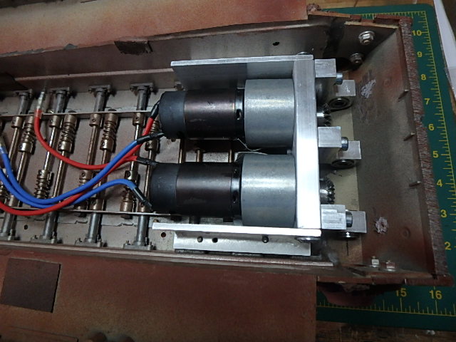

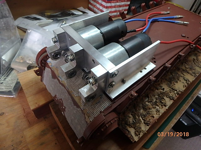

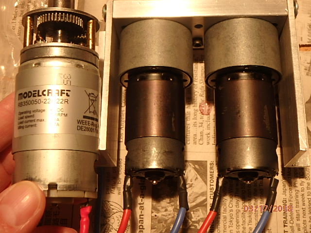

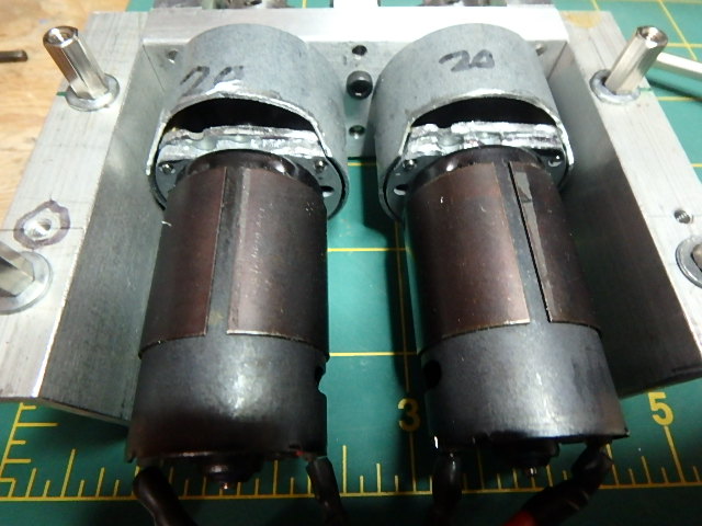

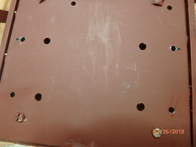

I think where I left off was mounting the motors. I bought some new black cans from ETO Armor many moons ago and they have been sitting
in a box under my work bench. I tested them out and they still work. There is a noticeable size difference from the ones i was going to install

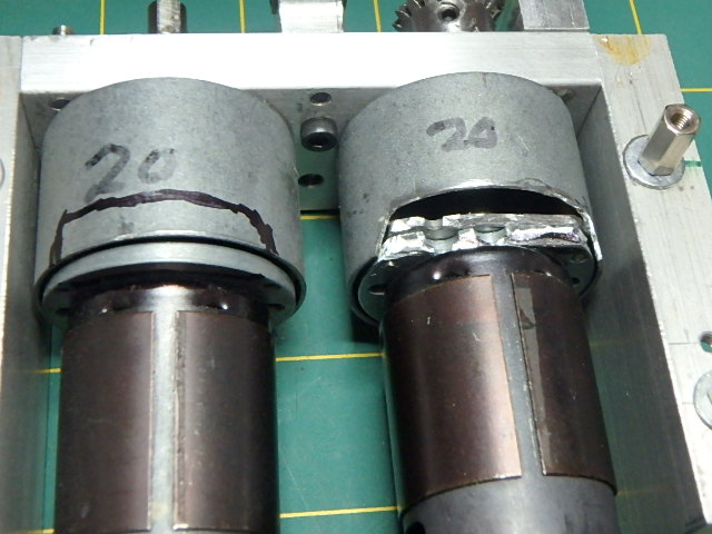

originally. I also had to make some mods to the base plate by drilling a couple new holes for the motor base as well as trim off a portion of the motor housing so it would not hit my Torsion Bar suspension springs.
BIG SIZE DIFF IN OLD  MOTOR vs BLACK CANS
EYE BALLING WHERE NEW MOUNTING HOLES NEED TO BE
HOLES PUNCHED OUT
HOLES PUNCHED OUT
SUSPENSION TO MOTOR CONFLICT
MARKED WHERE TO CUT HOUSING FOR PROPER FIT
HACK JOB
HACK JOB
MOTORS DRY FIT, CLEARANCE IS GOOD

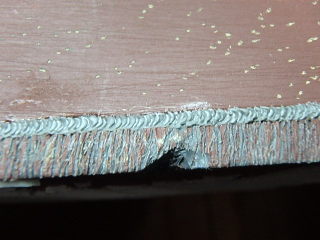

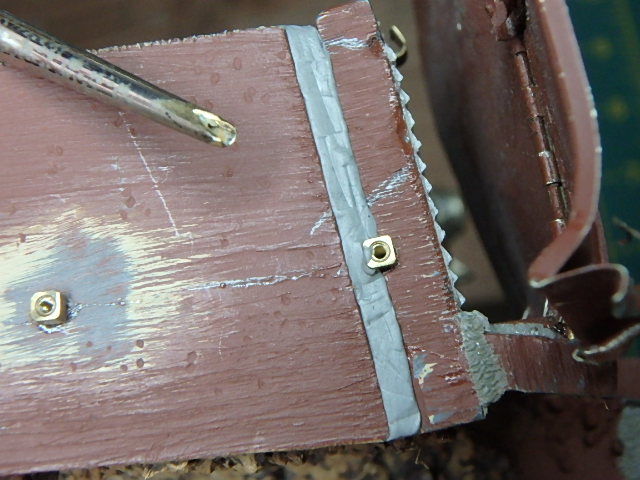

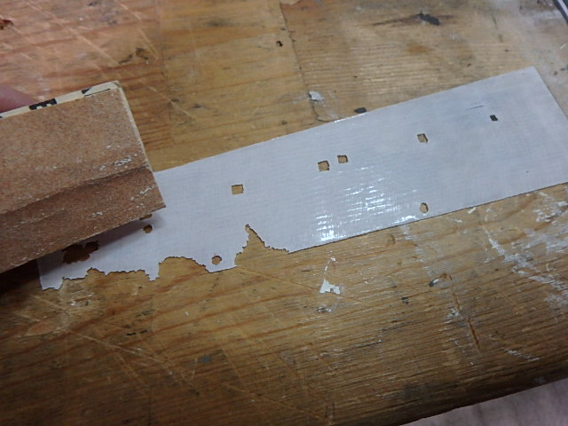

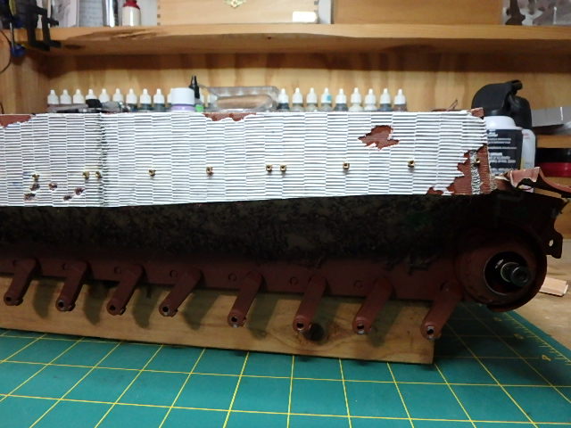

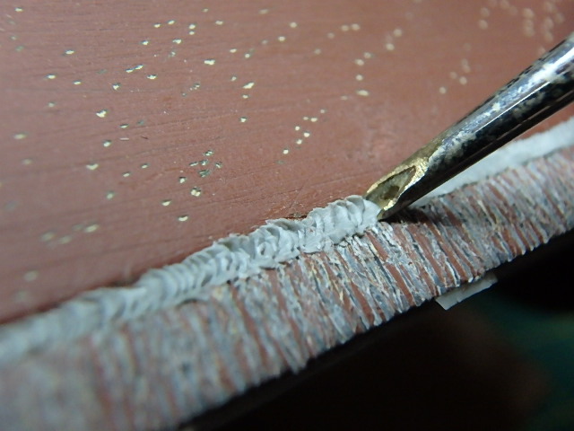

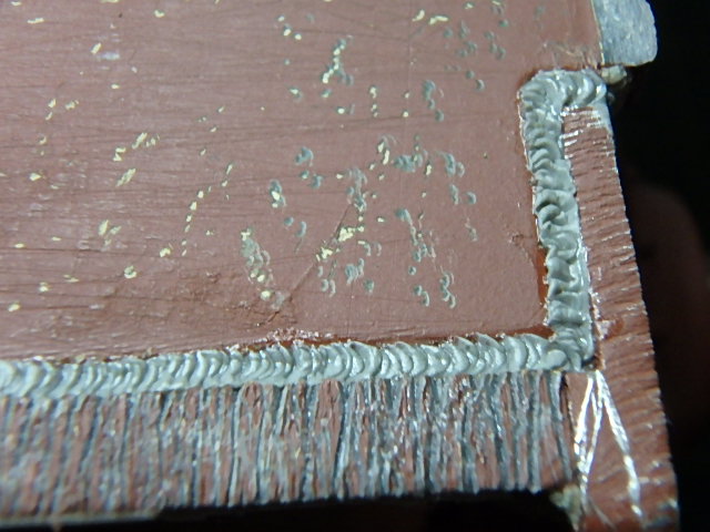

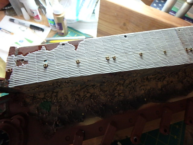

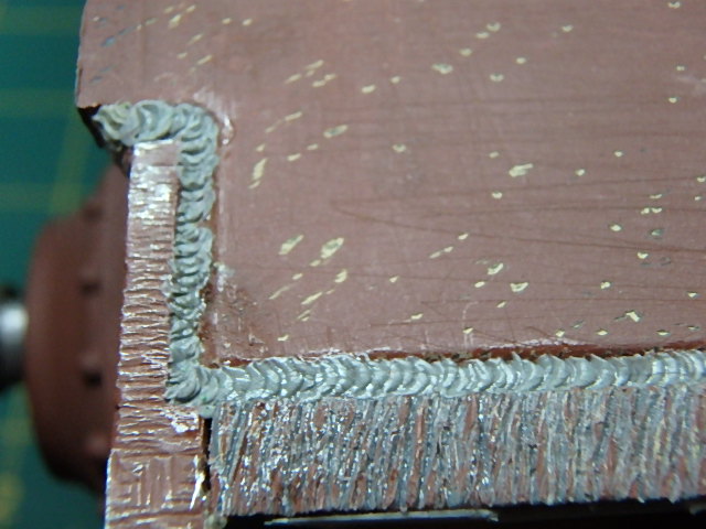

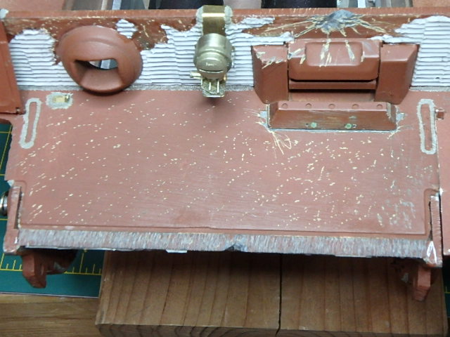

Now that motors are installed I can attach the front hull and add some details. ATAK model Zimmerit & some ProCreate weld seams...
ProCreate putty for weld seams
CUT END OF PAINT BRUSH TO MAKE WELD BEADS

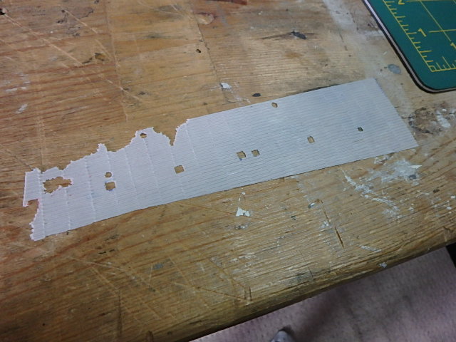

CUT HOLES FOR SKIRT BLOCKS & ADDED DAMAGE TO ZIMM
LIGHTLY SANDED BACK OF ATAK ZIMM SO GLUE WILL BITE
ADDED TACKY GLUE FOR MAIN BODY AND THIN SET SUPER GLUE ON EDGES
BAMM.....INSTALLED
BAMM.....INSTALLED
OTHER SIDE DONE AS WELL

Wow you do some excellent work! I'm also glad you're back. You're providing me with inspiration and teaching me already. After seeing your use of the Procreation Putty I did some research since I've never seen it before. Looks like a great product. Is it true that it takes alot of effort to knead/blend? And whats the working/setting time when creating those beautiful weld beads?
Keep it up.
Chef
Burger_Patrol1
Posts: 197
Joined: Sun Dec 25, 2016 7:21 pm
Location: Brea, CA. USA
Re: Operation Tamy T1 face lift
Post by Burger_Patrol1 »
Yes Sir Mr. Bix, Feels good to be back in town, & yes I have to get caught on all the new articles and posts other tankers have posted. good to hear from ya and look forward to catching up. :D
Howdy Mr Chef, Thank you for the kind words, much appreciated :thumbup: I find the Procreate is not to bad to knead together, I suppose its relative. I find adding a couple drops of water helps in the process & provides good workability. Regarding the work time, it depends on the ratio you mix part A & part B. If you mix 40% resin w/ 60% hardener you'd have 180 minutes work time. It also sets up hard in 24 hrs. 50/50 is 120 min, 60/40 is 90 min. I have tried other types of putty and this one I have found works the best for me. It is fairly easy to work with, it doesn't have solvents, so no smell, you can make fine details with it because of the smooth texture, & it doesn't shrink after its dried. I also found if you store it in a ziplock in a cool place it last a long time. I have a package that is at least 4 years old & I still use it. :D
Only funny thing is the name...LoL :haha:

Welcome back! I think the word for the part you cut into a kind of chisel is the "ferrule." Whether or not I have the right word, I can see lots of uses for the home-made tool. That's the kind of ingenuity that impresses me! I'll be watching to learn.
