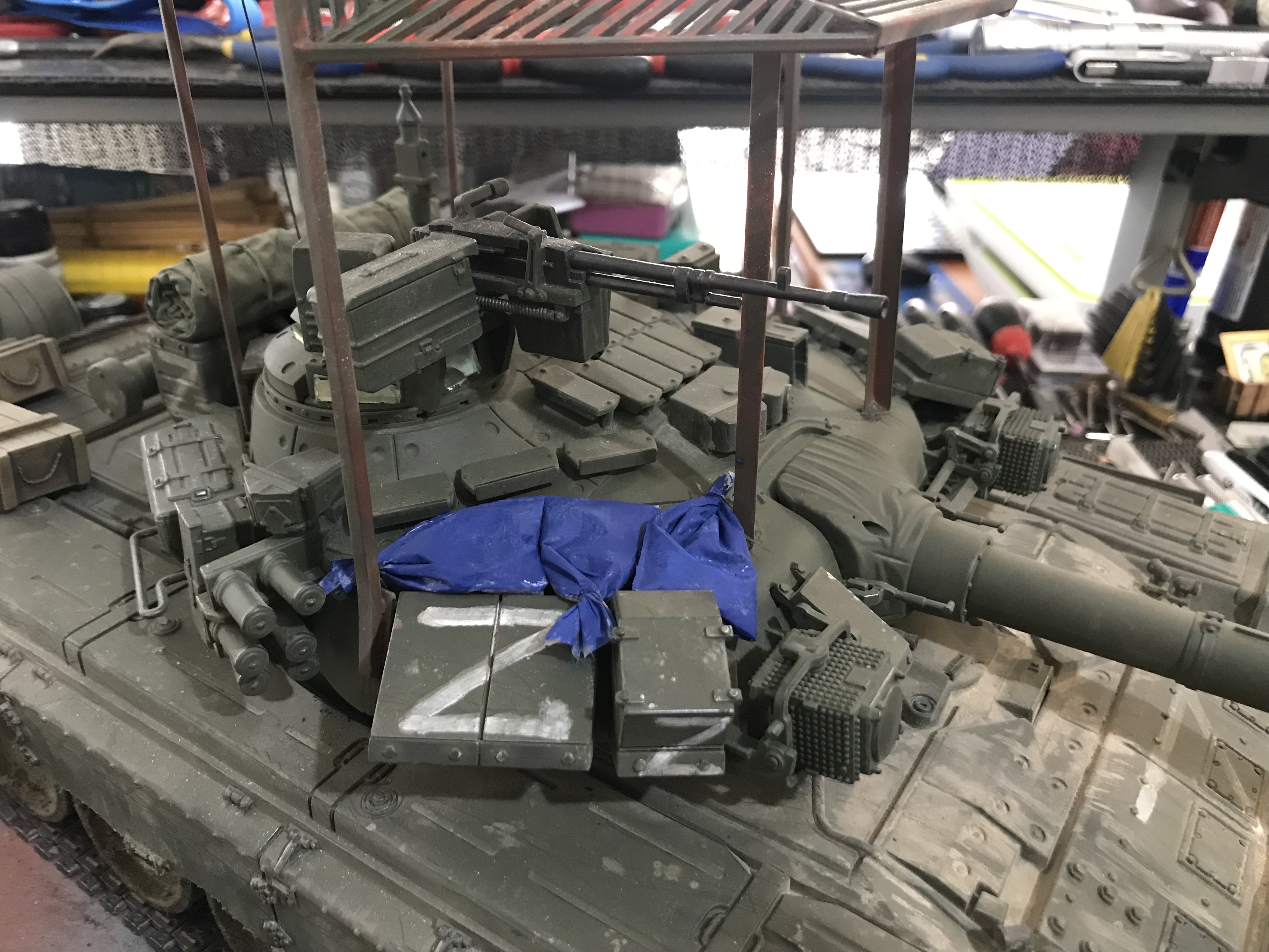

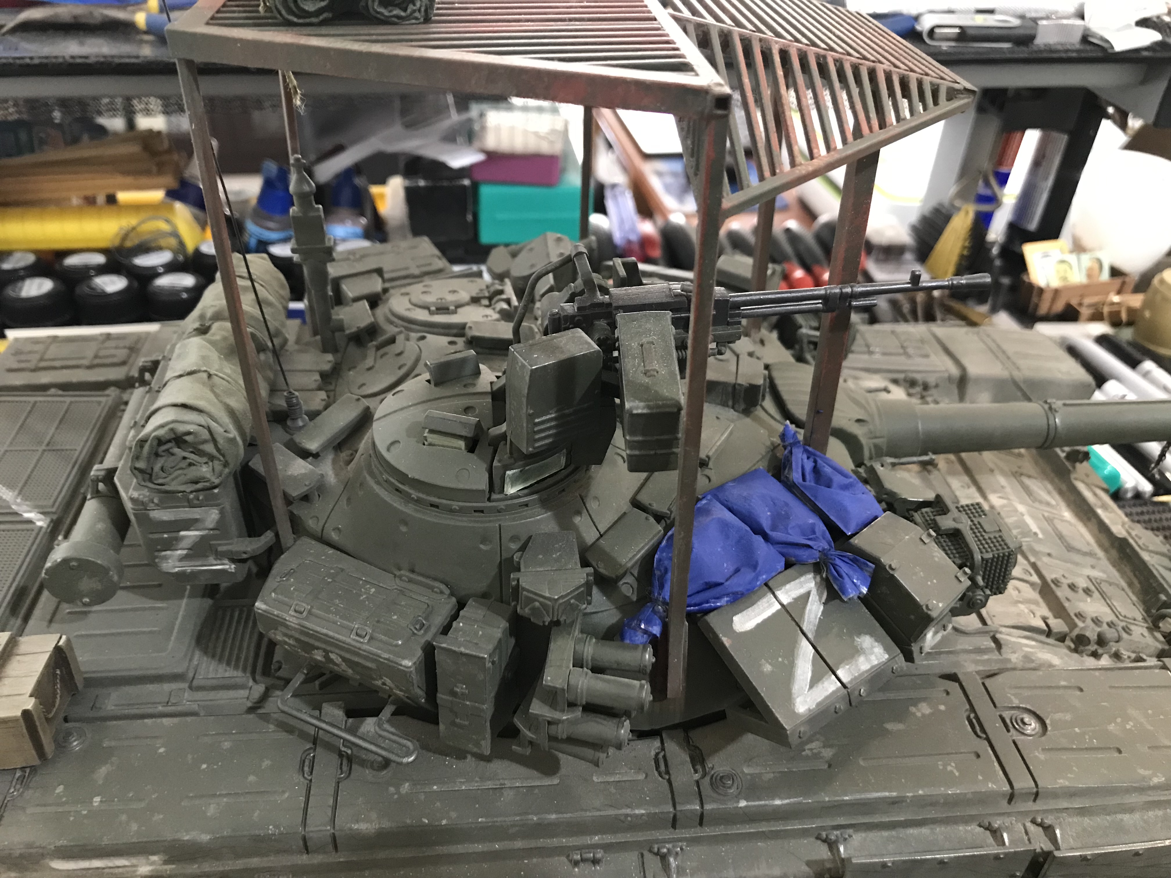

Been experimenting with the rubbish bags seen on a lot of Russian AFV's that seem to be filled with dirt to act as additional protection. some are white, some blue, some green, I've made blue ones, but can do them in any colour required.
used small zip lock bags, folded in half and painted on the inside with tamiya XF-8 Flat Blue.
A teaspoon -ish of actual sand, and tied off with green cotton.
I checked the scale with rubbish bags I have at home & they are virtually identical for size.
Plausible that domestic dwellings have them handy, and the crews take any opportunity to give themselves any advantage they can get, even if its futile.
I have another 3 in progress.
Once filled & tied off, i fold the bag in half and secure the halves with neat PVA glue.
Then using neat PVA, place the bag in position.
Once the plastic bottles & other goodies arrive from Mr Raminator, this thing should look pretty close to how a lived in and reluctantly crewed tank looks in so many you-tube clips common on the net now.
Ive still to lightly wash them & dust them in with the rest of the tank.
