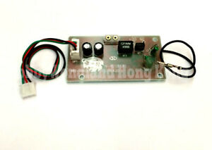

on the old HL cards you need two crystals with the same number, and respect the order RX on the receiver and TX on the transmitter, also check that the support does not have bad contacts, or bad welding?
attached photo of the RX part

indeed the numbers correspond to a defined frequency. 2 on TX transmitter and 2 on RX receiver otherwise will not work. it's the same for couples 1 or 3 do not mix. Also be careful not to drop a quartz, otherwise HS. Can also do the tests with a reception plate that works, also if nothing happens? do the same with the control board
PS: I insist on respecting 2TX transmitter and 2 RX receiver!!!
