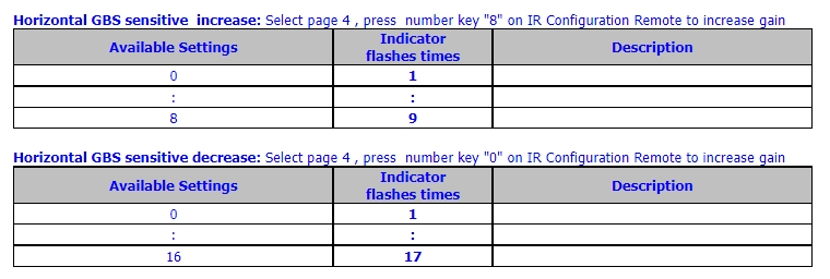

Why sensitive decrease 1-17 and sensitive increase 1-9 ?

NOT SOLVED
Down sensitivity dont solve the problem but only increase the time every 30 second instead of 5 second because the intervention angle (dead zone) increase
I think sensitivity and dead zone are the same thing
Magnetic target continue to turn slowly at the same speed 2°/5second
