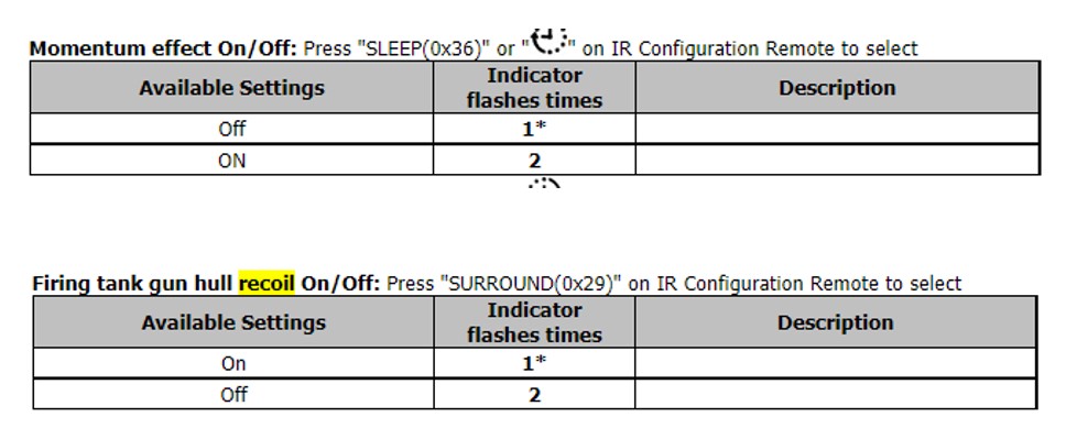

What you are calling "momentum" is not momentum. The momentum effect is when you are driving the tank forward or reverse letting off the throttle and the tank doesn't stop right away. It keep rolling due to "momentum". Momentum by default is off on the Clark TK-80. The gun firing recoil effect can be disabled using the Sony remote control and battle unit circuit.
Screenshot 2022-09-17 231755.jpg (66.34 KiB) Viewed 2019 times

Regarding Firing tank gun hull recoil, I would like to know if it work well in your tank or when the main gun fires, the chassis recoils back and if gun fires again chassis recoil forwards and so on?
