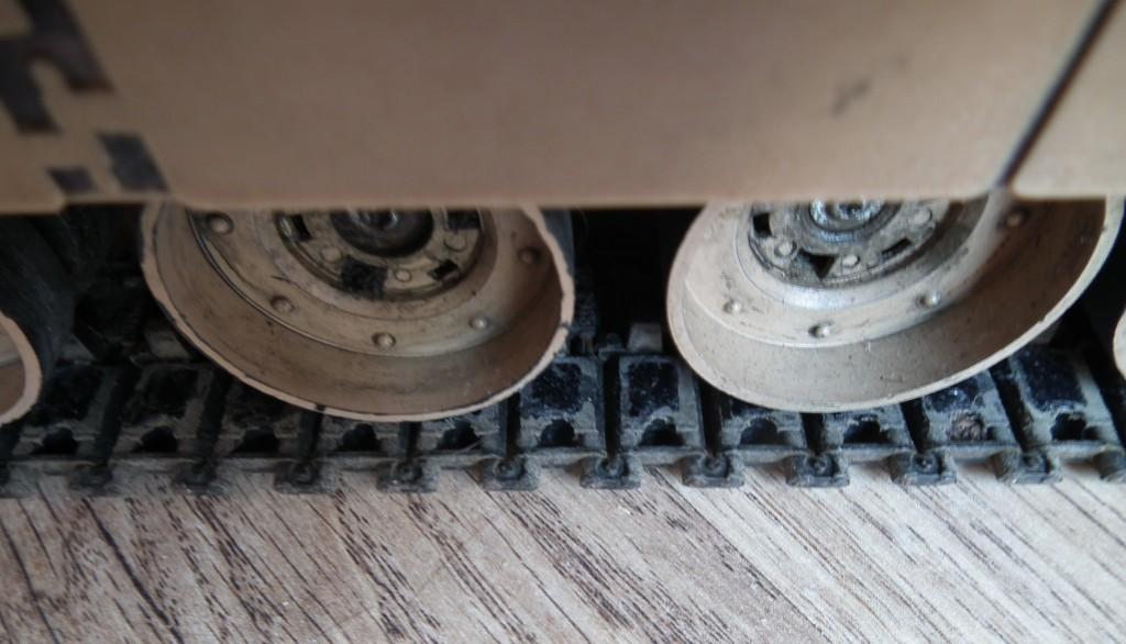

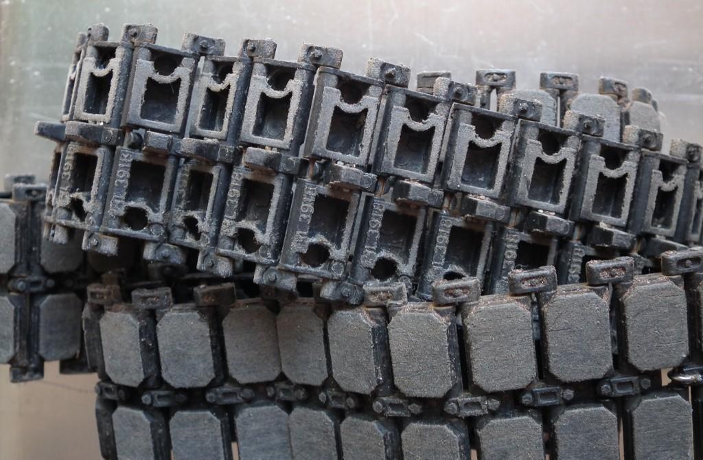

Below simple modification that I use on Abrams and Leopard tracks. For reasons unknown to me ( possibly due to material savers ), Heng Long decided that their tracks would always be empty inside :thumbdown:
Both the plastic versions ( for Abrams and Leopard ) and the metal version for Leopard have a similar empty space in each of the links ( btw, I don't understand why HL does not produce a metal version of the Abrams tracks - they only deceive customers by saying that the metal tracks for the Leopard are for the Abrams ...).
When it comes to these empty links it is so irritating that when my son rides off-road ( especially in mud, snow and on wet ground ) he always collects "tons" of dirt inside.

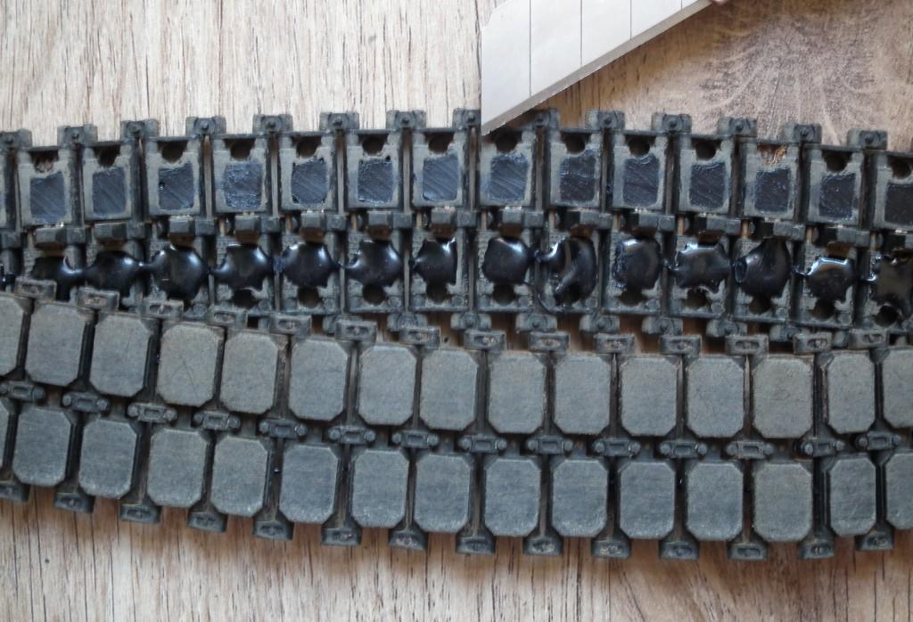

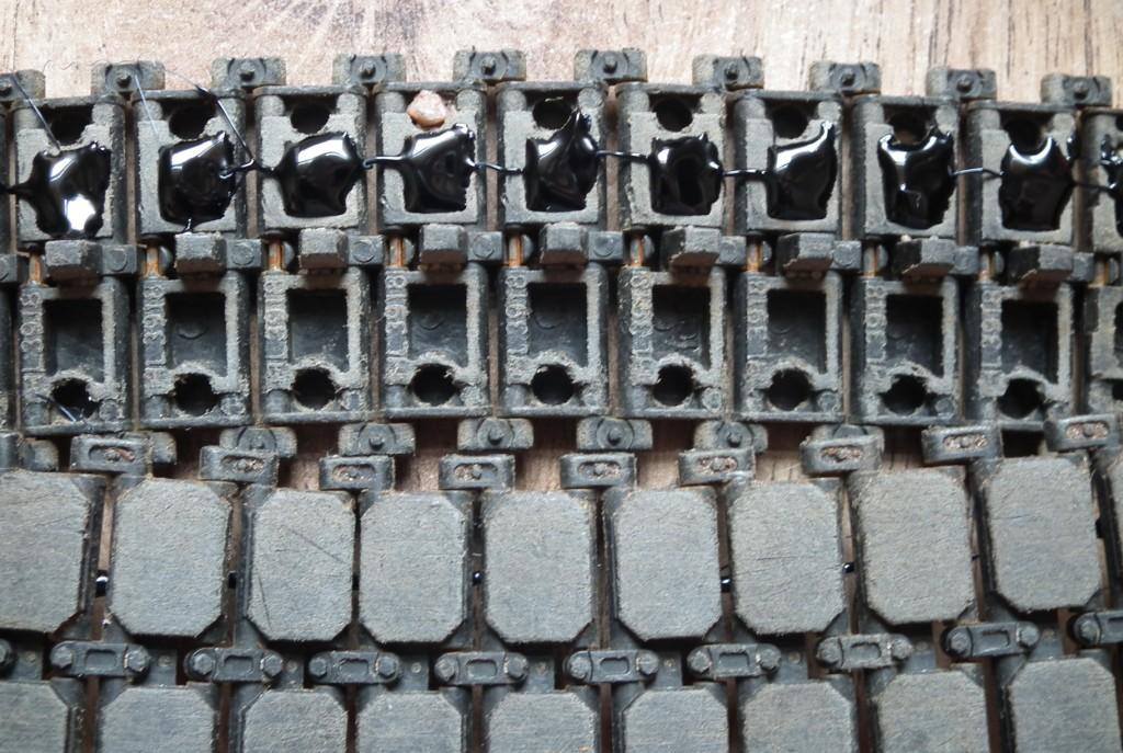

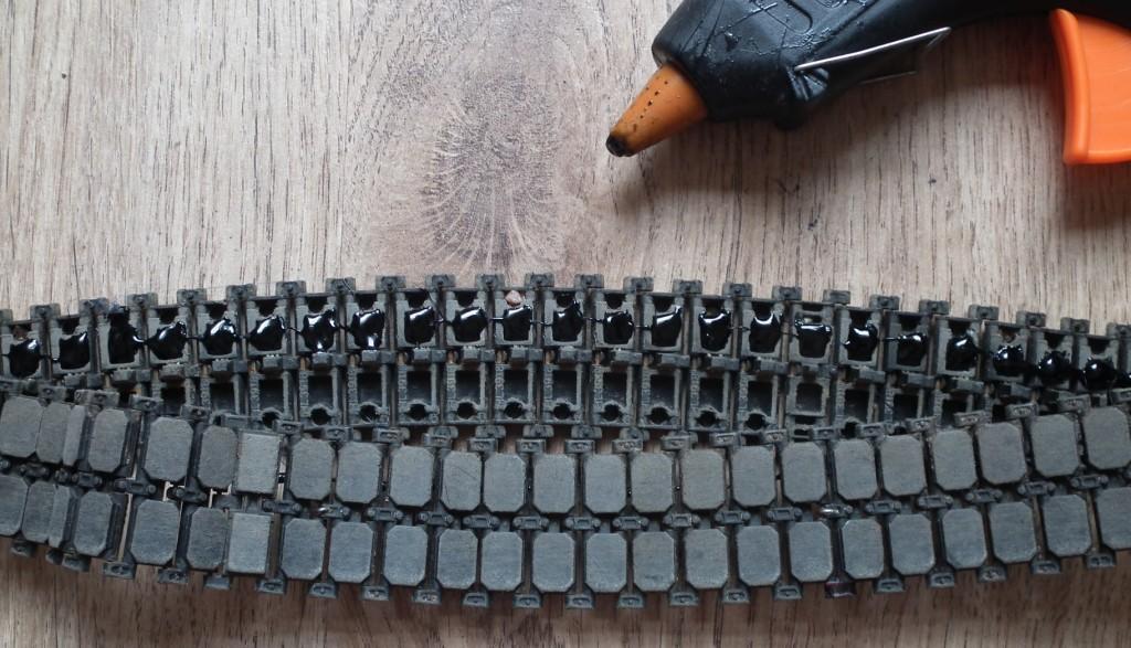

I used black hot glue to pour the links. In the Abrams, it looks a bit like rubber inserts, but that wasn't the main purpose.
Modification time - about 2-3 hours.
Caution. The glue is very hot - don't touch it right away!

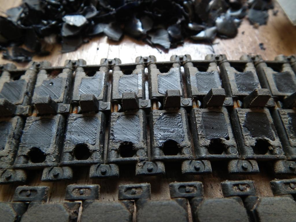

Caution 2. Hot glue should be pressed directly into empty links cells and then wait until it cools down completely. Cut off the excess with a wallpaper knife only after the glue has completely hardened (waiting 10-15 minutes is enough).

You're right. You can use some kind of glue (eg epoxy) to fill the empty chambers and "catch" the level, but hot glue is much more convenient. It solidifies in a few minutes and the excess can be trimmed. In addition, the black color of the hot glue perfectly imitates rubber and does not need to be colored additionally.
I have already done 3 sets of tracks and my son has not lost any pad.
Important note. Hot glue must be injected from the nozzle of the "gun" straight to the bottom of the chamber - then gradually extend the nozzle until it starts to overflow (we need to get an excess). Otherwise, after filling with glue - air bubbles / voids will appear ...
