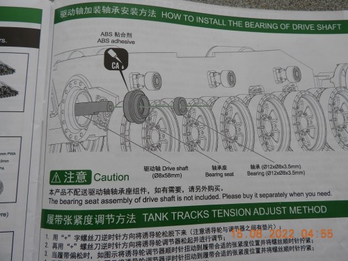

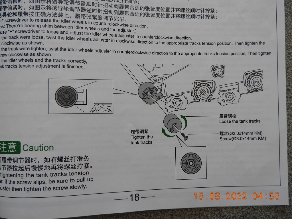

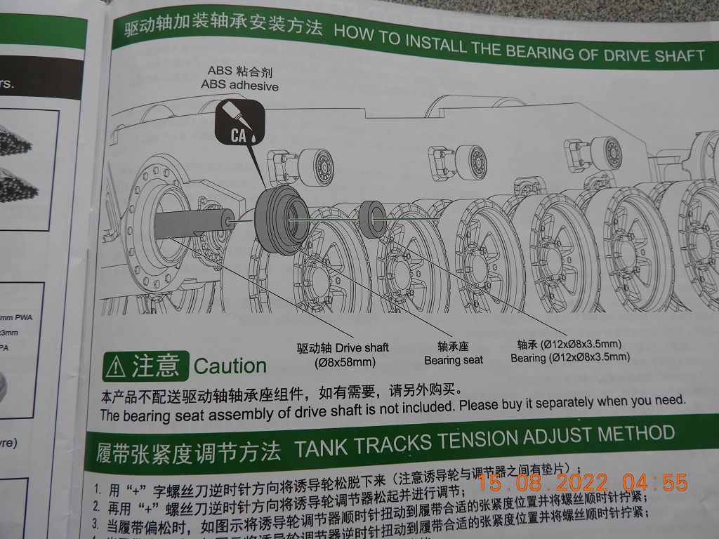

Is your tank a later 6.0 or 7.0? I ask because supposedly the idler bracket was strengthened in the later models.
Does your instruction booklet have these images towards the last couple pages?
