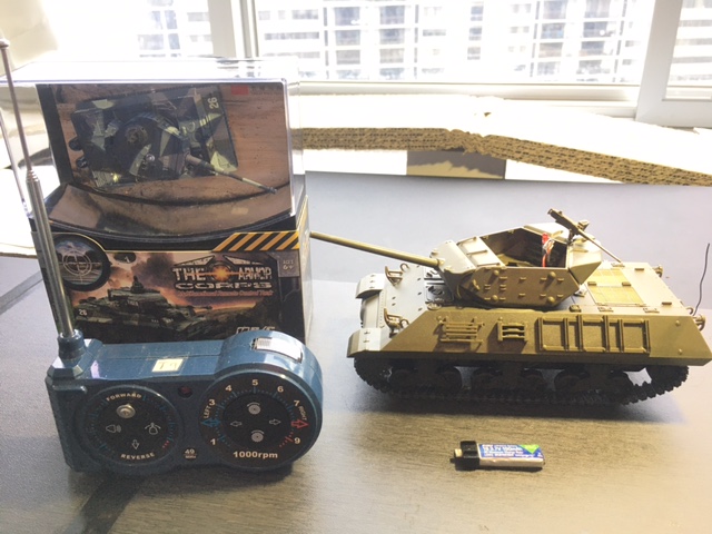

These 1/72 scale Radio control tanks are on ebay for ~ $20 U.S and are quite good for the money and if you can do a little work, make a great low cost radio system for your 1/35 scale AFV's. I added about 5 connectors (micro 1.5mm) so that it is PNP with my model tanks. I presently have this radio installed In a M10 as seen here.
It has a 2 wave engine\track sound, main gun firing sound with chassis recoil, Demo mode, Sound can be remotely turned on\off, has L\R tracking trim! This is a nice feature that is uncommon on any radio system. Has L\R turret control as well.

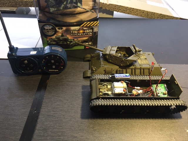

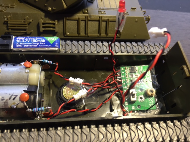

This is a very small radio system. Plenty of room in this chassis!

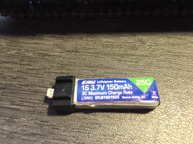

The M10 uses the 150 mah 1s lipo for power and can run for a good while on this small lipo.

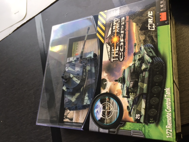

I have the one in this picture new in the box but have used another one for its radio gear in this M10
