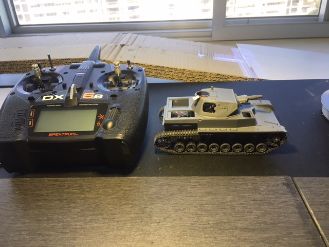

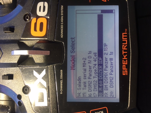

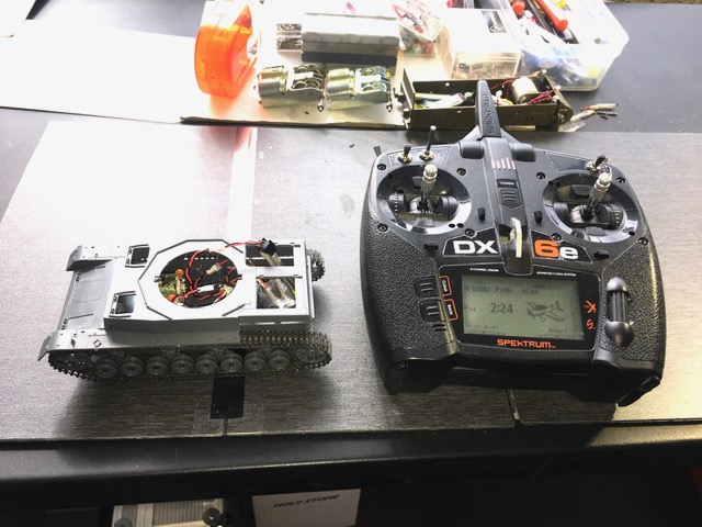

DX 6e Transmitter with 255 memories used to control this and many more radio control models.

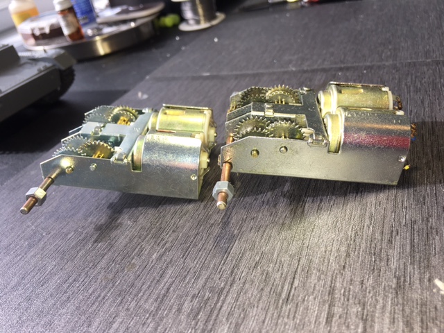

Low axle mount gearbox style. This Tank uses High mount axles.

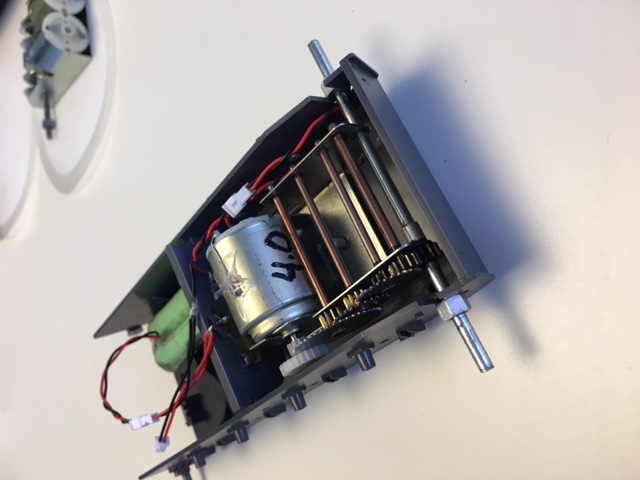

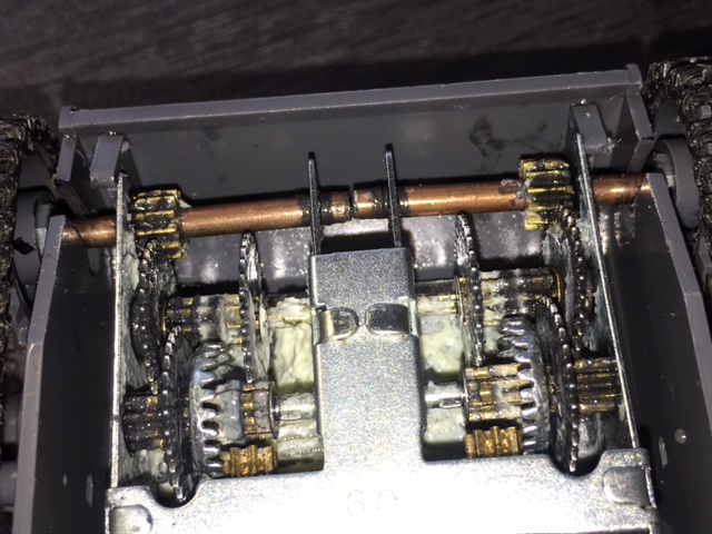

Well used gearbox that has been beefed up to last many hours over stock configuration. From a 1/35 Tamiya M60 A2 Tank.

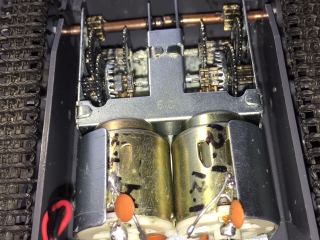

Twin motor metal gearbox with upgrade 8 tooth brass  pinion gears. twin 130 12 ohm (9V) motors. I keep them lubricated with 2 different oils. This gear box is due for maintenance of the front axles. I will talk about this in more detail later and may even show the procedure here ion this thread. You can see the numbers "60" stamped and indicates from a M60 Tank

Very nice model of the Panzer IV. These are available on ebay for < $35, somtimes with free shipping. I paid $27 for this one with free shipping. High Q SSDM 1/35 Tank model that is a prime candidate for conversion to (RRC) Radio Remote Control

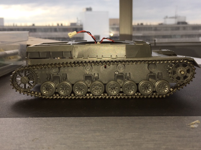

Undergoing testing on my proving grounds track. Once the track system is tuned and tweaked, the next step would be adding the turret, main gun and finally completing the model assembly and adding decals and other finish details.

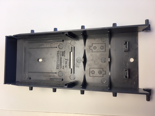

Moulded &quot;Motor plate&quot; Gearbox locator rail detail. 1975 build year
Moulded "Motor plate" Gearbox locator rail detail. 1975 build year

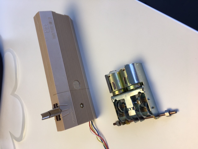

It took both of these kits to build the Dual motor Panzer IV of this thread. I have bought two the M60 Tanks just to get the gearbox for my Panzer IV collection to upgrade them to &quot;Remote Control System&quot; status.
It took both of these kits to build the Dual motor Panzer IV of this thread. I have bought two the M60 Tanks just to get the gearbox for my Panzer IV collection to upgrade them to "Remote Control System" status.
Here is the dual motor &quot;Remote Control System&quot; from 1975
Here is the dual motor "Remote Control System" from 1975

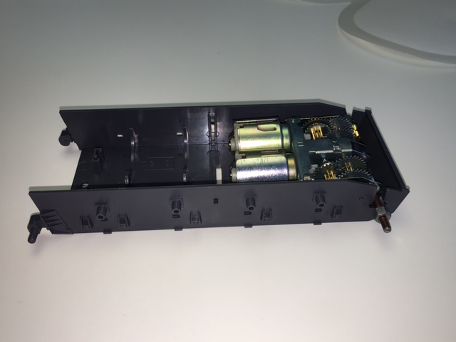

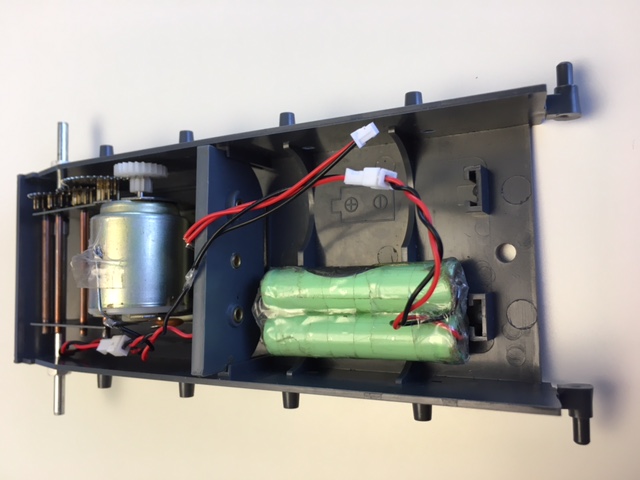

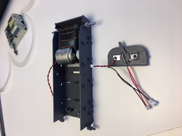

This chassis has the dual motor gear box and is ready for chassis completion.

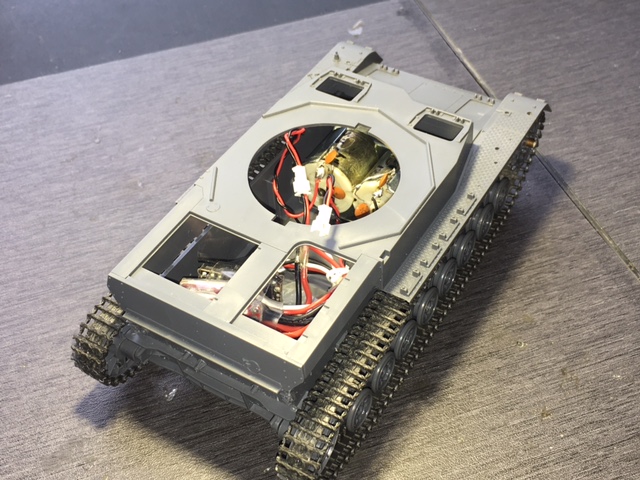

The Panzer IV chassis has been upgraded to &quot;motorized&quot; and is now ready for chassis to be completed with Sprockets, road wheels, tracks.
The Panzer IV chassis has been upgraded to "motorized" and is now ready for chassis to be completed with Sprockets, road wheels, tracks.

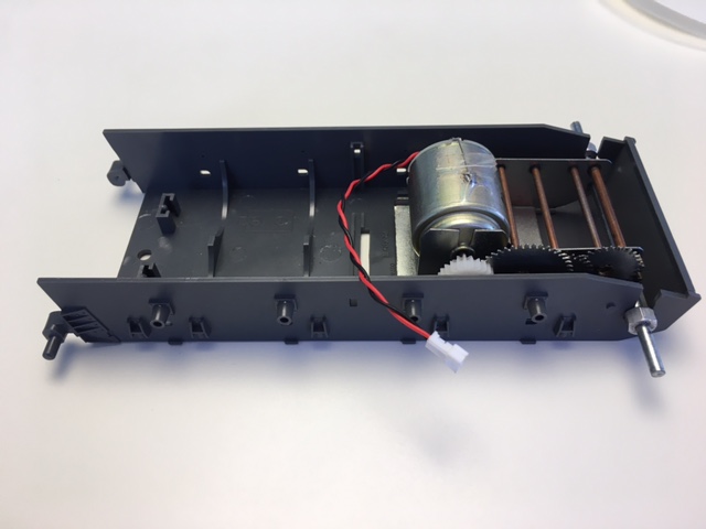

This Chassis can also be upgraded to &quot;motorized&quot; single motor.
This Chassis can also be upgraded to "motorized" single motor.

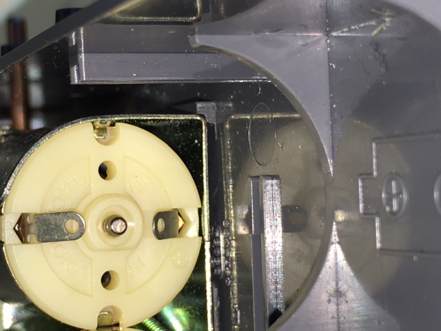

Here is the pan chassis of the Panzer IV with molded gearbox\motor plate or gearbox mount. The hole is for the GB mounting screw which is the GB mounting screw. There are 2 types of mounting rails, Outermost rails are for twin motor GB, the Inner rails are for single motor gearbox. So this chassis will accept a &quot;motorized&quot; single motor GB or a Remote Control dual motor GB. So this is a Type 2 chassis, ideal for Radio Remote Control conversion. The date made says 1975
Here is the pan chassis of the Panzer IV with molded gearbox\motor plate or gearbox mount. The hole is for the GB mounting screw which is the GB mounting screw. There are 2 types of mounting rails, Outermost rails are for twin motor GB, the Inner rails are for single motor gearbox. So this chassis will accept a "motorized" single motor GB or a Remote Control dual motor GB. So this is a Type 2 chassis, ideal for Radio Remote Control conversion. The date made says 1975
This is a Type 2 Static model that has a Motorized version and is ideal for radio remote control conversion. Does not indicate that it has a motorized version on the box.

This Panzer VI is a total success with regards to radio remote control upgrade.
Panzer VI Video.....
https://www.youtube.com/watch?v=I8dXSie64aU

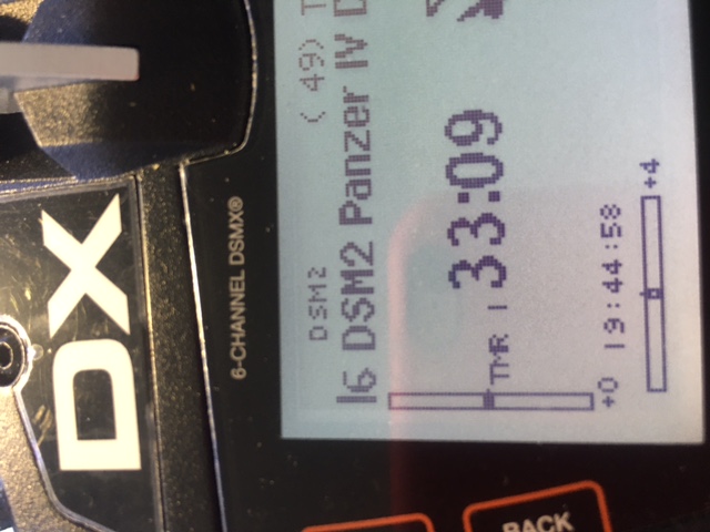

I was able to clock 33 minutes on the TX timer with a 1s 150mah 25c Lipo. It is very fuel efficient with this gear ratio and 12 ohm motors.

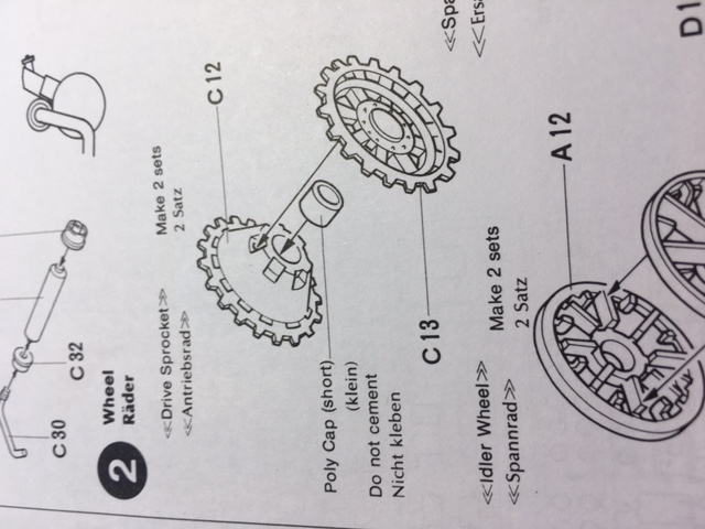

Track Sprockets are the same as a motorized kit &lt; gearbox and motors and is the reason I chose this kit to upgrade.
Track Sprockets are the same as a motorized kit < gearbox and motors and is the reason I chose this kit to upgrade.

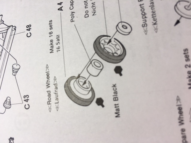

The road wheels in this kit are the same as a motorized version because it is the same kit less the gearbox and motors
This transmitter has 255 model memories available with a sim card that holds all the data. so it can be moved to another future Transmitter
They run best with a HG Computer radio and is another reason it can run so long due to the mixes and precise track speed options. This is the same thing they do on electric cars, limited the battery output for efficient operation.
Impressive run time from such a small lipo

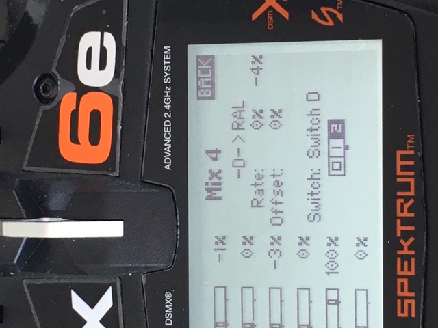

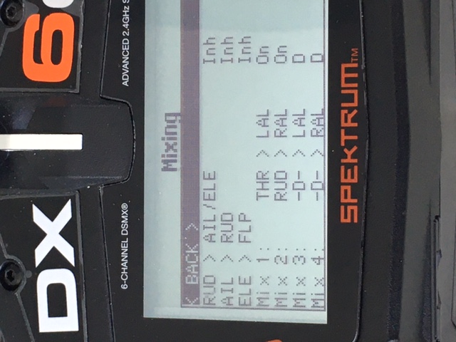

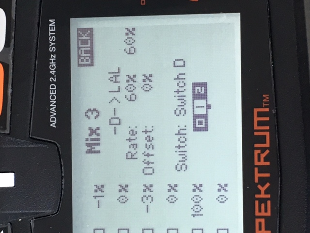

This mix gives me toggle switch throttle F\R with center off. (D =SPDT)  with variable speed set from 1-99 in both directions.
7 mixes available but only 4 are fully programmable. You can see here that I use L\R Aileron mixing for L\R Track control with Throttle channel being used to control L\R Aileron mix.  This is a strait-forward but advanced motor control mix and requires Computer mix Transmitter.
