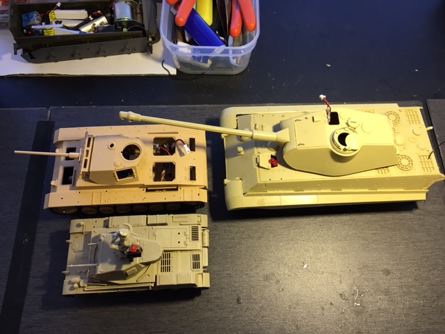

Tiger II, Panzer II, Panzer III

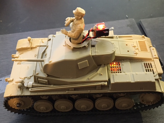

on\off switch is visible here.

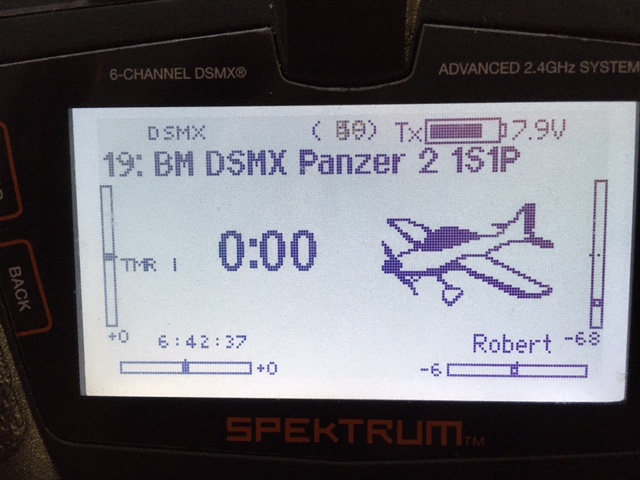

Its a bird, a plane...no its a Tank but no icon for a Tank in this TX. DSMX protocol.
Computer TX provides the mixing and model memory in the DSM 255 memory TX.

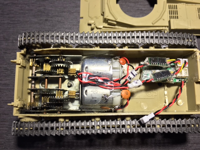

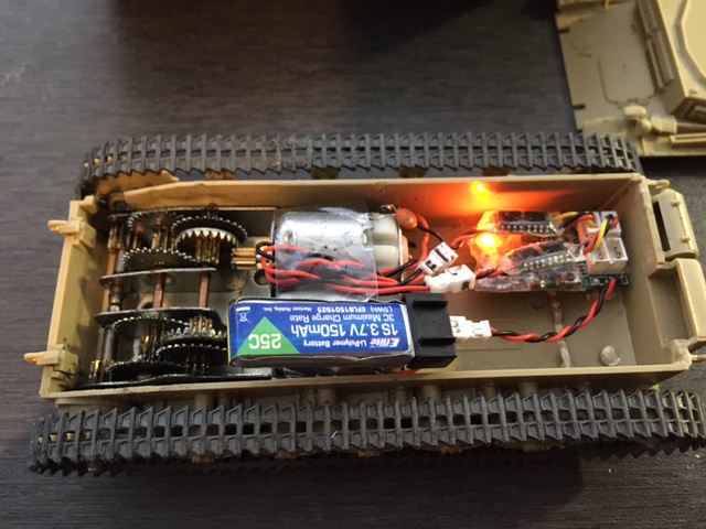

with this UM gear, there is still room for a battery in this very small chassis

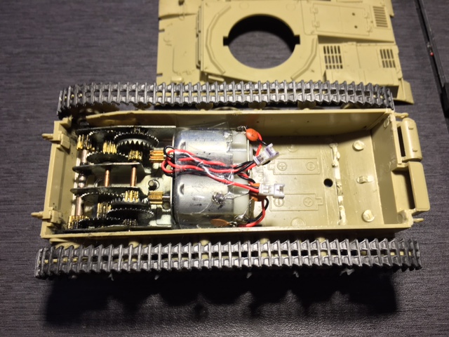

Tamiya narrow metal twin motor gearbox. Nothing beats these things. easy to swap motors too and fits the motorized version track sprockets. You can tell this chassis has a motorized version available because of the battery symbols inside the chassis.

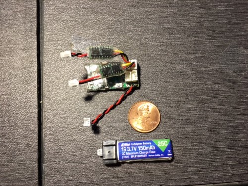

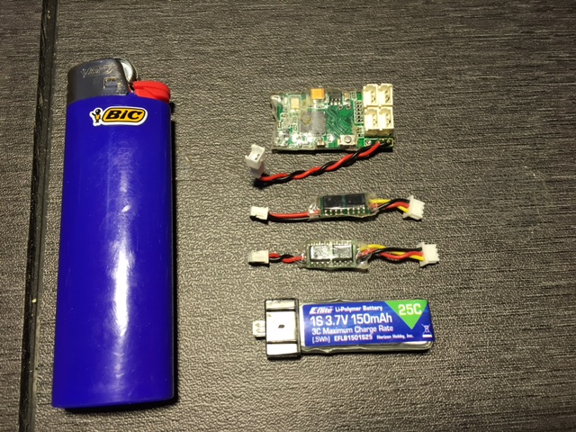

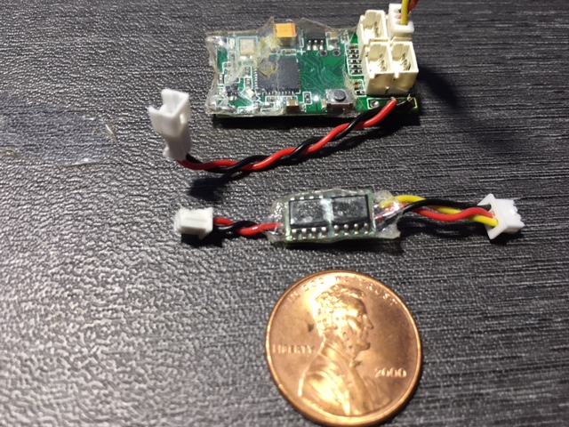

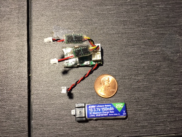

4 elements in this setup.
Das Mikro 1s 5amp ESC with LVC.
DSMX 5 channel rx with two ESC's all designed to run on 1s cell. ESC's have built in LVC.
