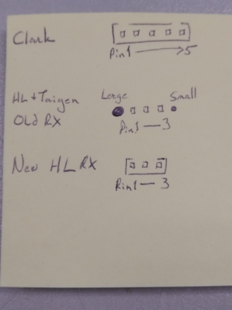

OK. So I assume you are using the Clark board configuring kit (such as the one here: https://dakrctank.com/shop/ir-configuration-line/) which has a pre-built 5 pin JST-XH connection with an LED and a IR receiver built into it.
The fact that it works for programming proves that the Clark board is working and can take a hit. So my guess is a wiring issue between the 5 pin connector to the clark board up to the IR receiver connection.
OK.. I added an image.
Clark board Pin Layout:
Pin 1- IR Receiver +ve
Pin 2- IR Receiver Signal
Pin 3- IR Receiver -ve
Pin 4- Indicator LED -ve
Pin 5- Indicator LED +ve
Original HL & Taigen Apple Layout
Large Post
Pin 1- IR Receiver -ve
Pin 2- IR Receiver +ve
Pin 3- IR Receiver Signal
Small Post
Current HL Apple layout (Magnetic)
Pin 2- IR Receiver -ve
Hand written layout
Hand written layout

Here is an image right from Clark's website regarding how to wire a HL/Taigen Apple
CN2 from left to right as shown. (Pin 1 - 5)
RX +ve, RX Sig, RX -ve, LED -ve, LED +ve
Follow the colours for proper wire location (colours do not represent polarity/function).
HL apple to Clark connection.

Jarlath wrote:Here is an image right from Clark's website regarding how to wire a HL/Taigen Apple
Thank you for this info Jarlath! Now it makes sense.
Here is how i had it wired.
From CN2 V+, Sig, V-, LED-, LED+
to IR end V+, V-, Sig, LED-, LED+
I see in your diagram the + and - are reversed from what i have, i will try this tonight and update my findings here.
The Sherman came with that magnetic black "apple".
Thank you everyone for your help!
