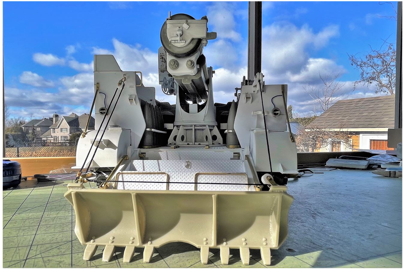

And one last view for Herman who seems to like the Canadian landscape in winter.
1/16 RC US 155mm Gun Motor Carriage M12 - Build

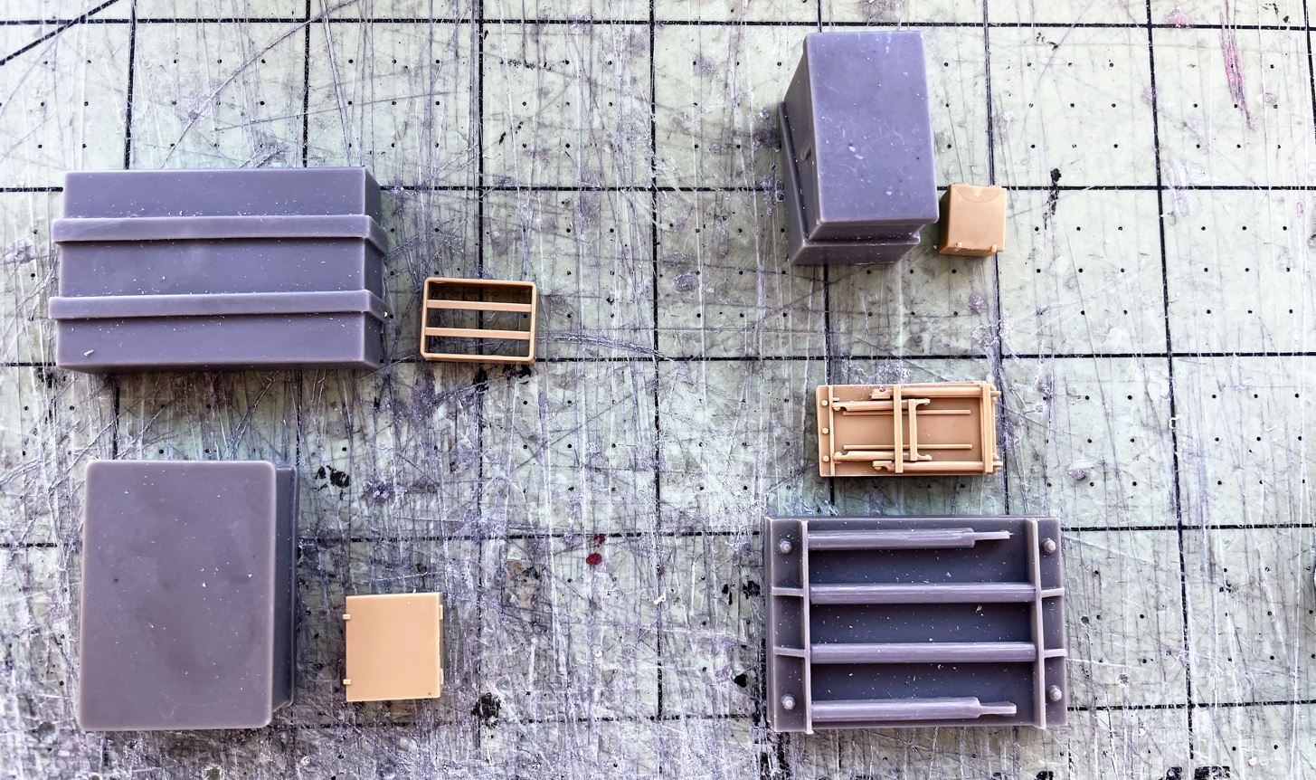

Seen below are the Vandra provided boxes and tools, compared to their Academy 1/35 equivalents. There are major differences between all components and they all have issues.
Starting with the box for the grousers on the left side.
I used the Academy box for size and shapes extrapolation to 1/16. Sadly, I noticed later on that i should not have done that without checking against references. The box ended up to be on the short side by a few mm. Not dramatic, I decided to live with it. I also did not repro the grousers as this box in wartime reference pictures seems to have been mostly used for general storage instead.

The two boxes on the left fender also gave me issues. Reference pictures also show variations of these in terms of details and orientation.
I decided to reuse the small Vandra box, although i had to shorter it dramatically as it was way too high. The larger one should be more square and needed to be completely redone.

These bizarre things seen deployed under both tracks at the front are called "Collapsible chocks" and used to stabilize the tank prior to firing.
These are stored on right front fender as shown here on the Aberdeen M12 prior to its restoration. They seem complicated at first but after some analysis of pictures and study of the 1/35 kit, they are simpler than they look.
continuing on following post.
