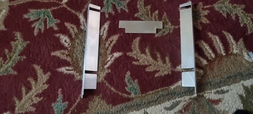

Using some 40mm x 20mm x 1.5 mm alloy angle I knocked up some reinforcement.
Using some impressive Gorilla Clear Glue I stuck it all together.

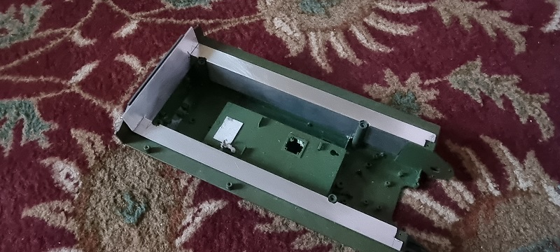

Finally I decided to get rid of the faff of having to turn the tank over to turn it on and off I cut out he battery box and floored the base with some alloy strip I had. This made the hull very rigid.

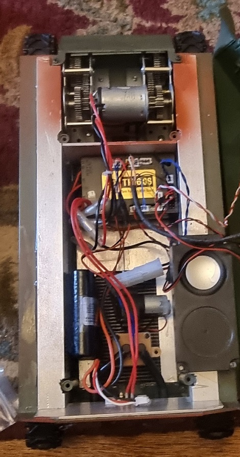

Final picture of the completed lower hull, wiring to be tidied later. The tank was remarkably quieter than when new, I suspect that the reinforcement and the out rigger bearings for the gearbox otpt shaft have jointly contributed to this.

Latest view, some tidying up to do.
