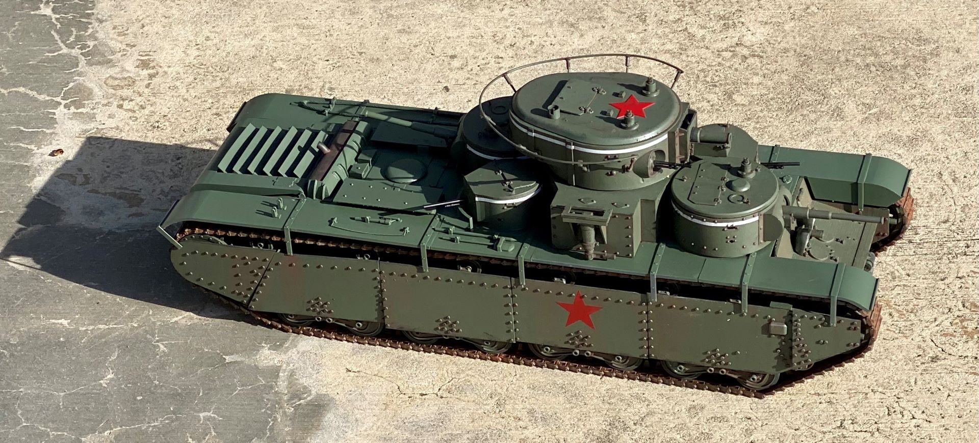

All the parts are on, all the mechanics work. Next step is painting, weathering and detailing.
