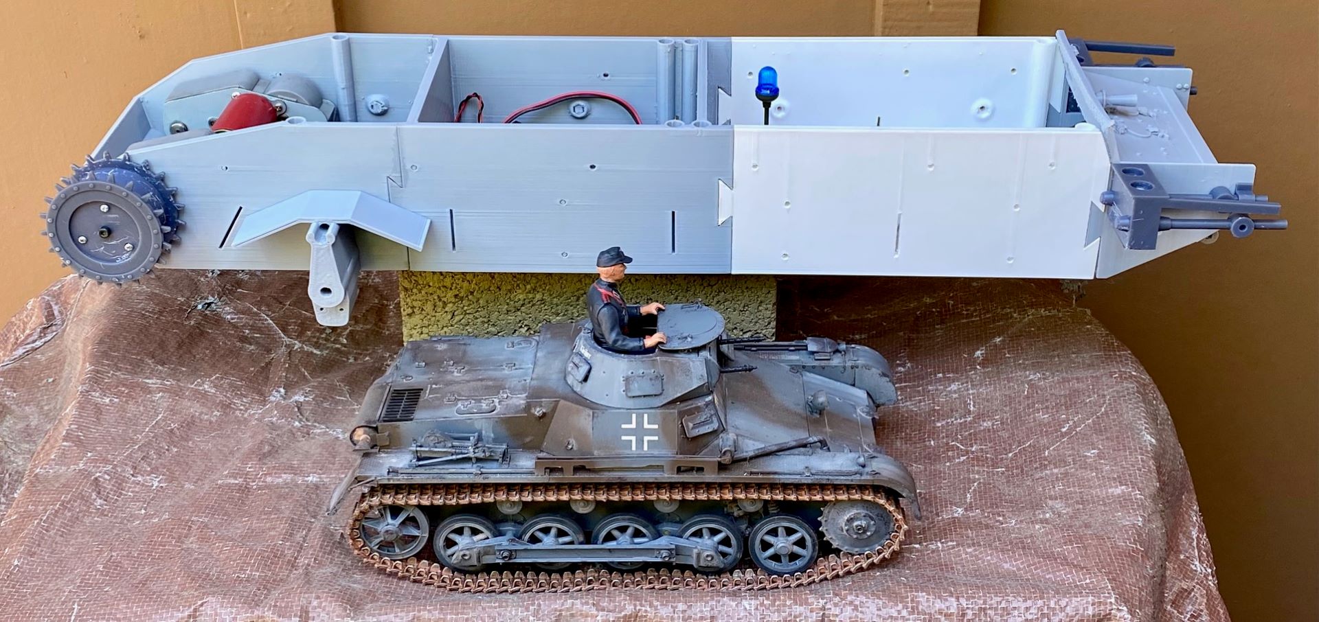

Our first concern was whether we could even get the tank to move, so we worked on the hull, suspension and tracks.
Here are the four pieces of the hull, one upper suspension part, and the motor/gearbox/sprocket assembly. I placed a Panzer 1B in front of it for perspective. I'm using a Heng Long power setup with upgraded motors. (The little blue beacon was to let me know power was on, since there was no sound at that time.)

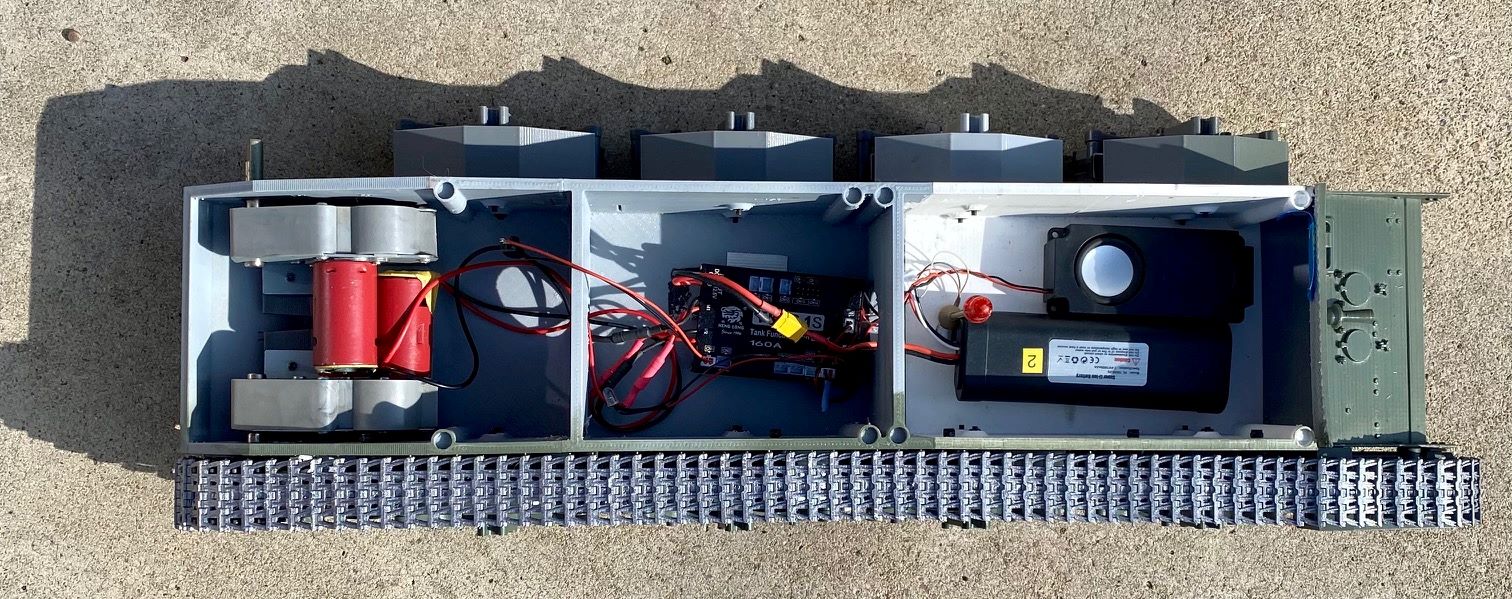

Here's a view of the interior at this point:
One goal of this project was to see if I could use Heng Long components for power and control. 6.1S board, HL speaker and 2S Li Ion battery. Later I upgraded the battery to a 2S 7000mah Li Ion. I figured there would be less voltage sag under load with the higher amp/hours. Plus, some of the HL 1800's would only give me a few minutes of running with this beast!
With this done, I could run the tracks on the wheels. Good so far.

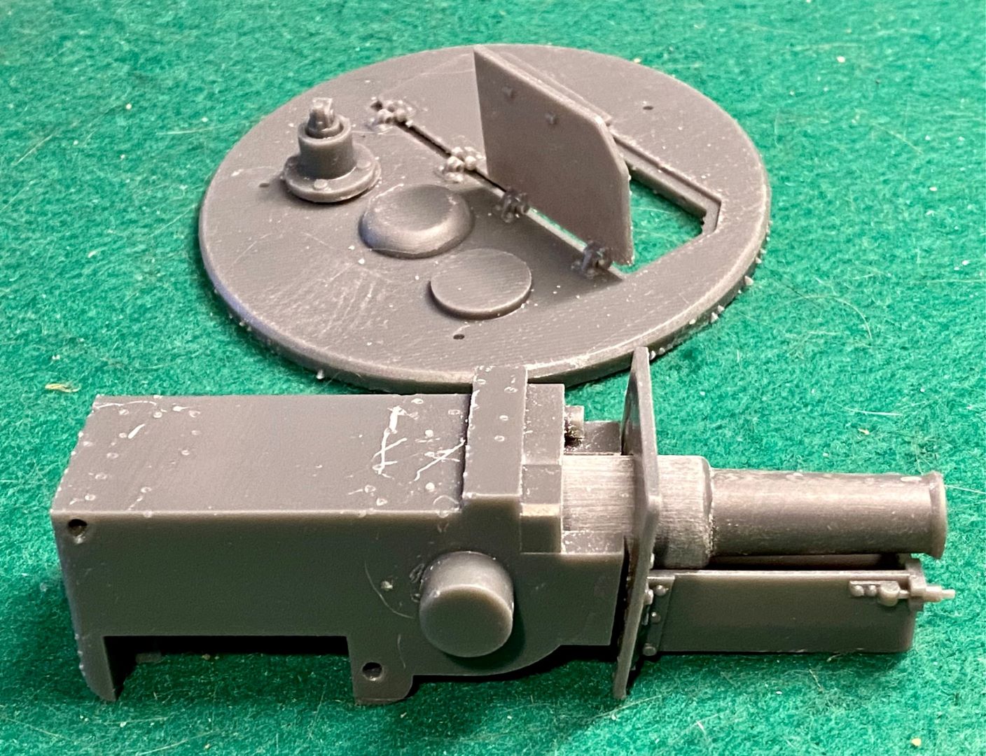

So now it was time to put together the tanks structure itself. I don't know printing, but I'm told a new nozzle had to be installed on the printer to enable a higher resolution print. Resin was used for the topside components, to reduce rough textures.
First up was the main cannon parts. Turns out they were made with a recoil capability along with elevation. One thing with resin is that there is a lot of sanding and filing needed to make parts functional.
