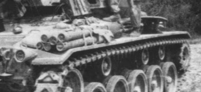

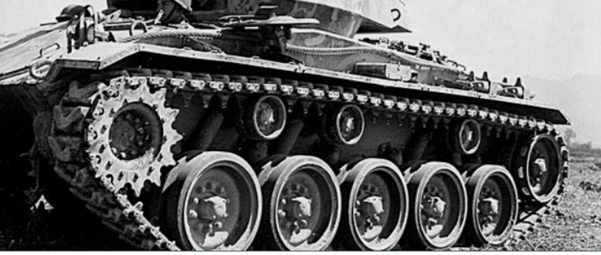

After studying all the pictures of the Conti tank at Dien Bien Phu, i selected the fender configuration without the extensions on the sides, front and back, and without side skirts. On the left side, we can notice spare tracks at the back and a tow cable alongside the fender that i will have to put on at the right time.

On the right fender are extra ammo rounds stored at the back, followed probably by a Jerrycan, then tools in the middle stored on the side armor, and the opened hatch at the front giving that dark item.

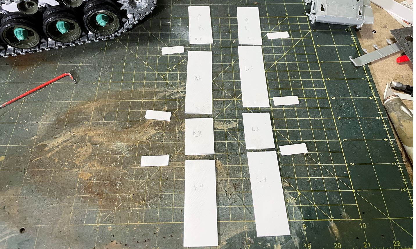

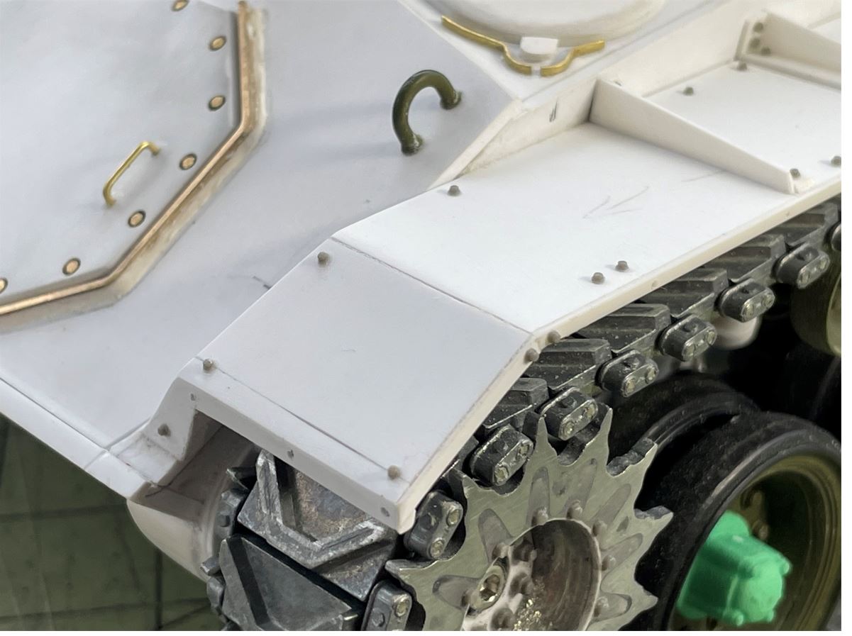

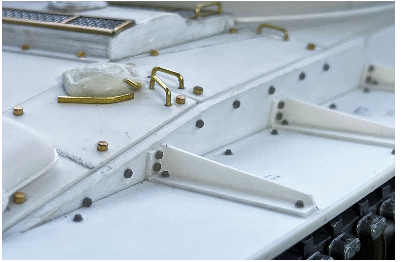

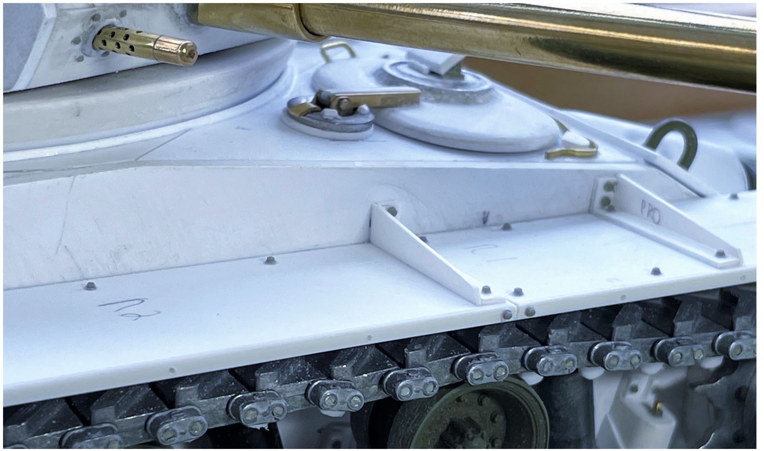

The fenders are made in thinner 0.75mm plasticard, in 4 sections for more realism.
RC 1/16 M-24 Chaffee light tank- Dien Bien Phu 1954 - Build

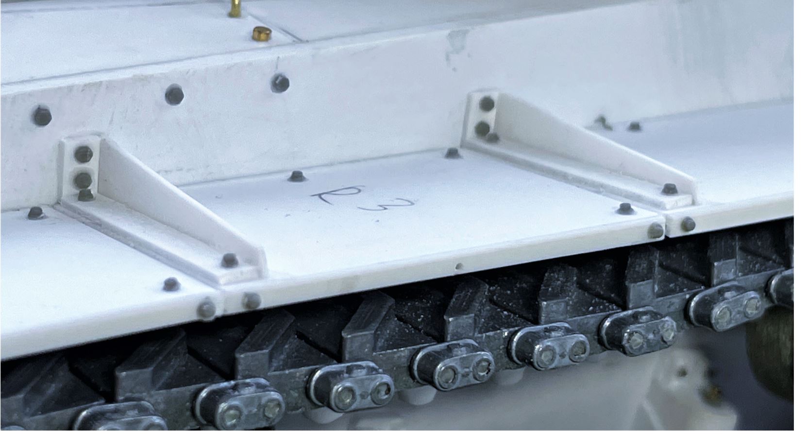

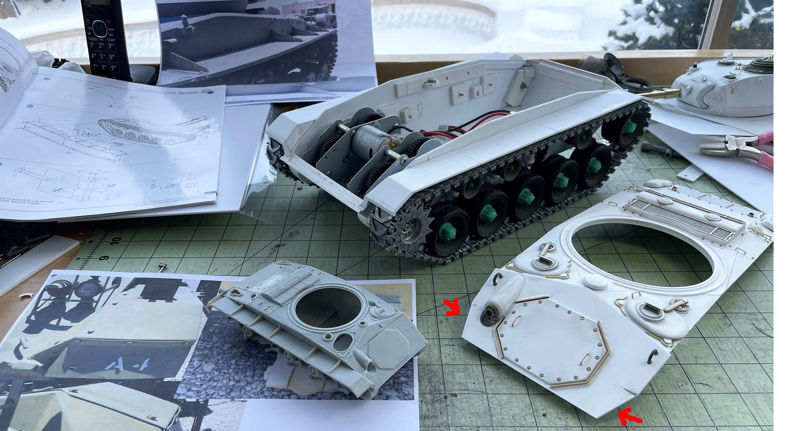

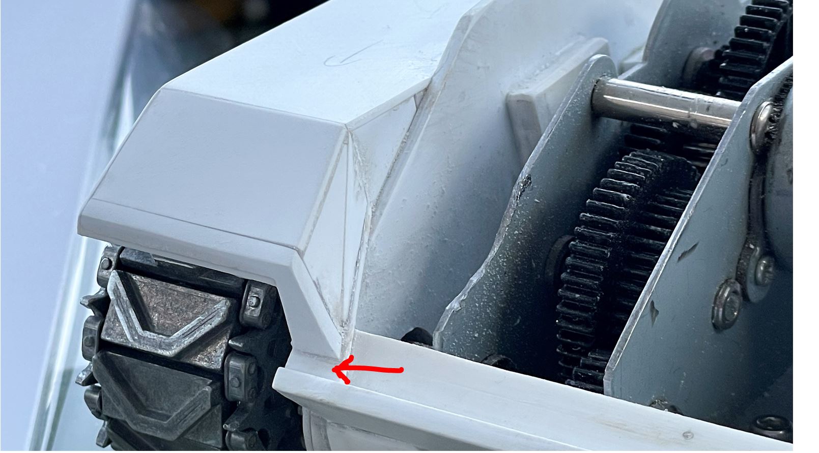

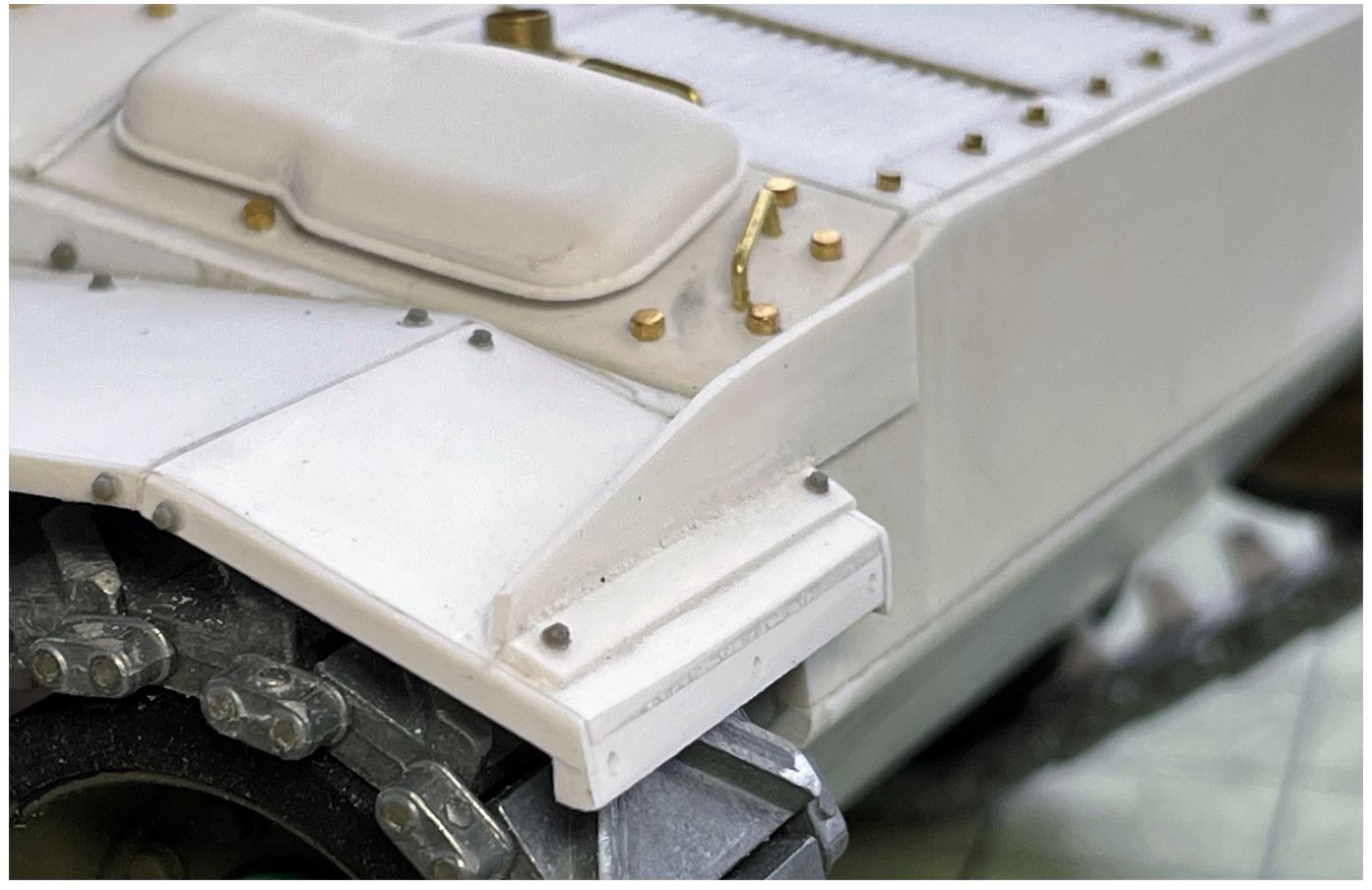

The Chaffee front fenders have a reinforced bracket that is also useful for the RC vehicle. A bit of a struggle here to get all the angles right, but no issue. The bracket was given a solid base underneath and glued to the chassis for solidity, that section was taken from the removable sliding glacis.
The front sides of the removable top were adapted, and is now going around the bracket at the front.

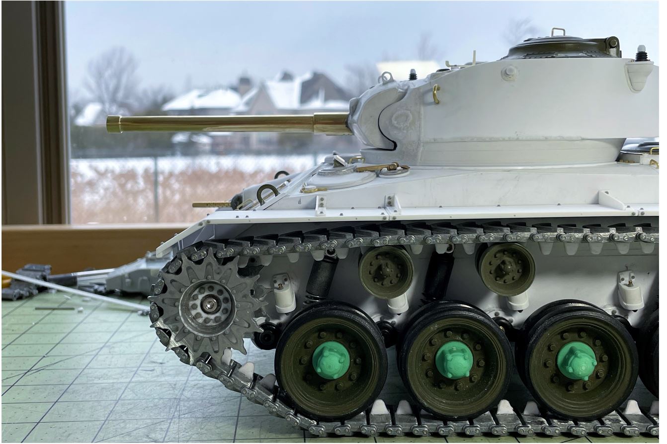

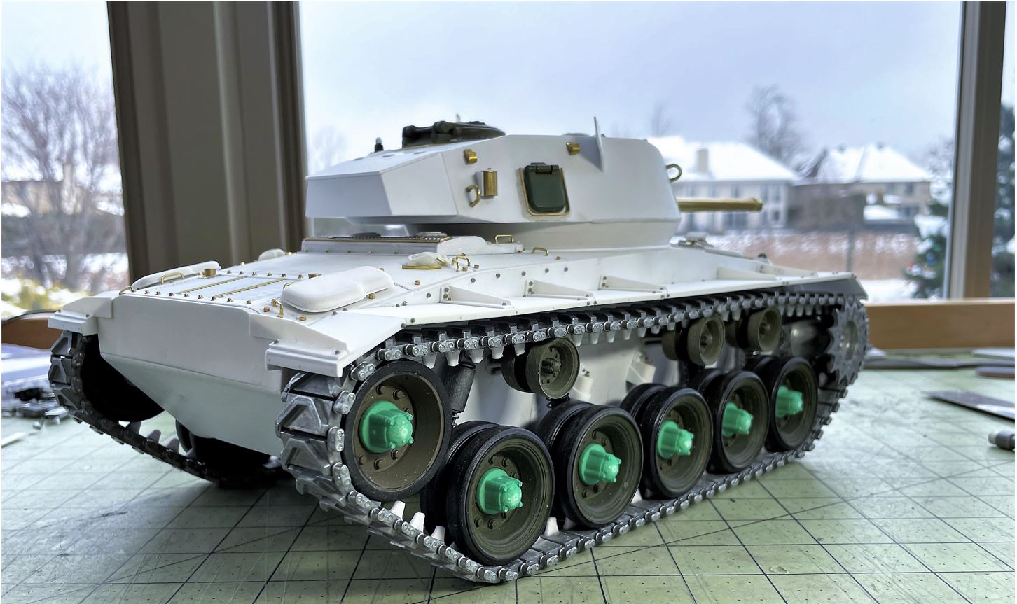

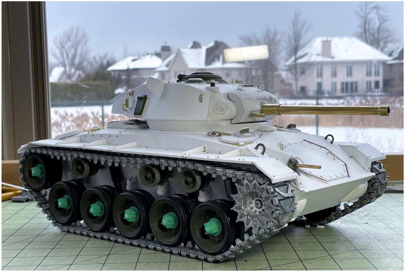

The body of the fenders are installed on the chassis, with the brackets and bolts. It's looking good.

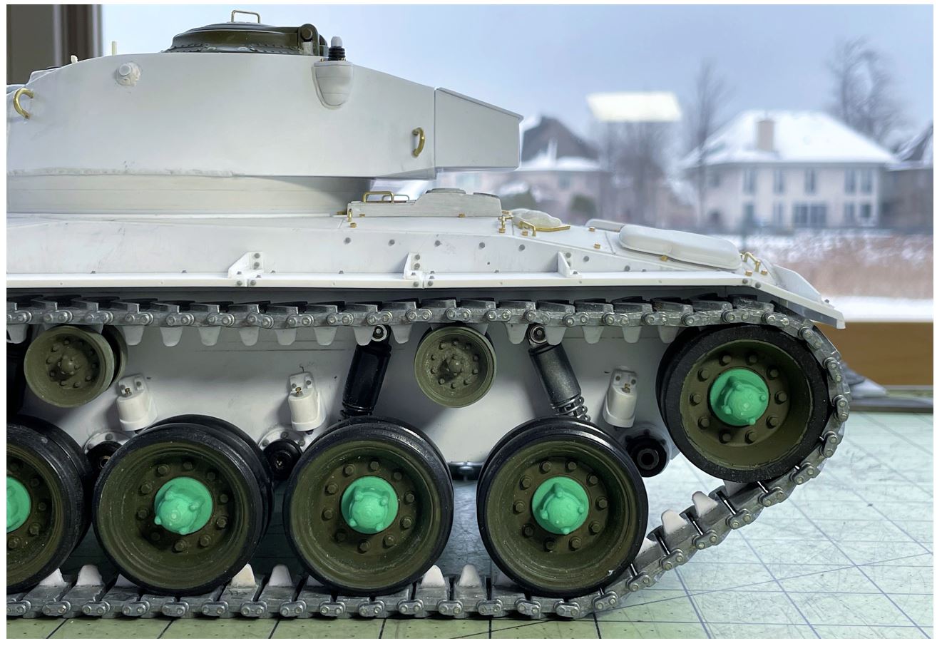

The height of the suspension, the space between the roadwheels and return rollers, the space between the top of the tracks and the fenders, and between the fenders and the top of the hull are calculations that gave me worries throughout the build. Some compromises were required. Chaffee experts will surely notice a few things that are off by a couple of mm, but its very close, as close as i could get them.

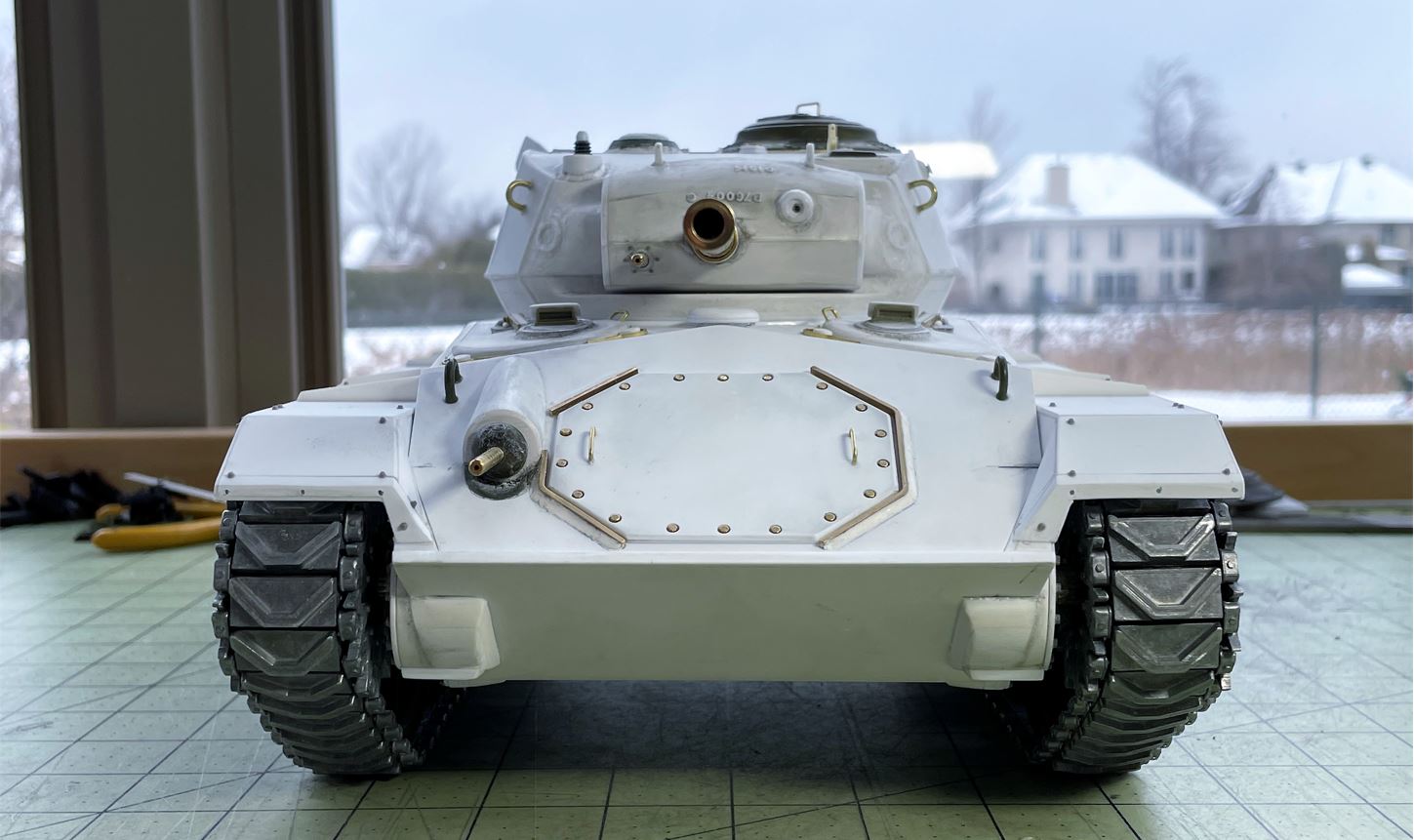

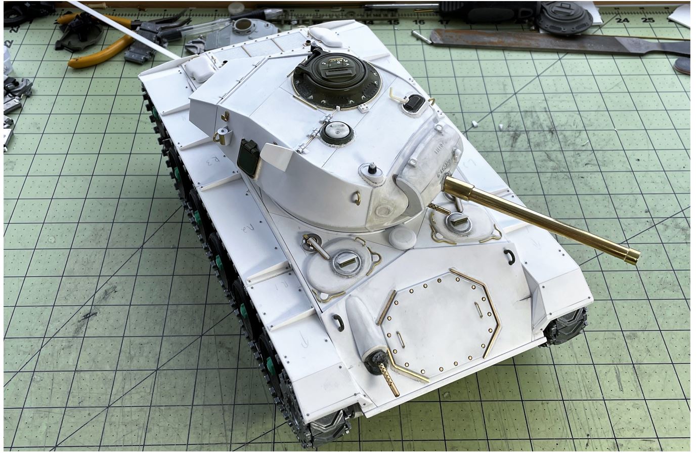

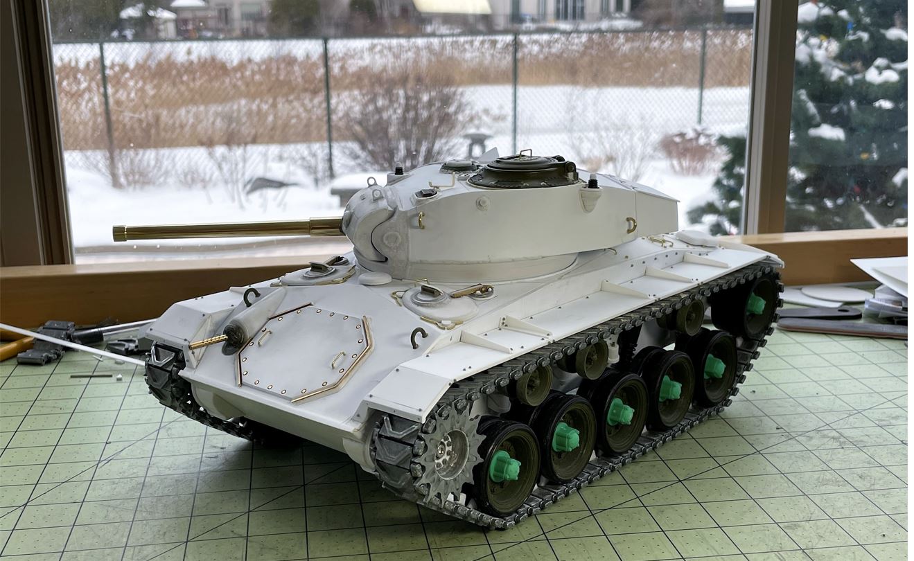

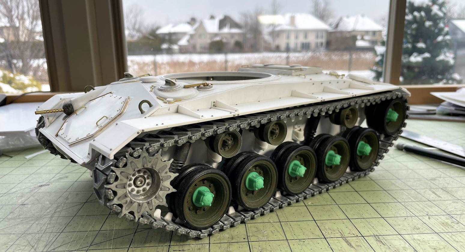

The model as it stands today with the turret put on the chassis. It is really starting to look like an M24 Chaffee on the final assembly line, a rare sight in 1/16 scale, and a unique model itself by the selection of components used.

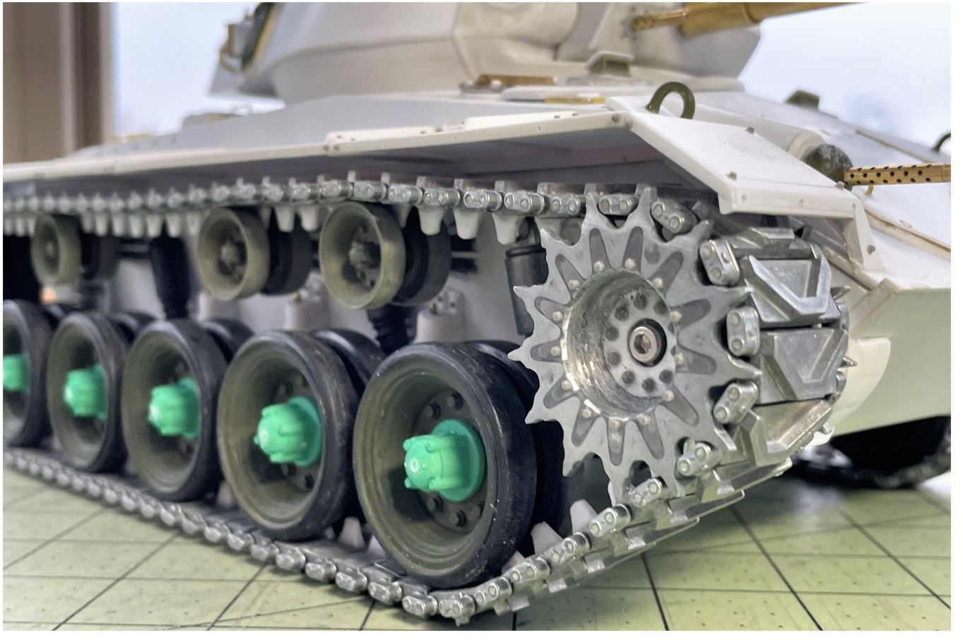

Some close up pictures on the fenders.

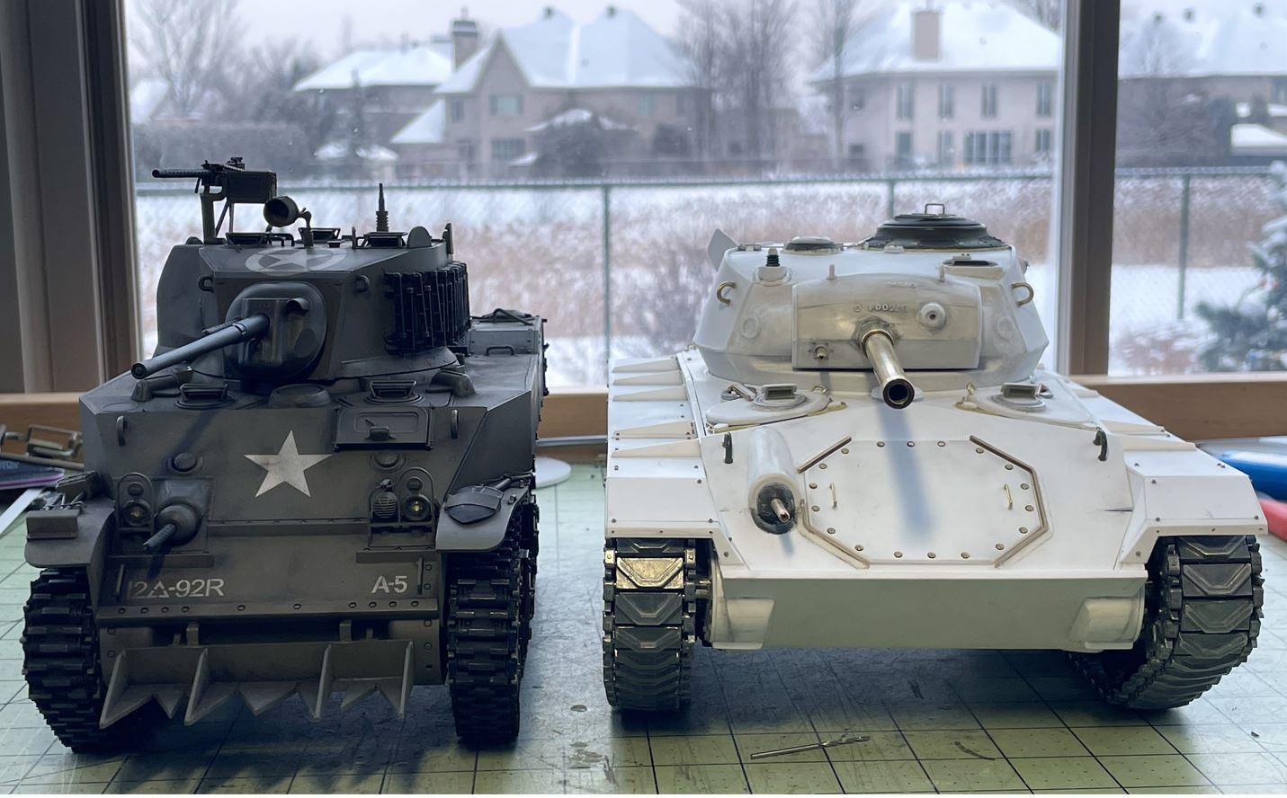

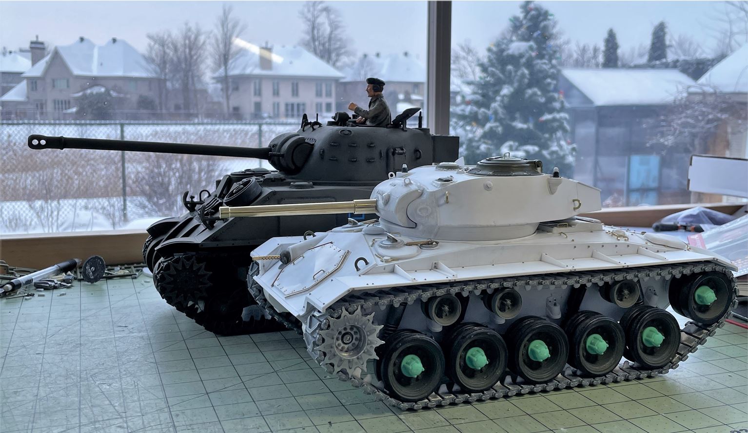

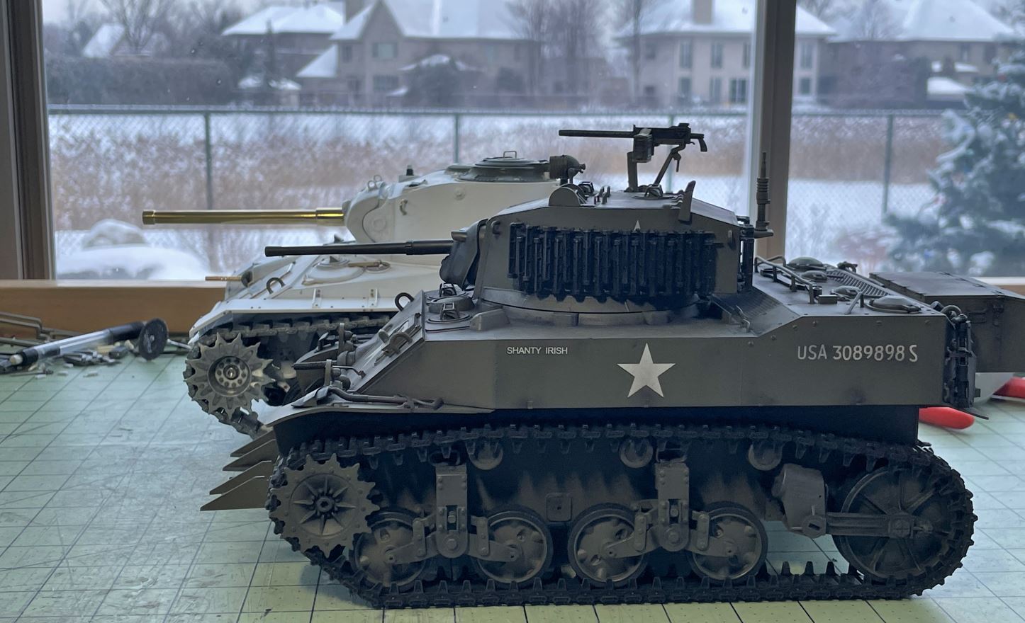

The Chaffee is a light tank, not a medium one. In term of size, its right between a Sherman and a Stuart. It was a perfect vehicle for Vietnam, with low ground pressure. Yeah, we're in the middle of Canadian winter. Weather has been nice so far in Quebec province. Not too much snow.

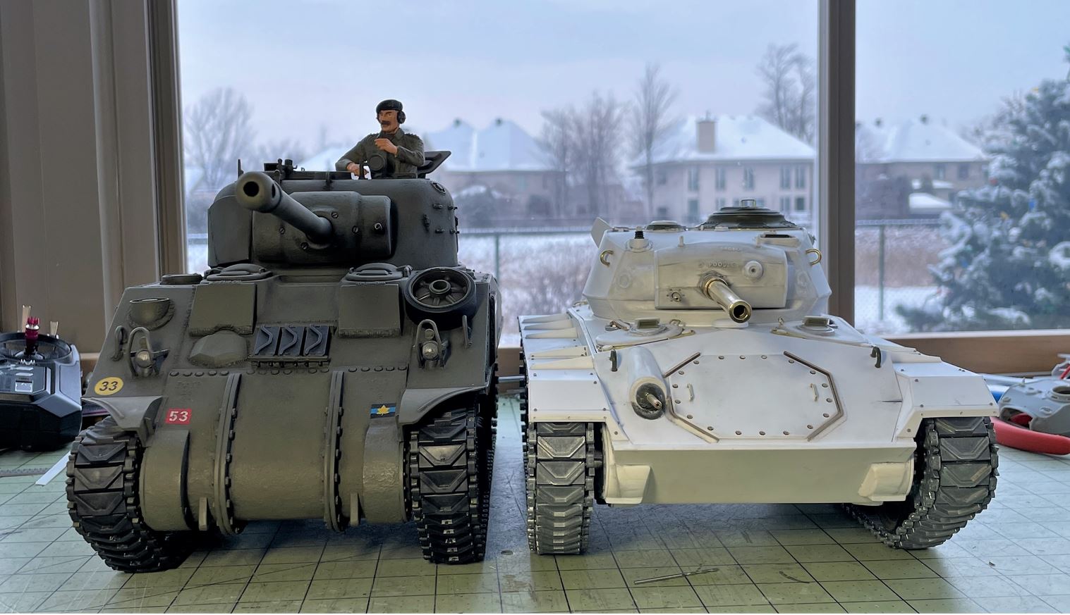

Comparing the Chaffee to a Sherman Firefly.
Comparing the Chaffee to an M5A1 Stuart.
