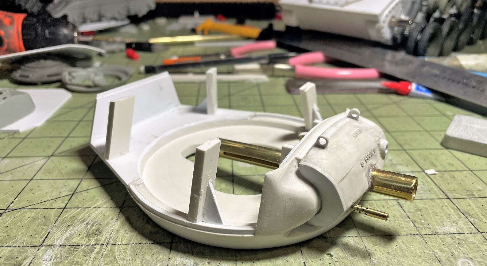

The barrel and sleeve are mounted on the mantlet. The push rod for the recoil servo is installed.
RC 1/16 M-24 Chaffee light tank- Dien Bien Phu 1954 - Build

The mantlet and gun are installed on the turret.

The armor on the two sides are in position, ready for the top to be cut.
continuing on following post
