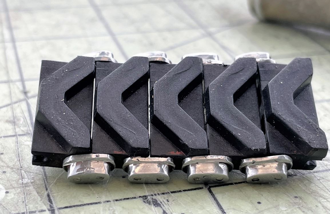

During planning, i did some validation on the use of the Mato metal/rubber Sherman tracks that come with their old plastic M4A1 RC tank. I could see that it had about the right dimension to represent the T85E1 tracks. The only thing to rework are the side pins.
RC 1/16 M-24 Chaffee light tank- Dien Bien Phu 1954 - Build
A T85E1 prototype was made and proven to be workable. The side pins were removed with a hand file and a central pin was created in plastic and glued, after anchor points for the glue had been created on both ends. Looks solid. Modified metal Mato Sherman sprockets will be used with it.

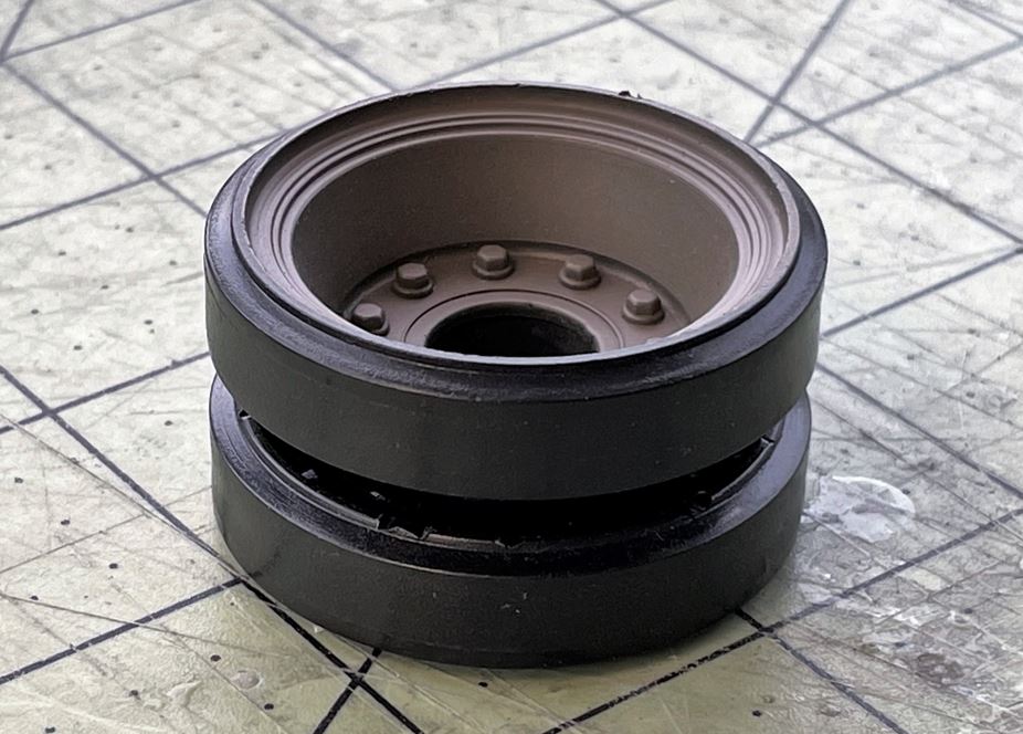

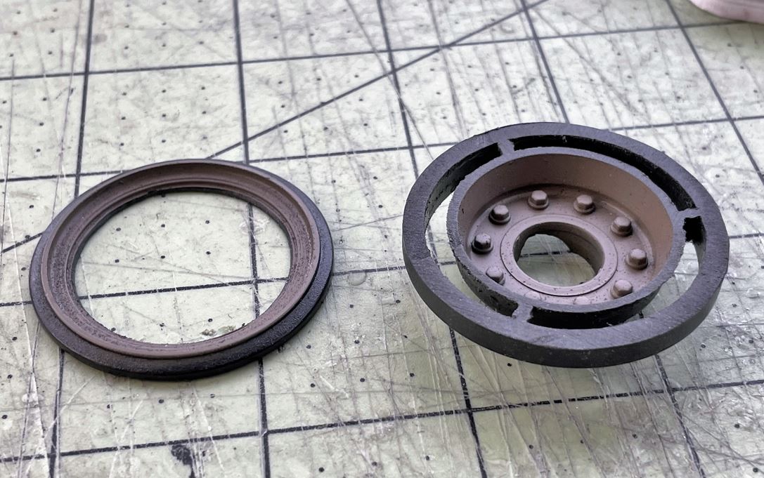

I decided to trim them a bit by cutting them in half at the line with a large Dremel fiberglass cutting wheel.
The two halves are then sanded smooth to re-gluing together.
An here we have a thinner M-24 road wheel. The diameter itself is about 1.5mm to large but i manage to remove 0.5mm by reducing the thickness of the rubber. This extra mm needs to be accounted for during the hull creation and placement of the suspension arms. There should be at least 3.5mm between road wheel.
Shown here on the right is an example of thinned M-24 roadwheel with an original M-26 on the left. Need 10 of them. The idlers will be another rework of the M-26 road wheel.

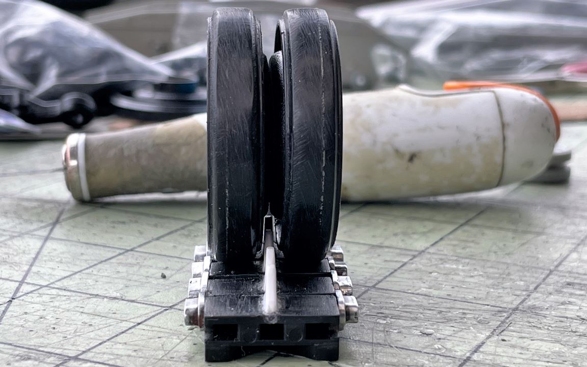

I made the return roller prototype a bit narrower as well.
This is the fit to the track prototype, looking good.

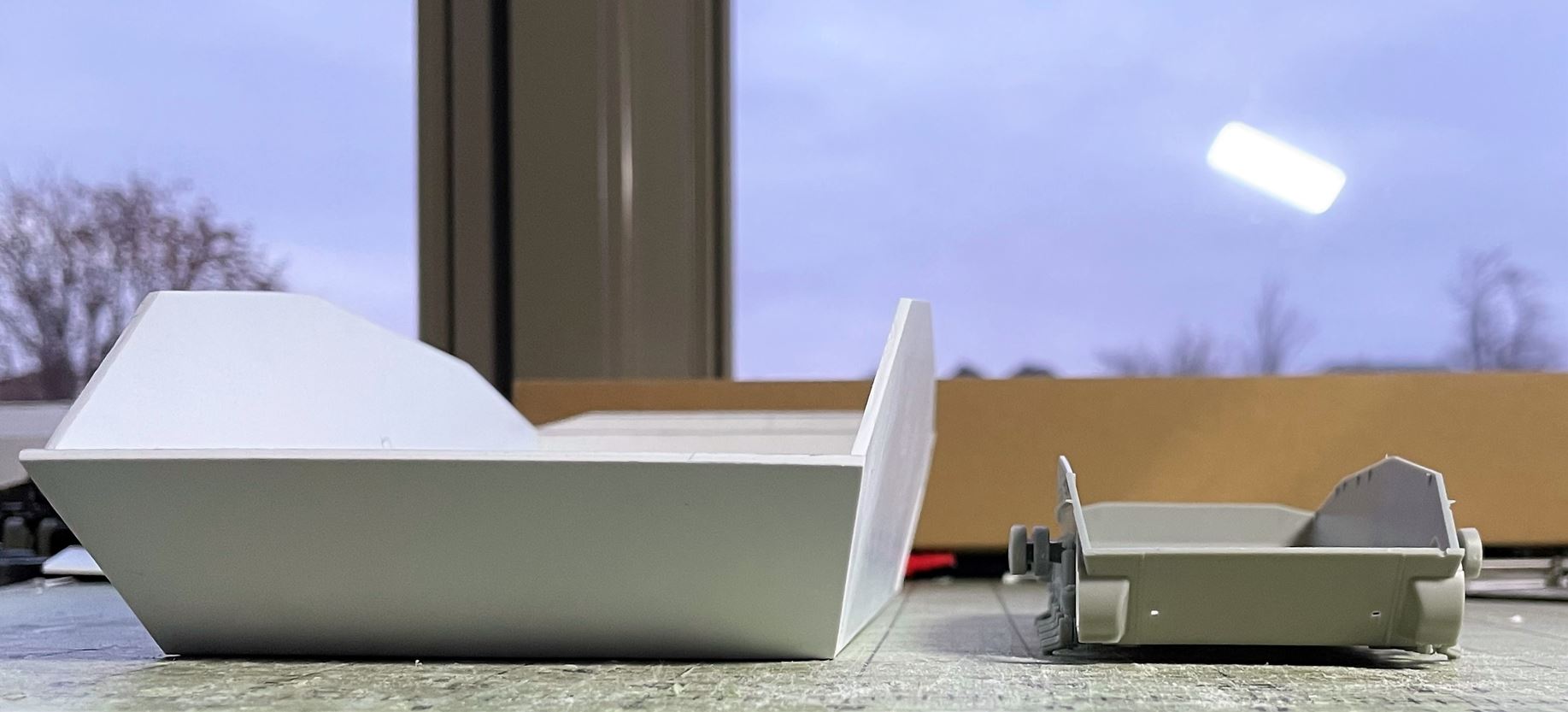

I decided to invest some time in building the Bronco 1/35 kit in phases to learn about its secrets, it will be at my side for the duration of the build. It is coming with working suspension, tracks, torsion bars... but no spring for the dampers. I guess it is a way to give the builder a new experience because in the end, it all need to be glued to ensure the road wheels are levelled evenly.

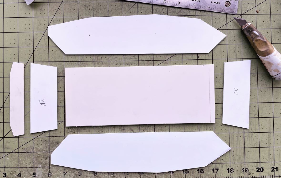

Parts are drawn on plasticard and cut. Because the road wheel have an extra 1.5mm of diameter, i gave the hull an extra 8mm in length to compensate. Over a total length of around 300mm, this extra length will not be noticed, but will allow me to give the 3.5mm of room between the road wheels, and adjust accordingly a mm here and there for the top.
Although these are flat plates, the Chaffee has complex angles on the upper rim to check and recheck 10 times before anything is cut. The base is 4mm millimeter think, the sides are 2mm think. It is important to properly reproduce the thickness of the armor when joints show externally. Reinforcements can later be done inside.

The lower hull main parts are assembled and compare well to the 1/35 kit.
