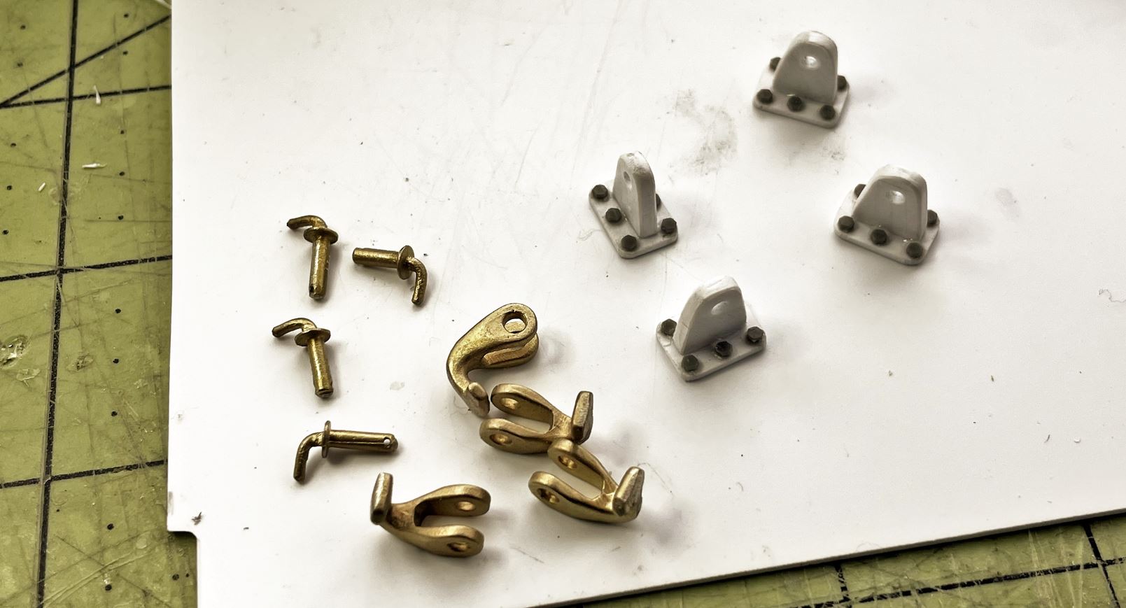

On previous M113 builds, i used a micro hinge hidden under the trim vane, and vaguely replicated the real hinges for static display. This has not proven very successful because the trim vane does not lower realistically all the way down and has proven to be weak during maintenance work.
This time, I have decided that the best way to go is to replicate the M113 hinge mechanism as is. The key part of the M113 hinge is the central extension sections that need to be at the right length, and made real solid. I have therefore created a simple jig with brass rods to solder brass strips and tube sections together, creating central hinge parts with exactly the same length.
RC 1/16 M113 Lynx Command and Recon tank - build
Then the parts are finetuned with a nail file. Imperfections will be corrected later with some putty and the enamel primer coat.
The four custom functional hinges are created. The plastic parts are a bit bigger than they should be in order to make them more solid.

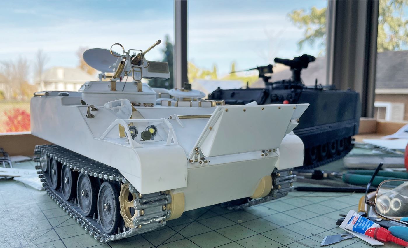

This is the M113 Lynx trim vane.
As it is a much exposed item right in front of the vehicle, i used M0.8 brass bolts and nuts to provide finer details.

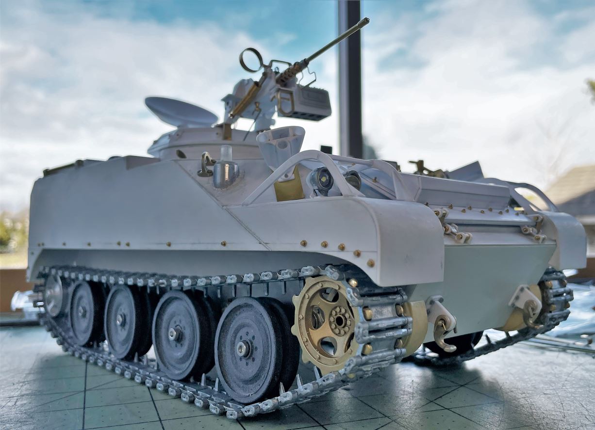

The trim vane is installed.
I was really happy to see that the functional hinges work perfectly and provide realistic lowering of the trim vane for accessing the gearbox hatch. The underside of the trim vane was not detailed.

Overview of the vehicle with the trim vane. Notice the M-113A2 in the back. It provided some dimensional info on the locking mechanism.

Position of the trim vane when entering water.

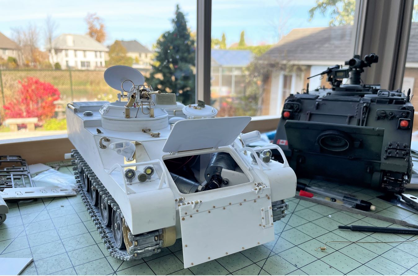

Position of the trim vane when accessing the gearbox for maintenance. Notice how the trim vane is moved forward by the double hinges in order to clear the hull and be totally lowered down.

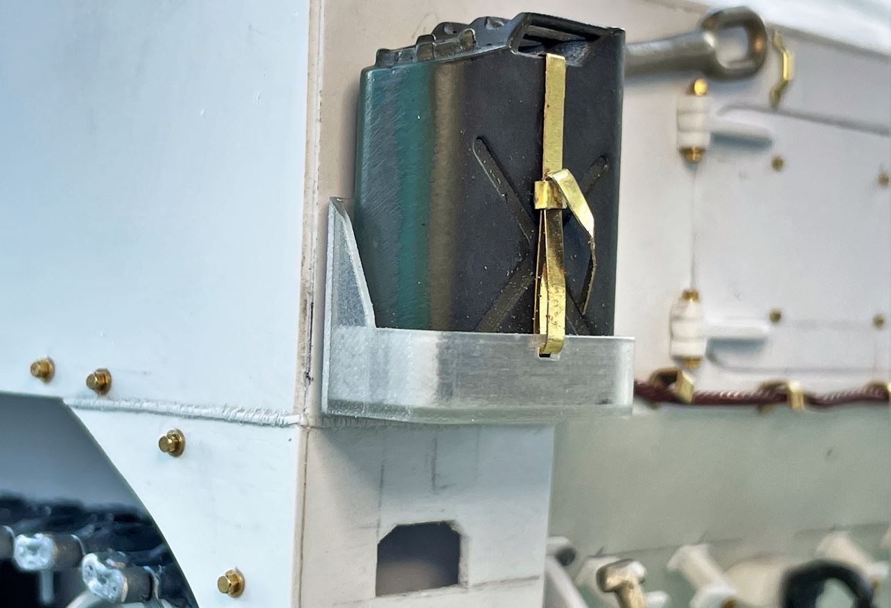

The Jerrycan holder is from Shapeways. Notice the weld lines on the mud guards.

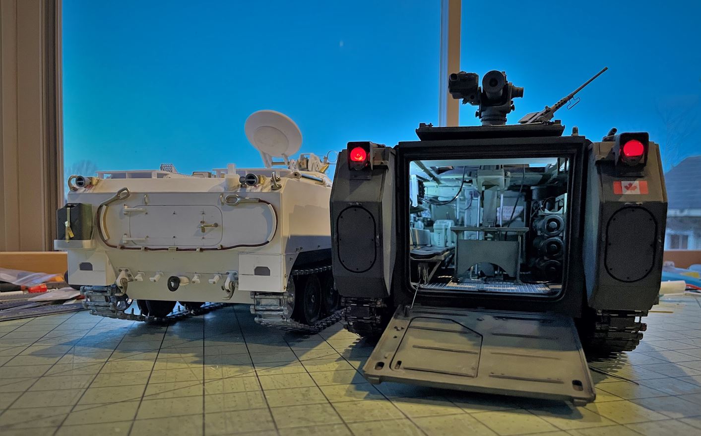

Overview of the rear of the M113 Lynx next to a regular M-113A2, with TOW missile launcher, built a couple of years ago.
