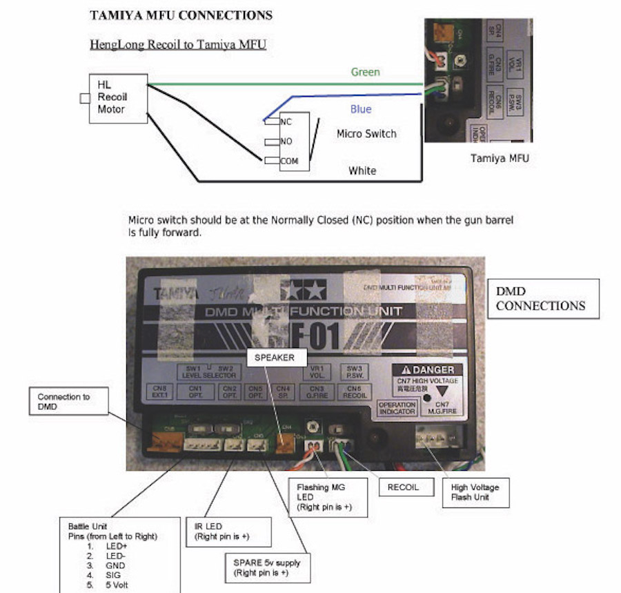

I'm guessing that the two-pin speaker connector on the KT MFU is rated at 5vDC, as is the spare connector. It's likely that the HL speaker can handle this. Finding the rating (in Ohms) for Tamiya speakers is not easy, but you can run some tests with a multimeter before taking the plunge. They're probably 4 or 8 ohm units. You could measure the output on the MFU speaker connector, and do the same on an HL v.6.0 unit (for which the new speaker is designed).
CN 4 is the Spkr. You will need to change the connector on the Heng Long speaker as the Tamiya type has a locking 'lip' that's absent on the typical JST.

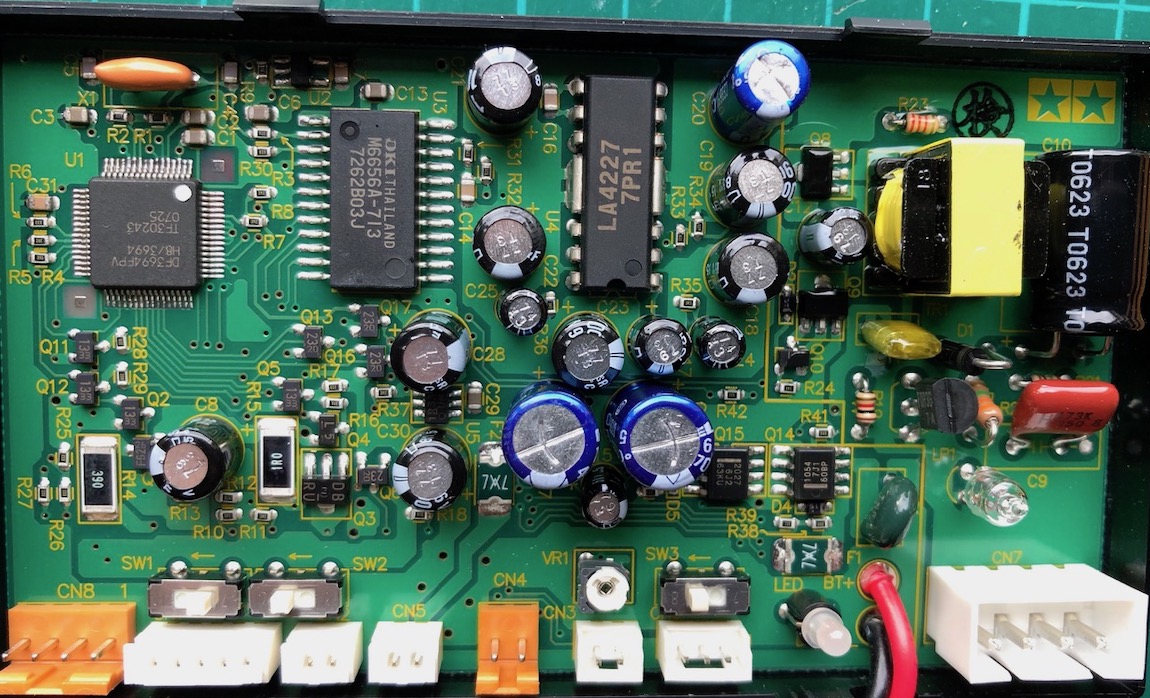

oh, and this is what the KT's MF-01 looks like inside, if it helps:
If you click on the pic, it should ENLARGECN 4 is the Spkr. You will need to change the connector on the Heng Long speaker as the Tamiya type has a locking 'lip' that's absent on the typical JST.
