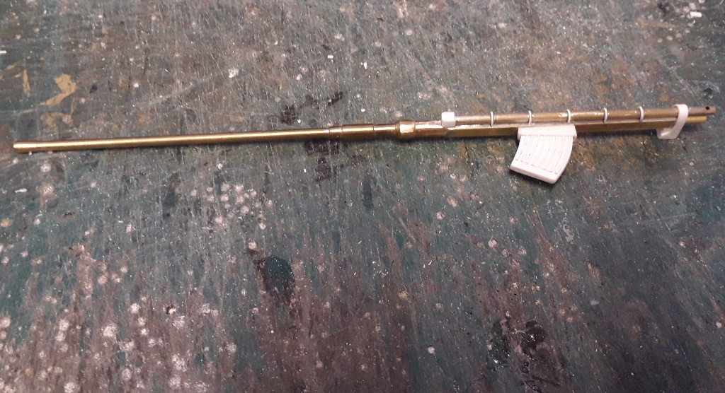

Here's a pic of the scratch built turned brass PWK 38 2cm barrell.

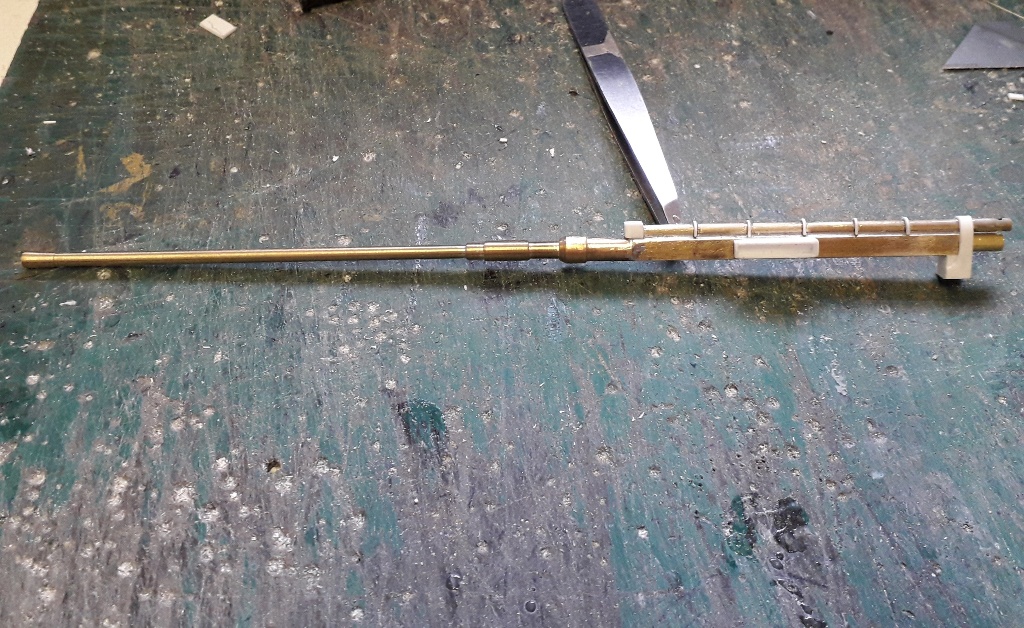

More KWK 38.
Some with and without the removable magazine and one in the mounting of the Hangelafette turret with mount and optic and manual sights.
Still a work in progress.
The vehicles full title is a Hangelafette 38 Auf Mittlere Schutzenpanzerwagon for those intetested.

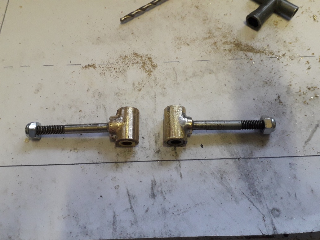

Second pic shows the steering knuckles made from brass and 4mm steel wheel stub axles

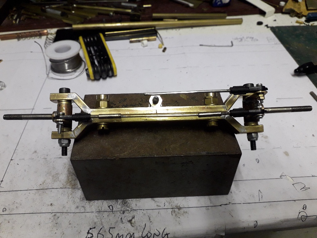

Third pic both upper and lower beams bolted togethet with steering knuckles attached and lower pivot point on upper beam, also steering arms fitted to the steering knuckles with individual adjustment for each knuckle ( more on that later )
Also lower coil spring mounts can be seen on the upper beam.
Just for informaripn, after each beam was cut and bent and soldered in place one end was blocked up and each beam was filled with resin to make it a solid structure and to stop the section from crushing when the bolts were tightened or some of the joints opening up.

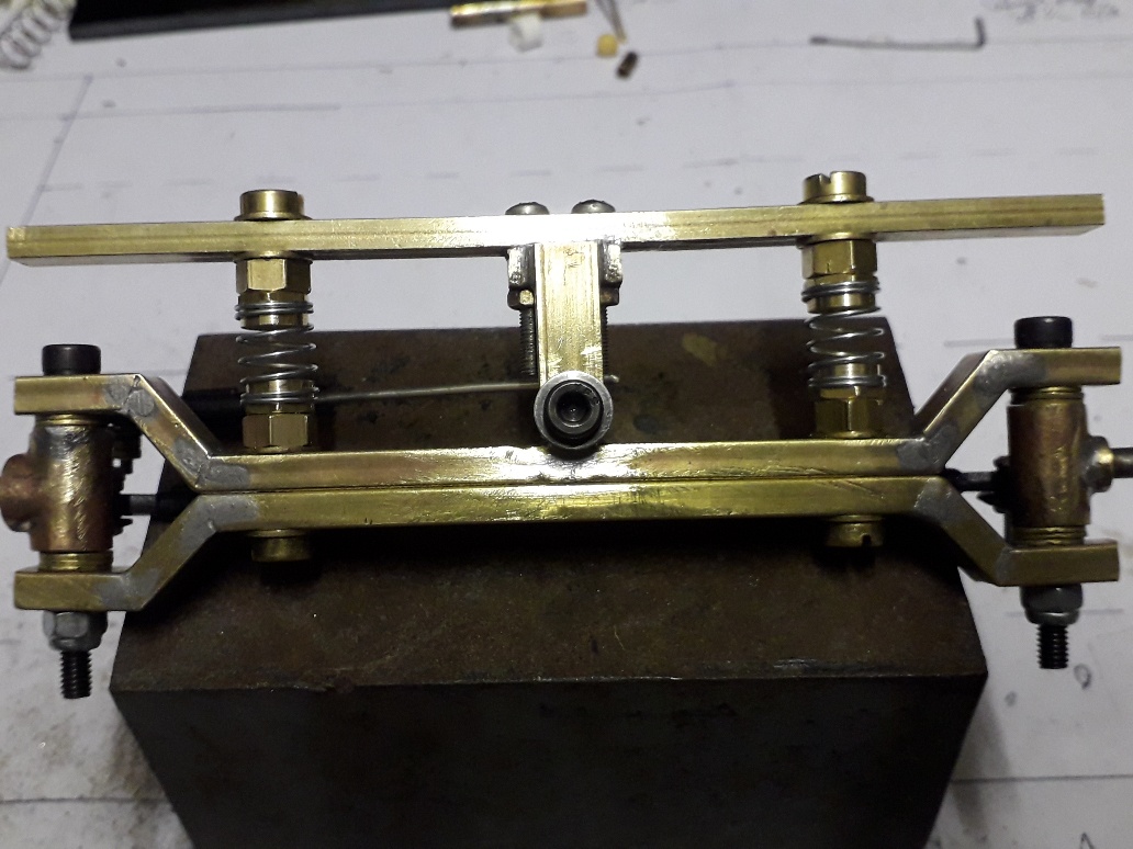

Re: Scratch build SDK.FZ 251 / 23 Ausf D Recce vehicle in 1:
A few more pics.
First pic ,
the complete axle with the upper chassis mount and springs in place, note that with the springs fully extended the pivot mount will not engage, this is by design as when the pivot mount is engaged the coil springs are already under slight compression, this is to stop them popping out from the upper or lower mounts when the axle is fully deflected either up or down.

First pic ,
