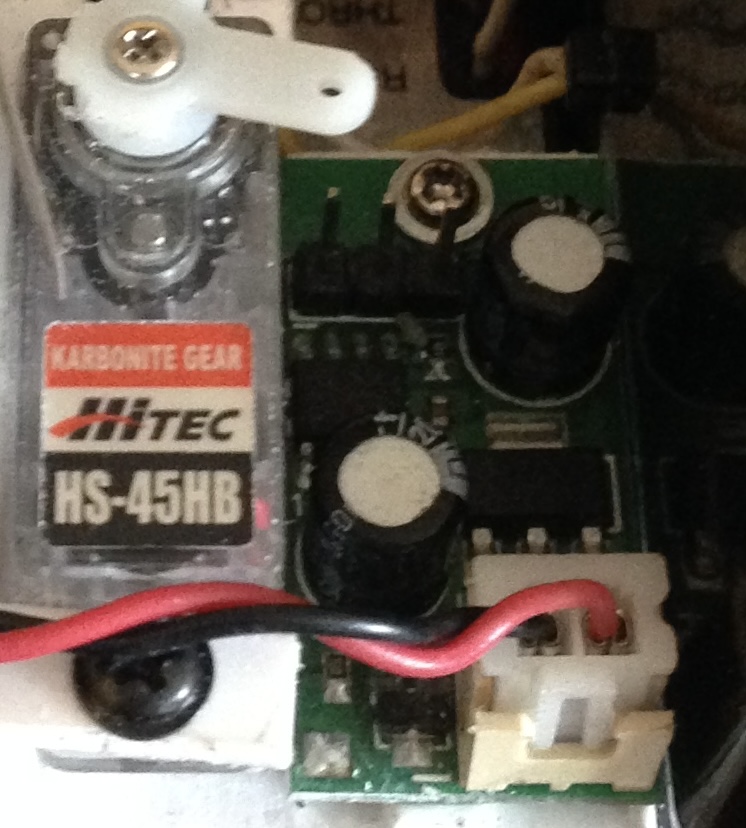

:) Good evening, in fact this system works with a permanent power supply (5 volts) then by applying a plus 5 volts on the black wire, we actuate the servo. Attached photo, assembly carried out in a Sherman Tamiya, for the gun recoil, the mini servo and micro contact which controls the 5 volts signal
