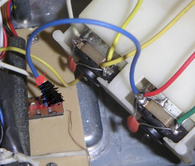

The blue and white wires to the on/off switch are for the recoil motor of the recoil unit they turn the power on/off 1 is on the positive terminal on the elevation motor the other is connected to the positive on the recoil motor you can just join them together.
The earth wire will depend on what board your using.

connect it the the negative on the on/off switch for the tank
