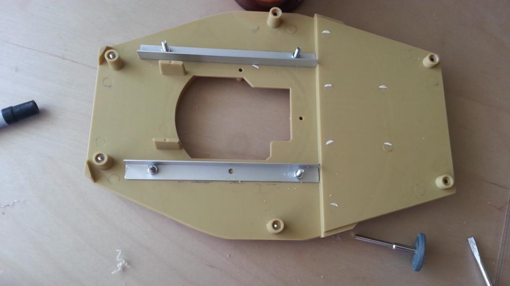

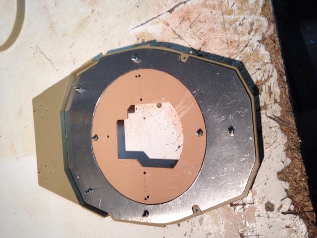

Tamiya sold a counterweight of 150 grs to be installed inside and on the rear of the turret base, to try to counter this phenomenon, it is also possible to reinforce the turret base plate, with 2 angles, or aluminum plate, browse the different posts of this forum, and find several ideas
Exemples;
Exemples;
