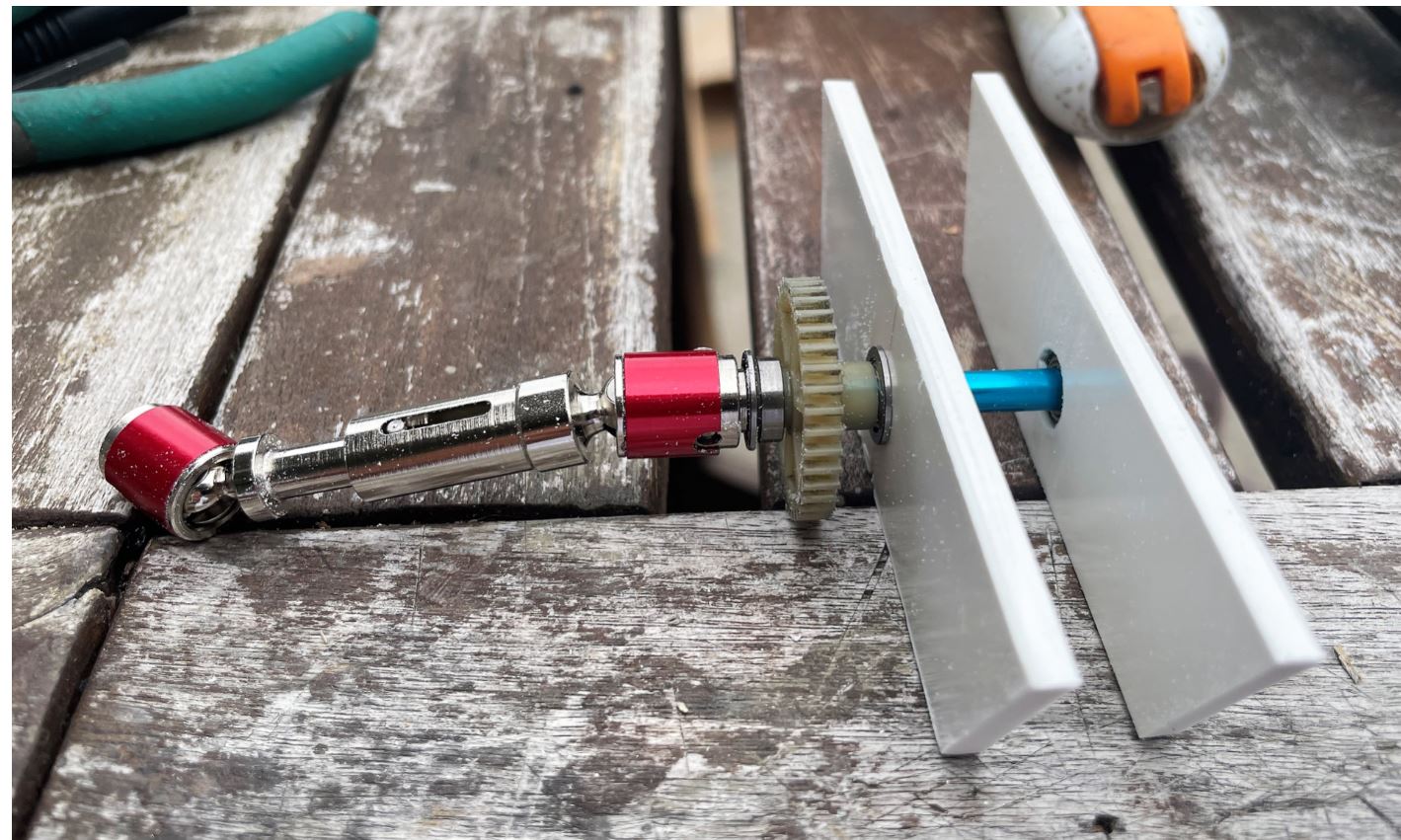

POC construction as follows;
Reused the discarded plastic gear and the leftover from the metal shaft. A hole for the connection to the drive shaft was made, and a anchor pin was inserted at the proper location for the gear. Being aluminum, this took at few minutes.
Basic design for the two main drive shafts for front and rear units.
A simple mount is designed.
And mounted with a few drops of superglue. As this is a POC, only the final design will be made solid later.
I had to remove a reinforcement bracket from suspension unit B and C in order to accommodate the drive shaft to the gearbox.
View of the two main gears now linked.
Both units are now installed.
