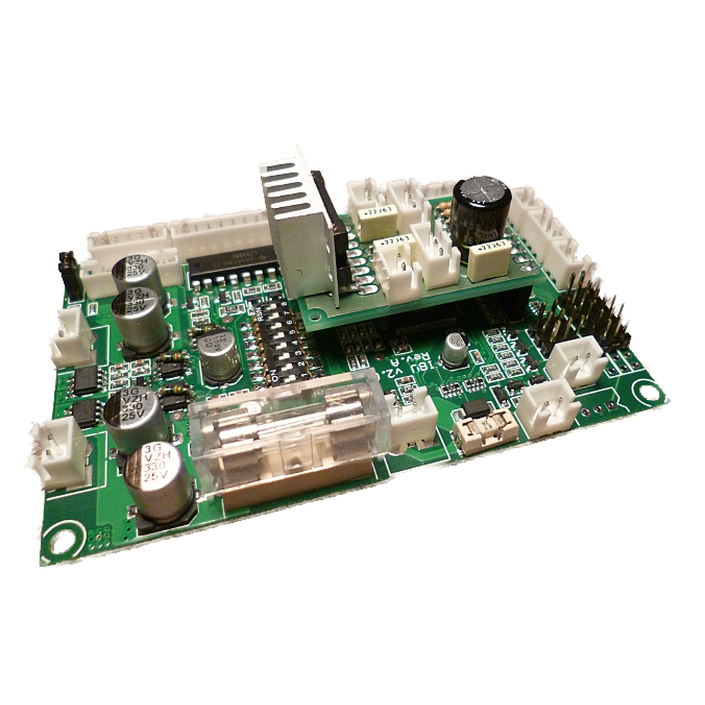

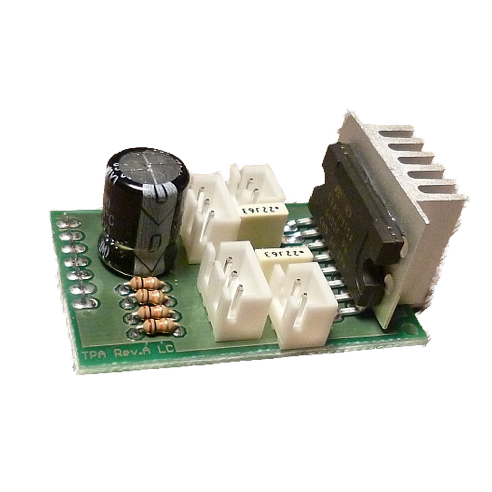

Does anybody tried this amplifier for IBU2? I still have a problem with the IBU2 being loud enough.
https://www.rctank.de/IBU2-TPA-Sound-up ... twin-tuner
IBU2 amplifier

I've tried 4 Ohm an 8 Ohm Visaton speakers and have the same issue. I didn't notice that until I went to RC meeting where tanks with elomd were loud as hell and IBU was very silent in comparison.

it´s a known problem IBU2 is being loud enough.
The amplifier can help but it depends on the quality of the audio files.
Is the audiofile too loud recorded you get with the amplifier a distorted sound.

Hello
here is what is done to amplify the sound of TK 22/24 or others when connecting an amplifier,
if the audio input is too loud? the amplified output will be distorted, hence the need to adapt the input power,
Links for Benedini
https://www.battletanksnederland.nl/php ... =15&t=7031
see what is made for Benidini
