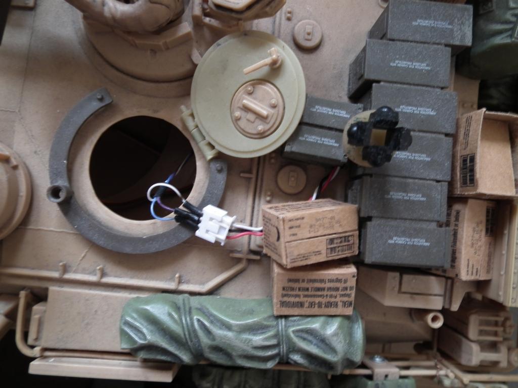

You can also just cut off this PH 3 pin plug in the IR receiver and add a standard servo extension cable, or use JST XH 3 pin (2.54mm) - like I did here:
JST XH 2,54mm 3 pin
JST XH 2,54mm 3 pin
but it's a less sophisticated solution ;)
