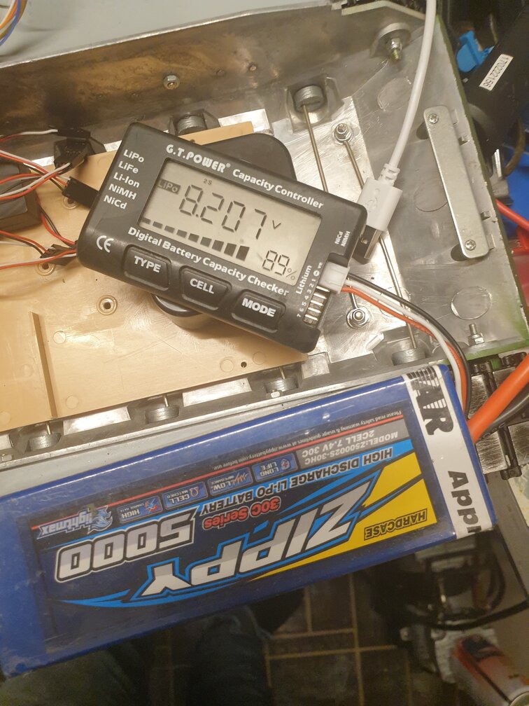

I know my voltages are ok. as for voltage under load i cant test it cuz it wont start . i will try to rebind thou.
