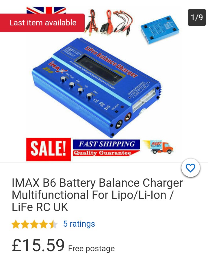

Overlander Tornado batteries are excellent and the only batteries that I buy.
The 3300mah is very good value for money, and I buy mine from Jadlam Racings eBay store.
As for chargers, you want a good peak detection charger.
I use a rather cheap and cheerful B6AC, which are also sold under Skymax, and find it to be very good.

If you power the charger with 230v, you will need a 12v 2a supply, which can be easily bought from eBay for as little as £2

Absolutely agree with that choice although the charger in the link is s B6 whereas the slightly more expensive B6AC has a built in 240v plug and a 12v DC plug. Take care, sellers are calling B6 models B6AC models when they are not. Those NiMhs are great packs and great value, up to 5000mah too.
