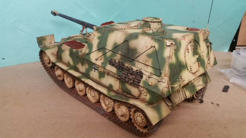

Another take on the venerable Imai Elefant with a few 'field mods.' Just a personal note on the all metal gear box on these beasts: as heavy by themselves as some complete static 1/16 scale tanks; hence the already recommended and well taken suggestion the model be supported by blocks when not in use. Painting of this one by Armor Doktor G. Farrow.

The suggestion of the blocks was born not to spoil the hull or for the transmission boxes?
