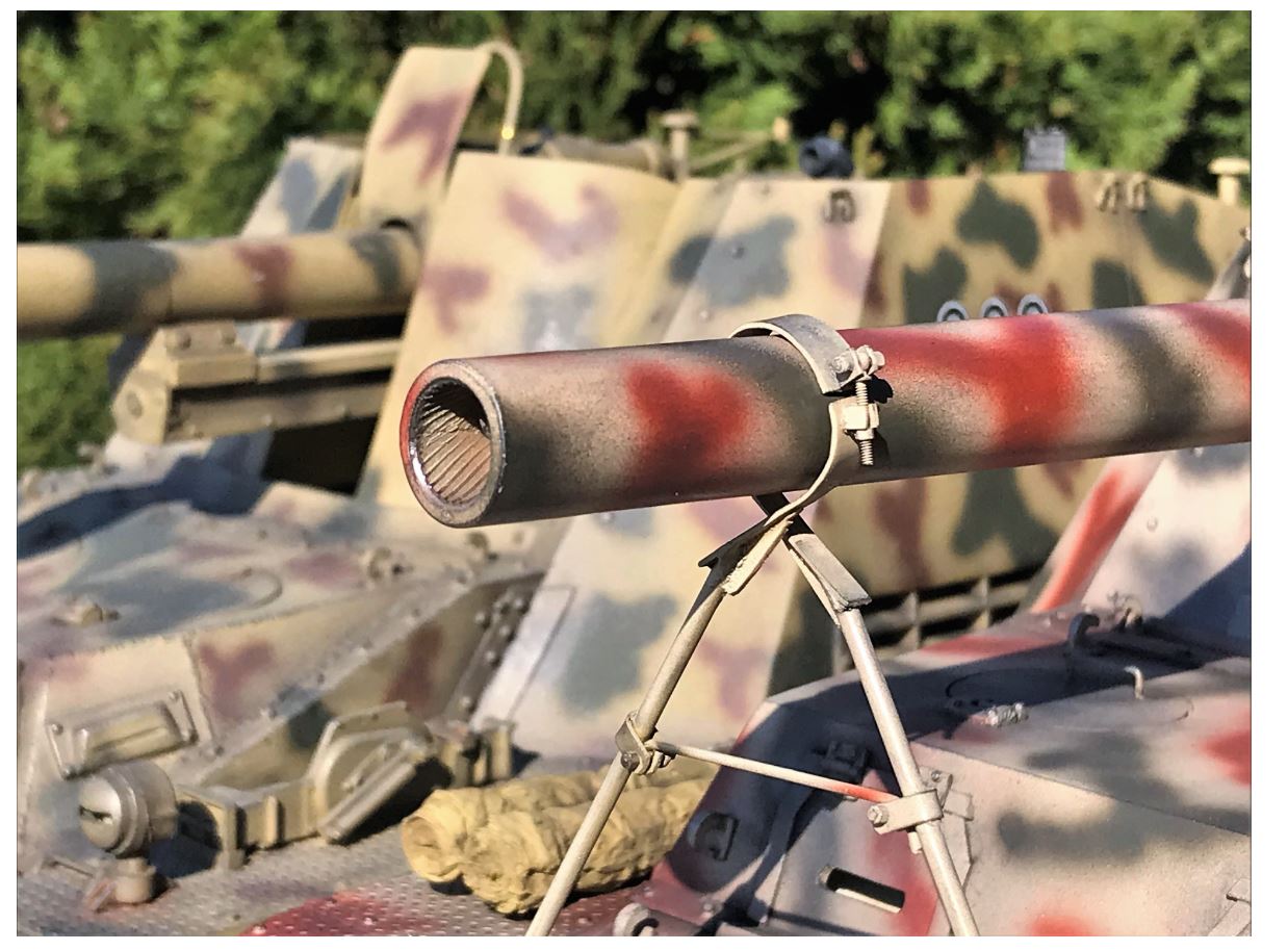

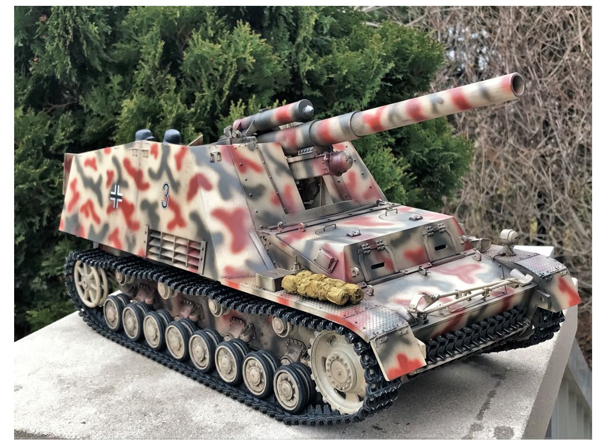

I finished the crew and as It was nice outside today, i took the model for a external photoshoot. I will later post a video of the model in action, with crew and gun recoil.
A rare sight in 1/16 scale RC, a mostly scratch built Late Production Hummel which is now a showcase in my collection.

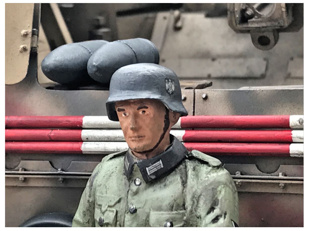

View of the modified Panzerparts.com resin/metal gun crew before painting.
Here is the crew
I took the challenge of posting a close up of the face. I am more a tank builder than a figure painter but i think this is acceptable.
Positioning of the crew in the fighting compartment, allowing the gun to recoil.
continuing on following post.

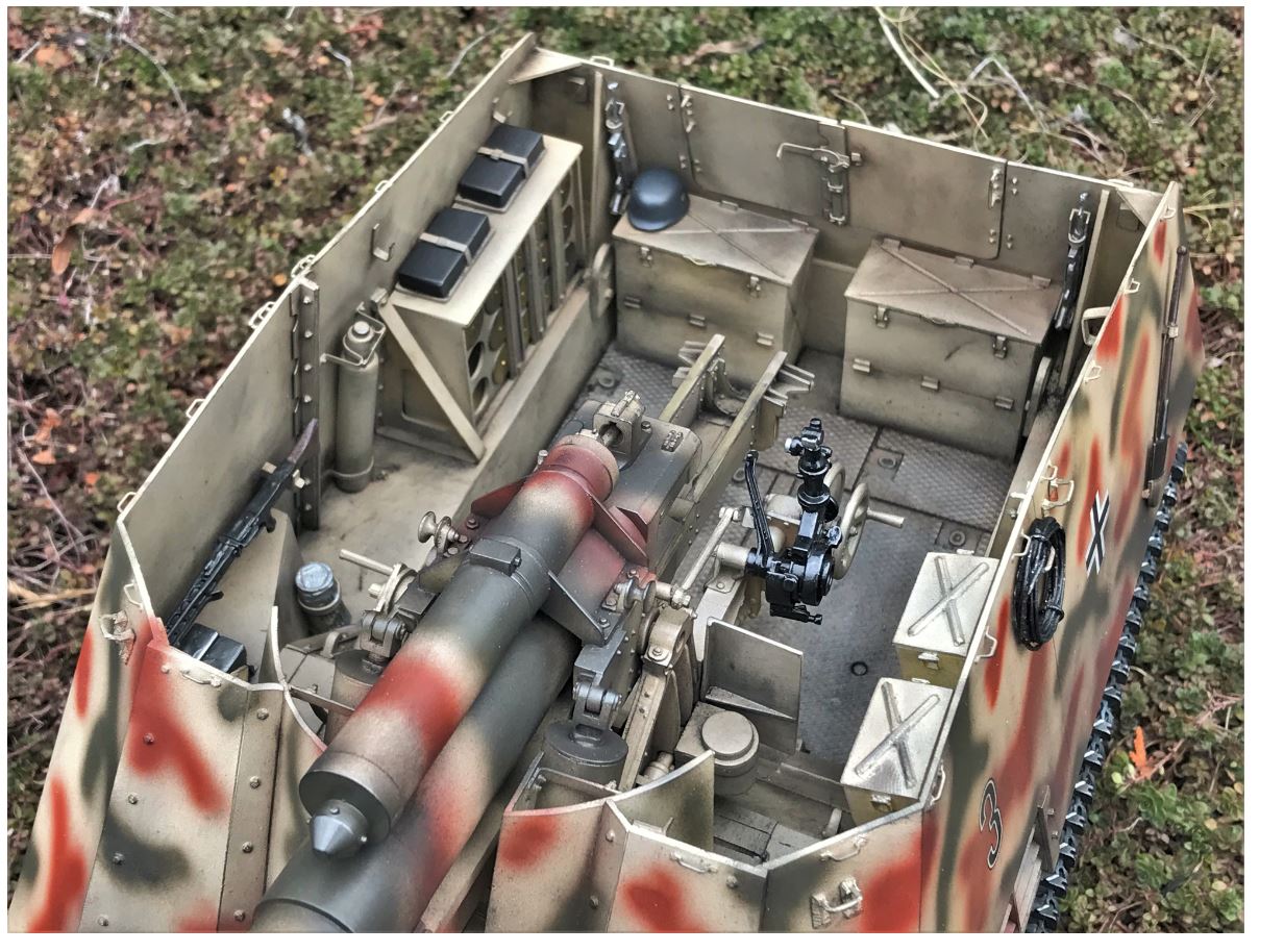

Re: RC 1/16 Sd.Kfz. 165 Hummel Late Production - Build
More pictures, with and without crew

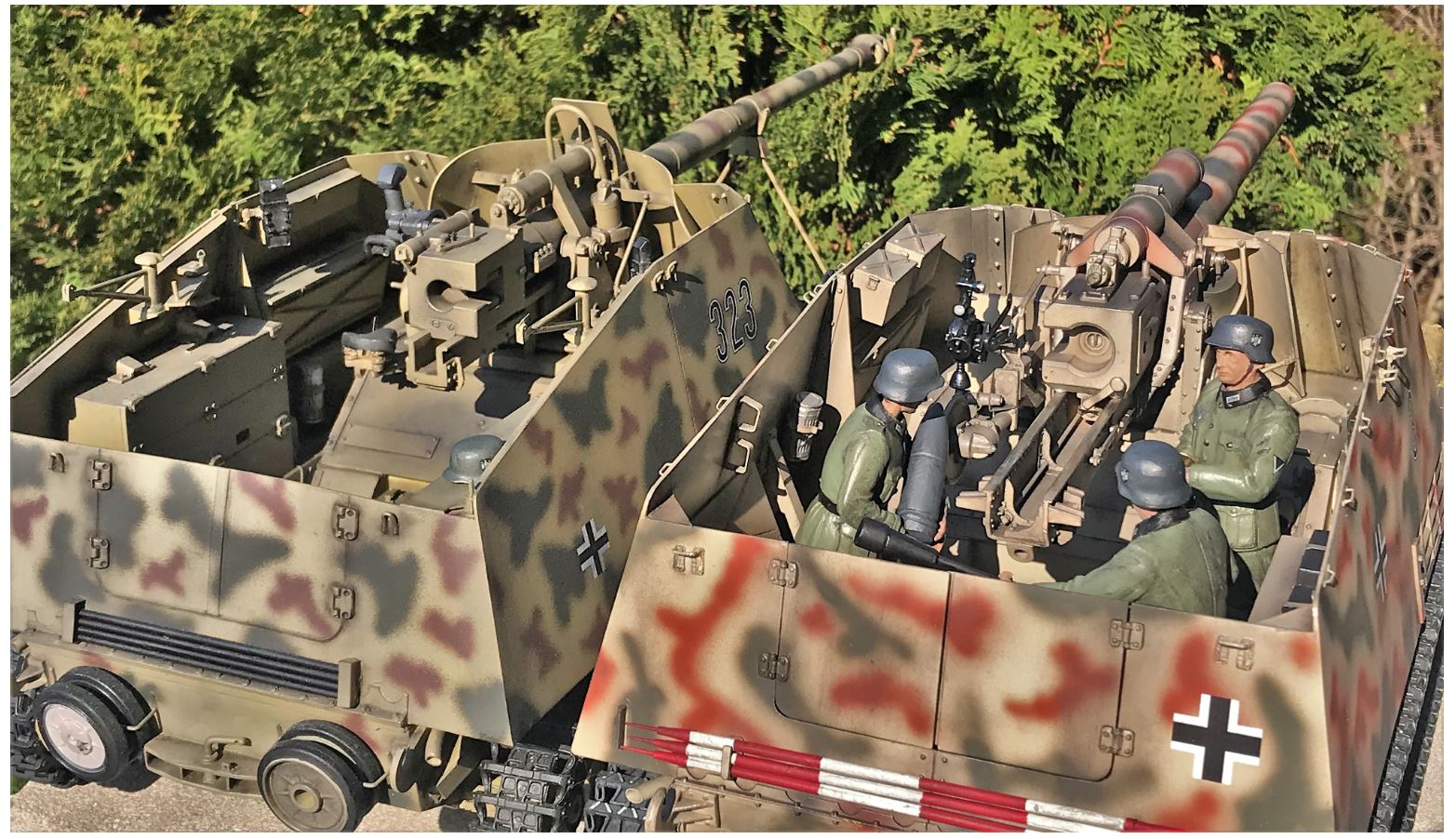

Taking the opportunity of a beautiful Easter afternoon to compare the Hummel to a modified Juckenburg Nashorn built years ago, both are in 1/16 scale. The Nashorn was never reissued by MK Modellbau which now owns the Jucknberg molds.
I see some differences of 1 to 2 mm in dimensions here and there, but pretty close.

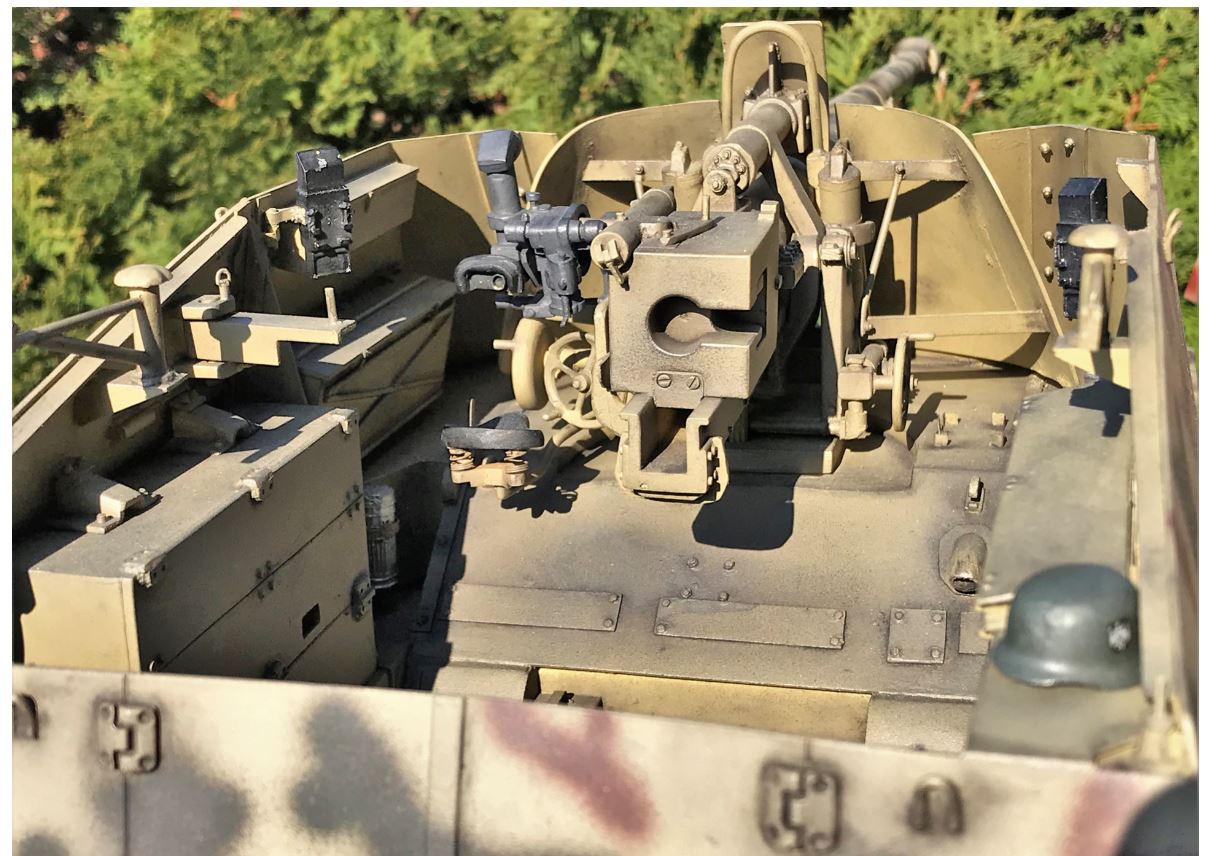

What is striking is the difference between the standard Tamiya Dark Yellow used on the Nashorn and the late war MIG Dunkel Gelb version that i used on the Hummel, even after some darkening done because it was initially even more light. The picture below is also showing the differences between the driver/radio compartment. A early production Hummel would have the same as the Nashorn.
Notice the different frontal armor arrangements for the guns.
Much different gun travel mount.
The plastic 15 cm sFH 18/1 L/30 of the Hummel allows for recoil compared to the static resin 8.8 cm Pak 43/1 of the Juckengurg Nashorn.
The whole interior of the Nashorn was redone because Juckenberg did not provide a single accurate component other than the gun. Take note that an accurate Nashorn requires the larger King Tiger 88mm shells, not the smaller ones used on the Tiger I.
Getting the Nashorn armored shield right is as complicated as the Hummel, specially when gun horizontal movement is enabled.
I never built a crew for the Nashorn. It is overdue for a complete rebuild of gearbox, tracks, electronics and to repair some damage, so the opportunities to create a crew, rework the gun to give it a metal barrel, recoil and flash, and repaint it all is very tempting.
