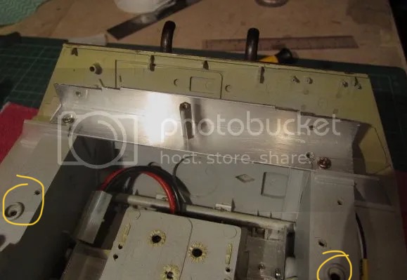

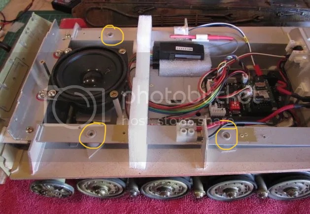

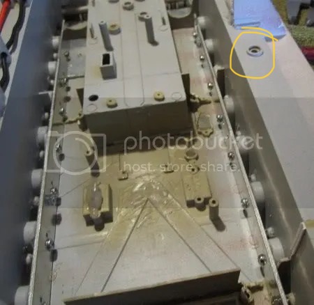

Jofaur86
Posts: 2224
Location: Centre France
Re: Matorro King Tiger
Post by Jofaur86 »
??? did you look under the wings? as advised, on the attached link, see the photo where the lower frame is held with one hand, we can clearly see the holes of the 6 fasteners seen on the upper part :(
http://www.hobbyhavoc.com/forum/index.php?topic=910.0
