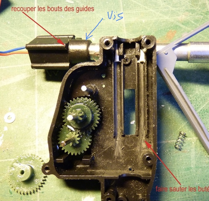

good evening, if it's airsoft? there must be a small screw that holds the barrel, on the mechanism, with some photos would be easier to see?

airsoft recoil constitution HL (principle)

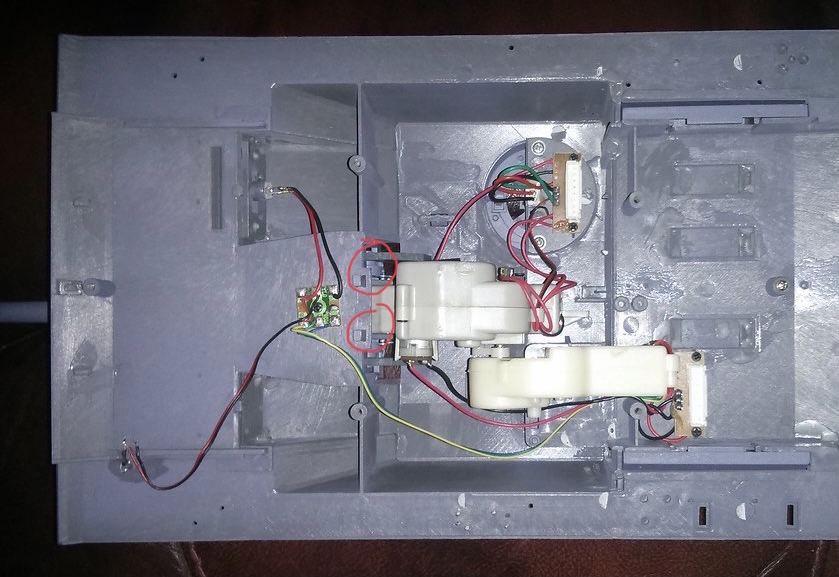

maybe I confused? Personally I would say to the view of the attached photo? that there are these two small doughs to take off, (cutter blade below, or removing) had this experience on a PZ III
red circles

Yeah.....Jofaur86 wrote:maybe I confused? Personally I would say to the view of the attached photo?
Mine looks different inside. Roughly where your circles are, mine has two brackets. Each bracket is held in place with 2 screws. Roughly where the circuit board is in your picture mine has a circuit board mounted to a removable piece of plastic. It is held in place with 2 screws also. If I remove all of these screws the whole assembly is loose. BUT the mantlet is too big to fit through the hole in the hull. The mantlet has two small screws holding it to the assembly, but even with those screws removed the mantlet is still tight and will not move.
