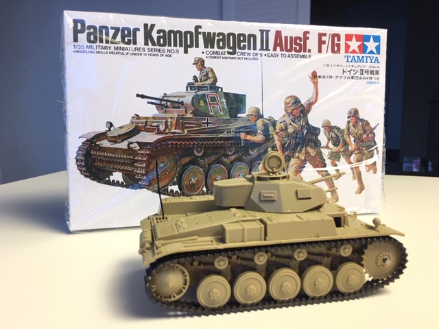

I got this Vintage 1971 Panzer II model from ebay in shrink wrap for $20 shipped! What a bargain. Not so fast, I also used a NOS M10 kit to supply the rare narrow gearbox for this build.
So to build this you need:
1 Panzer II kit
1 M10 Motorized Remote Control kit (or equivalent). There are only a few kits that have this narrow dual motor gearbox.
Micro radio gear, connectors, battery. correct motors with appropriate impedance for radio system selected. $$$ :crazy:
This was the most challenging one yet to make dual motor radio remote control. The model has a motorized version (single motor) and this one has the hull that will accept that gearbox although I have never seen one with the gearbox. It must be very small to fit the small chassis of the PKW II.
The track system is a non live track system with a single sprocket center track drive. It is unique in my collection. This is an early WWII tank and is very small but very cool.
I just got it running and it has impressive obstacle ability. I will try to get a video of it asap.

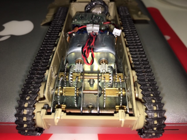

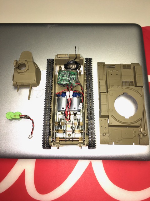

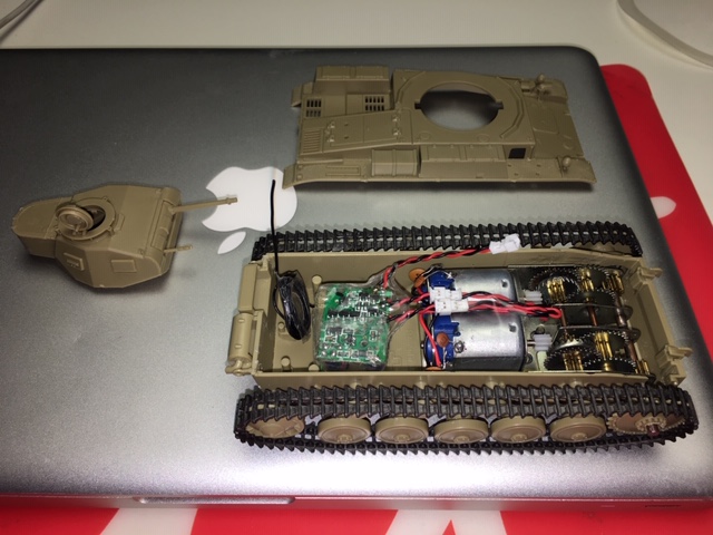

I used a NOS Tamiya metal gearbox from Motorized Remote Control M10 Tank Destroyer kit. It fit the Panzer II with some minor modification. Picture of that kit below.
I also have 1 more of those M10 tanks in a shrink wrapped box. Sadly I will be opening it up just to get another one of those narrow gearbox for a another build.
This M10 Kit has the rare "narrow width gearbox" which works in the Panzer II.
Very tight fit height wise. Width is not a problem with this narrow M10 gearbox.
Very small 27mhz 2 channel radio works great for now but does not have proportional control but rather on\off one speed type control.

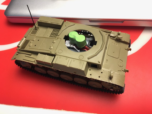

Had to cut out a panel to lower the height of the gearbox. it is that tight of a fit. I am sure this model never came with a dual motor gearbox. Actually it is impressive that is has provisions for a single motor setup although I never saw a motorized version for sale.
2 cell nicad 60mah (3v) battery keeps things lite weight.

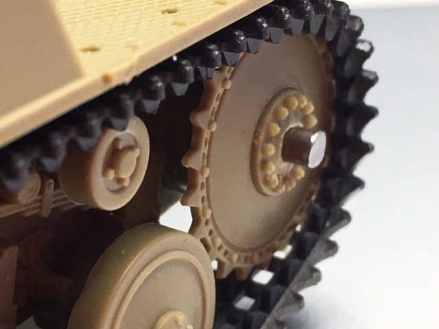

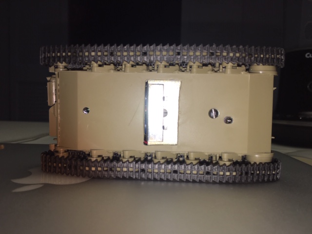

The axle from the gear box coming through the drive sprocket makes for a very stable drive sprocket with no wobble. I will trim it back a little as it sticks out a little more than I would like.

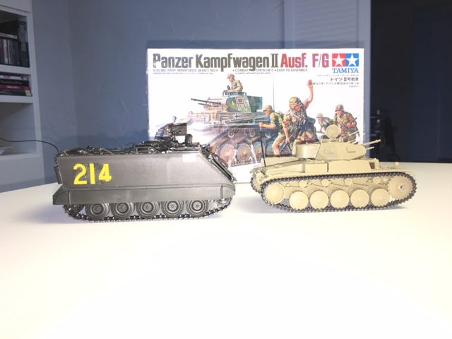

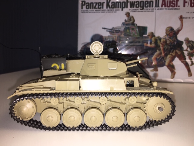

About the same size as a M113 APC. The APC is featured here in another thread. It uses the SAME GEARBOX AS THE PANZER II.
$20.00 from ebay. Was new in a shrink wrap box from 1971! I have one more of these sealed kits on the way for another $20

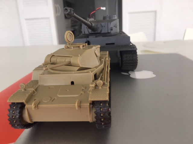

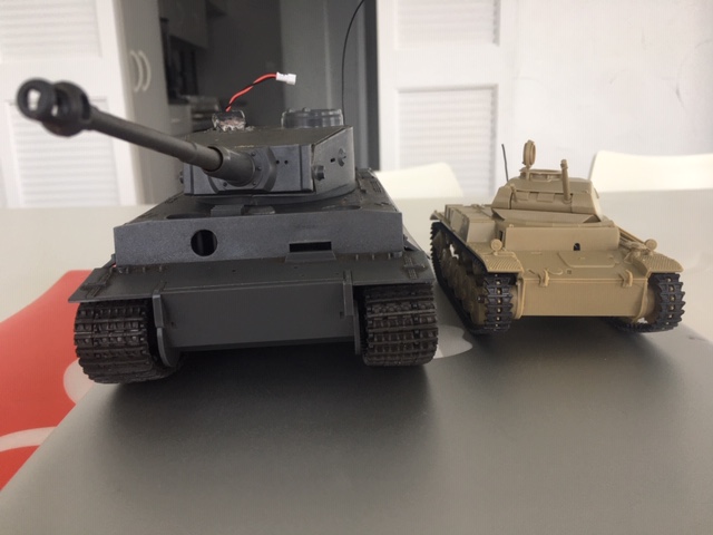

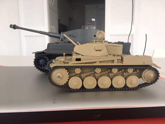

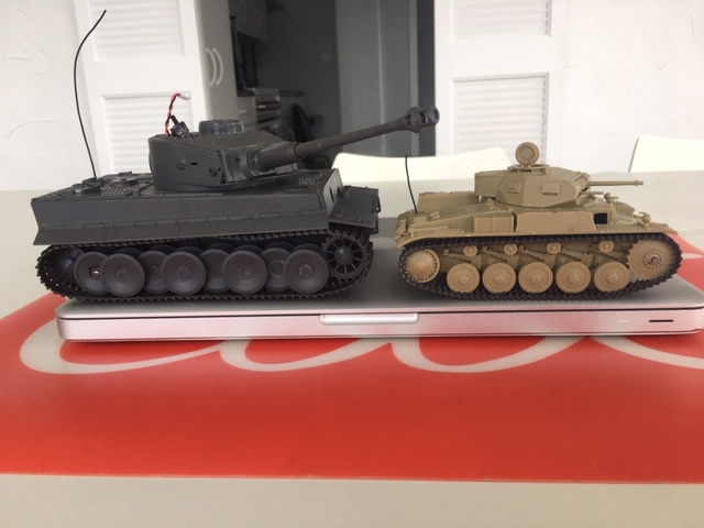

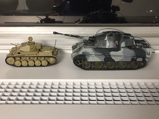

These early Panzers are fascinating to me. They are so small compared to what came later. I posted a few pictures to show the scale of the size difference B|
Model still needs final assembly and decals. I will get to that as soon as I can stop building more lol :crazy:
Tiger I VS Panzer II
King Tiger VS Panzer II in size. both 1/35 scale, I know crazy right? Can you say escalation in size lol?

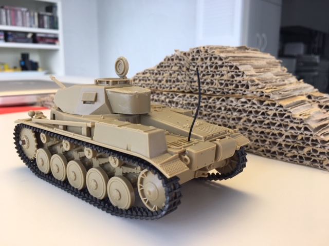

Anyway, here is a short youtube model of the Panzer II climbing my "test obstacle"

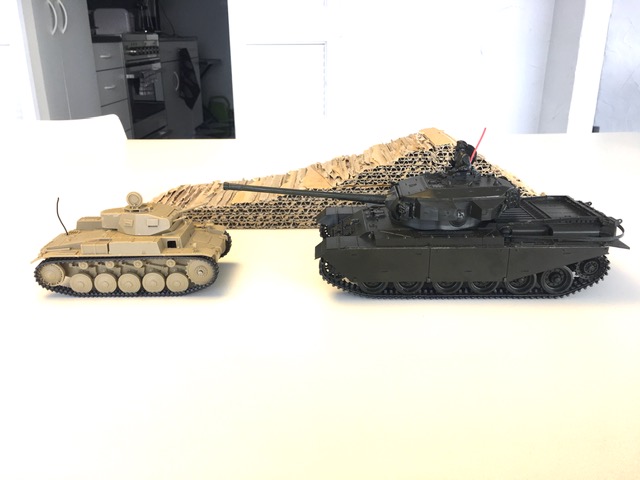

Panzer II shown here with a 1/35 Centurion. Looks to be under gunned lol

1/35 Panzer II climbs with the best of them maybe even the best so far.

Yes the laptop is actually very difficult to get over for most of my 1/35 tanks. Panzer II gets up and over pretty easily. On the next obstacle, The Tank's tracks need to bite in to make it to the top. It is also very narrow so requires good track steering control to stay on the path otherwise off the side and a crash with possible damage to the tank.

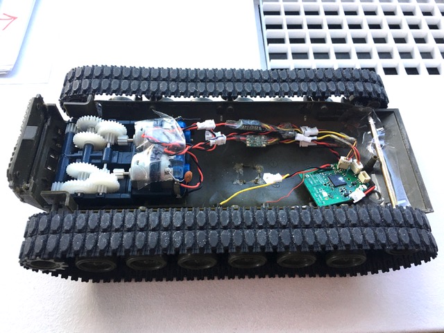

Radio update:

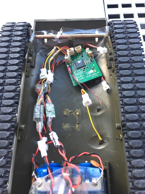

Next I will be installing a new micro DSM2 radio system, This radio is from a UM CCP Heli and will have some interesting features like cruise control and very precise low speed control. I am experimenting with it now in another tank and once I have the TX programming perfected, I will install it in this Panzer II.
Initial testing and TX Programming being done in this 1/35 scale M60 hull and so far looks very promising .
DSM2 CCP Heli RX with 2 micro ESC's (Das Micro) being evaluated for use in remote controlled Tanks.
