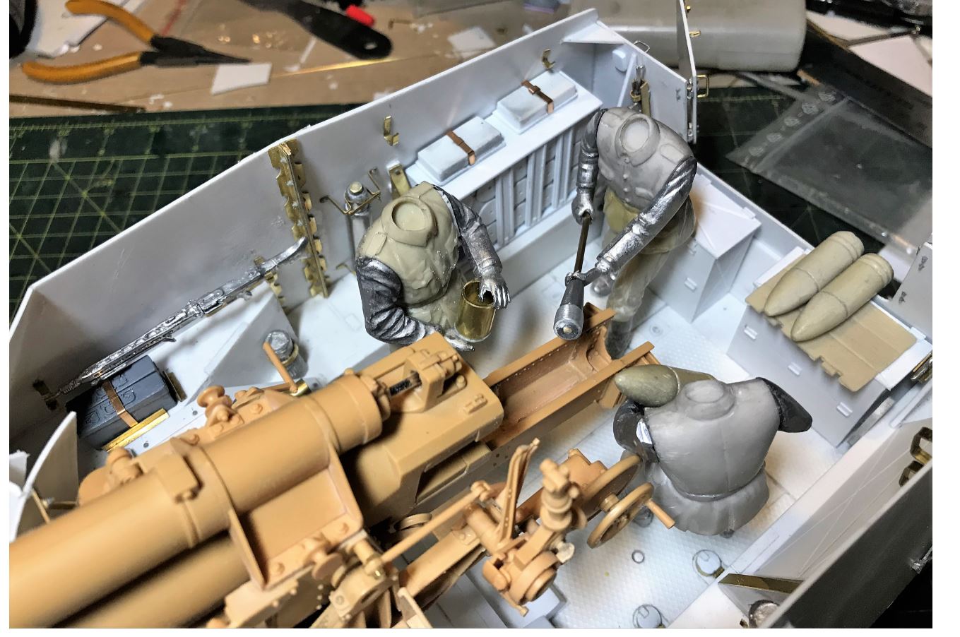

This post is for the planning of the crew, and basic assembly and positioning of the arms.
The sFH18 is a heavy howitzer. The 15cm ammo came in two separate parts, shell and cartridge case. The shell alone had a weight of 44kg or 96 lb, and is quite large.
RC 1/16 Sd.Kfz. 165 Hummel Late Production - Build
The single crewman responsible for loading the shell needed strength and a method for lifting and charging the gun.
These are the Modellino 1/16 scale gun crew made of resin and metal.
This is the loader, responsible to present the shell to the breech. The original design of the pose is questionable. I need the loader to hold the shell, not to singularly push it into the breech with arms up in the air. I doubt this was achievable anyway with a 100lb shell... I therefore had to reposition the arms and shell lower, closer to the body and in a way the loader could spread the weight across his both arms.
The arms are in some kind of alloy that allows to repositioned the hands a bit by slowly twisting them in the desired position.
This crewman is responsible for pushing the shell into the breech. No issue but the arms were reposition so that the tool is held higher.
This third crewman is responsible to load the cartridge case. I repositioned the hands holding the case up, more to my liking as i am guessing the cartridge case would normally carry the shell propellant at this stage.
At this time, the arms are just positioned, superglued and reinforced in place, next will come the putty and sanding job.
Checking the position of the crew inside the fighting compartment of the Hummel. Looking good. I am still wondering if i will permanently glue the crew in place while still allowing the gun to elevate and recoil, or just put them in place for static display.
