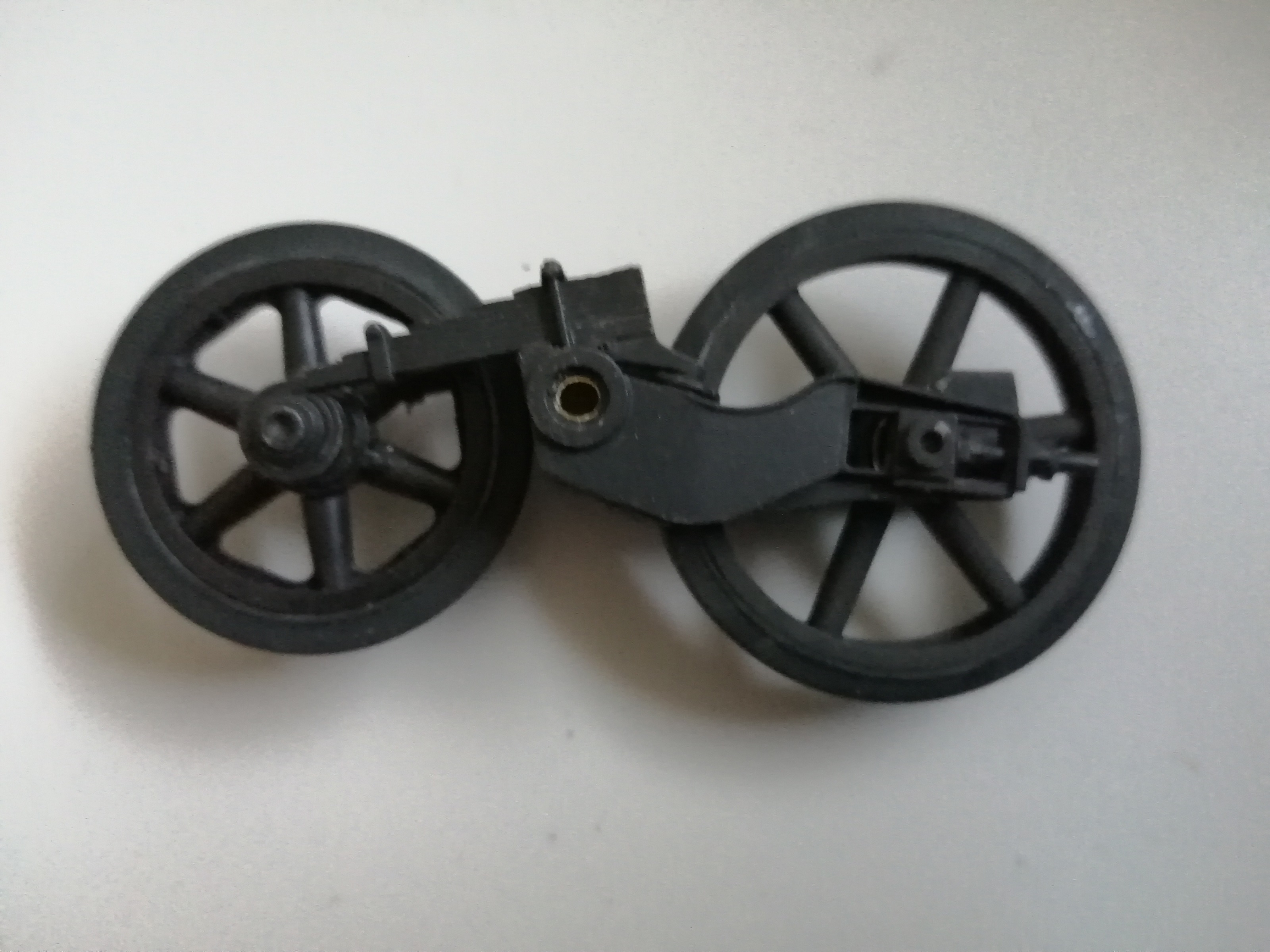

I will, however, start with one major difference. To get the correct track tension, Louis fitted Mato Sherman tensioners to the idler wheels. Great idea, so I went ahead and bought a set. What I should have done was checked my kit beforehand. I had not appreciated that the Aus B actually had a different wheel set up, comprising 6 wheels, as opposed to the 5 on the A.
Ausf B.jpg (94.69 KiB) Viewed 4638 times
This is the rear bogie
and this the close up of what is effectively the idler wheel.
The representation of the adjustment gear is very good, but for me to try and replace it with an operating version is another matter.
I shall just have to hope that the tracks have the right tension. To attempt to change the plastic parts for a working tensioner are way beyond my ability.

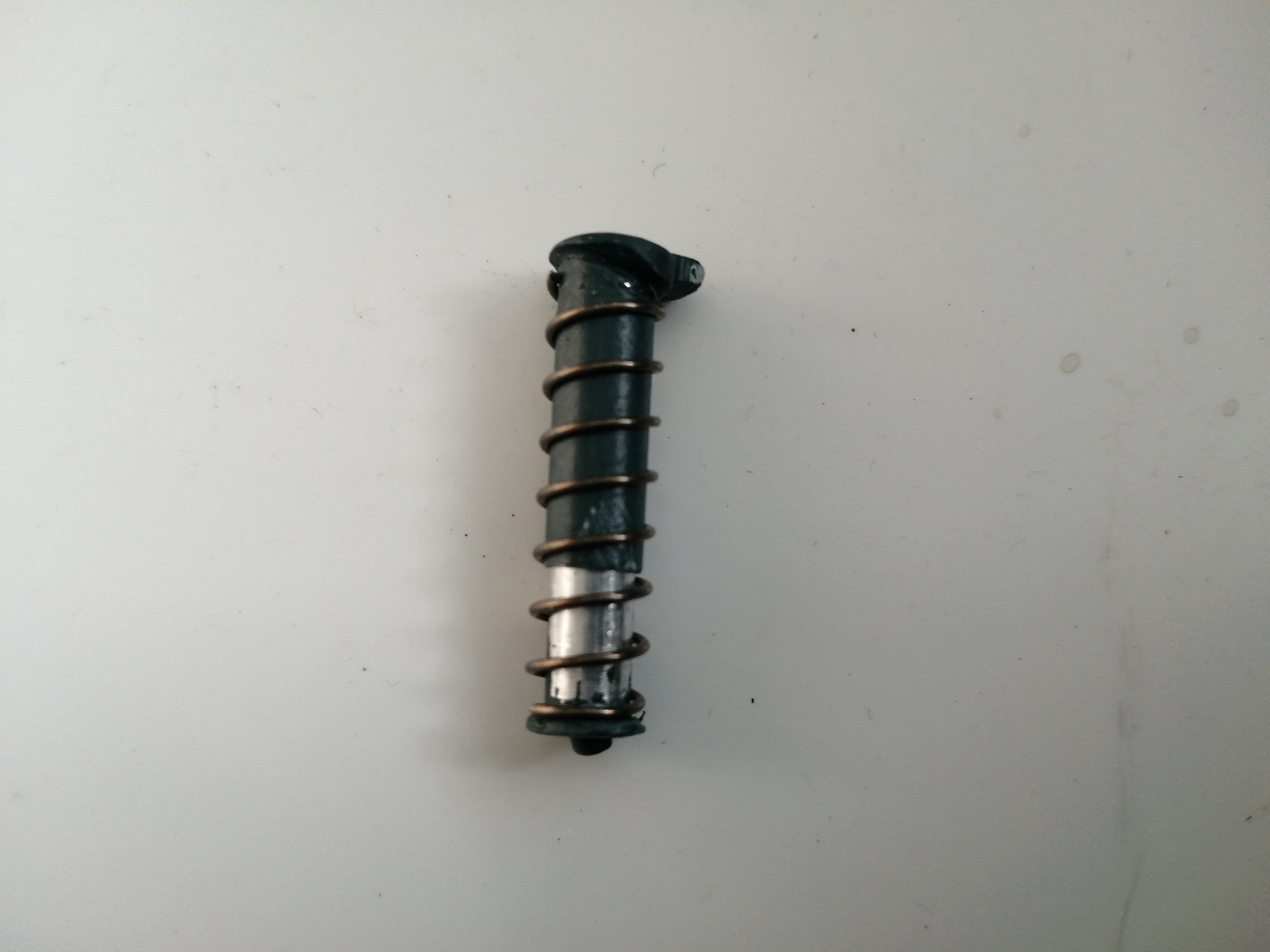

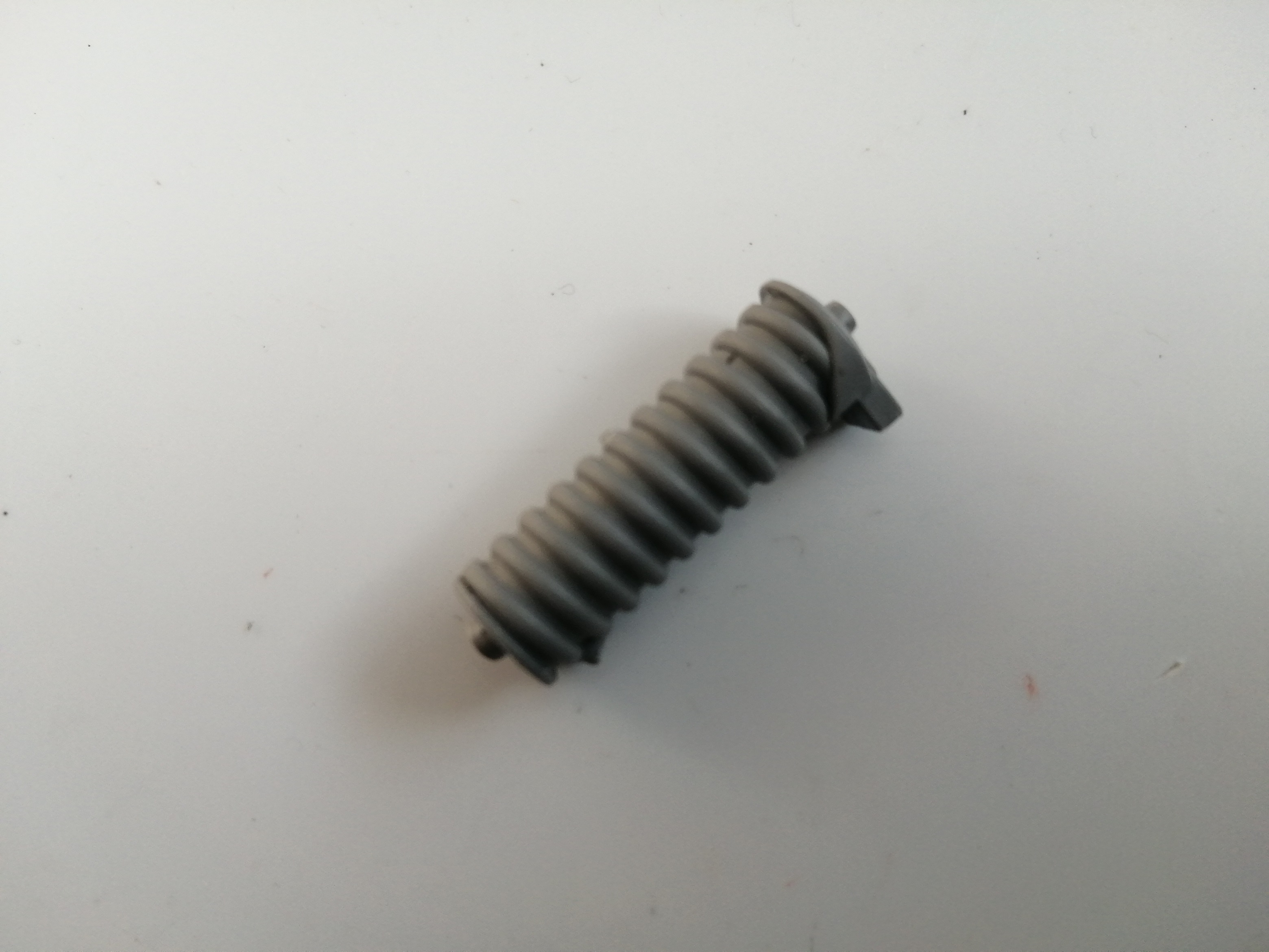

A small update. The front road wheel is a single wheel on a swing axle. Suspension comes from a coil spring and shock absorber. This is what the kit part looks like.
The problem was how to convert this to make it operational. Inspiration came from Louis' build. The "shock absorber" body is formed from two pieces of aluminium tube, 6mm and 5mm, which provide a perfect fit. The spring came from https://springsandthings.me.uk/shop/com ... n-springs/ They have a huge range of springs, all cut to the required length. Their service is outstanding. I had to order twice, as I messed up the measurement the first time. Ordered one day, received the next.
Anyway, this is what I have produced.
I am hoping the spring has the correct compression. If not I have some leeway in cutting it down. It it turns out not to be strong enough, I can easily get some longer ones. The cost is minimal.
Richard

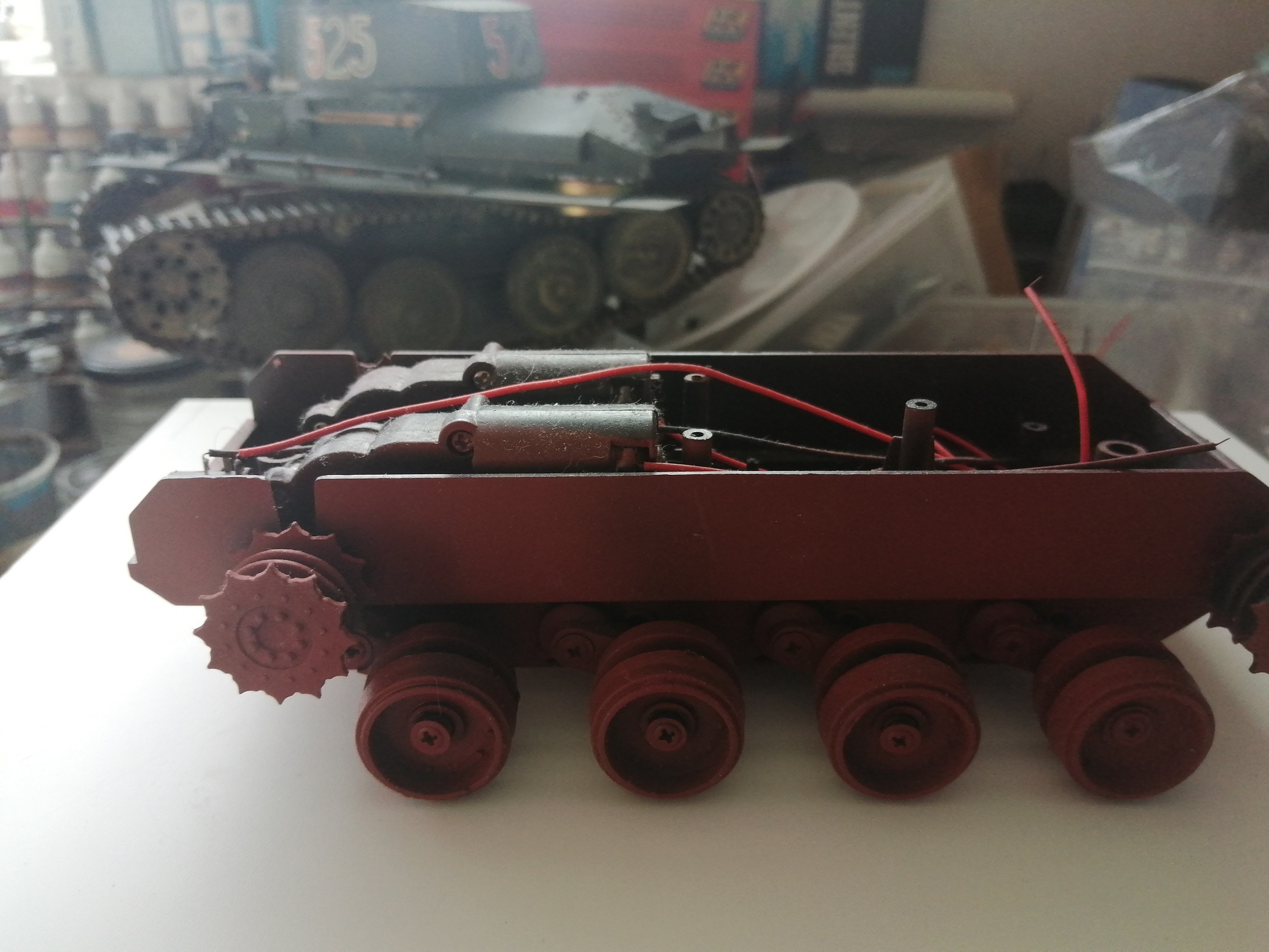

Sometime ago I bought a couple of these tracked chassis, intending to break one use one for this build.

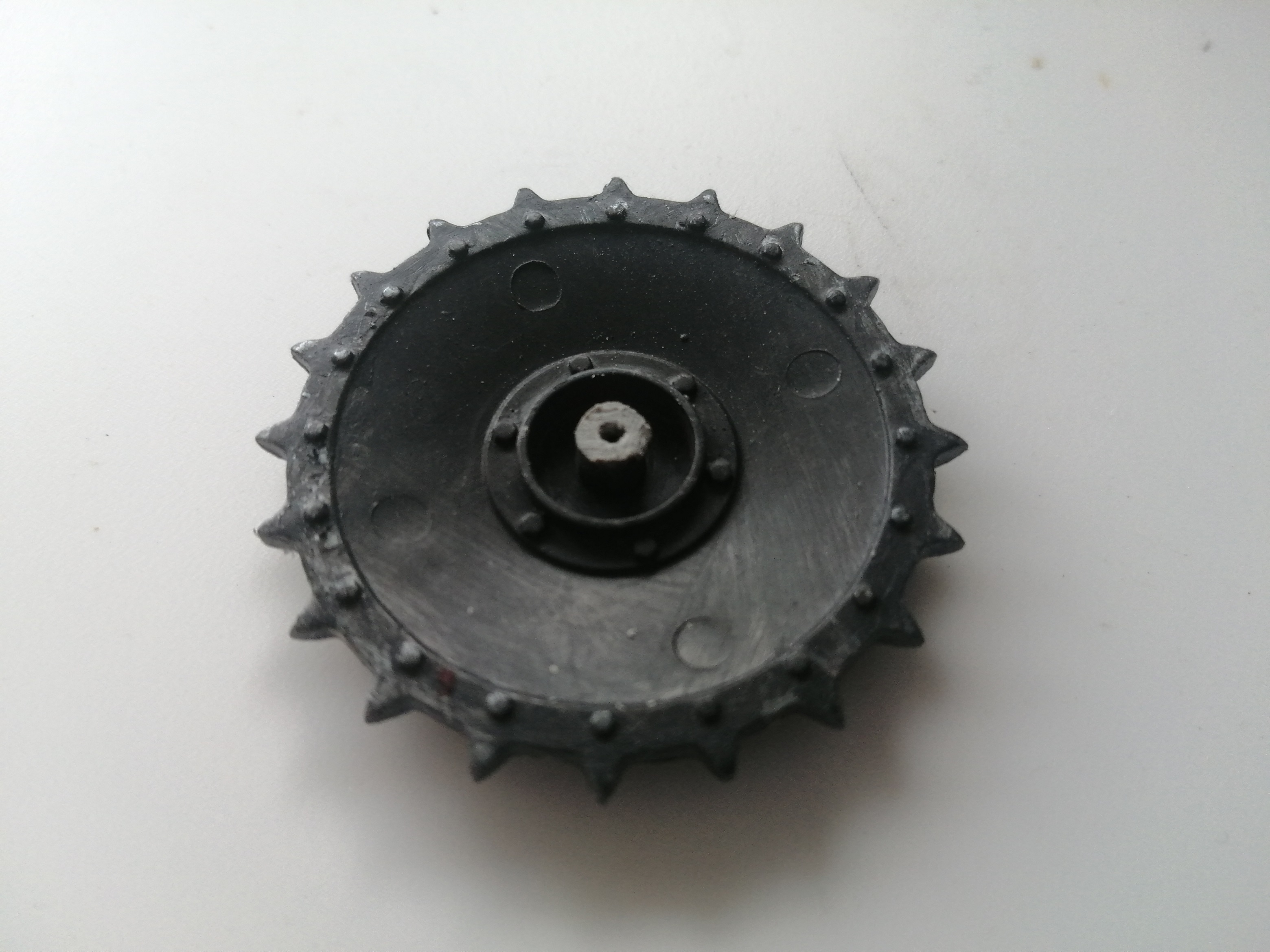

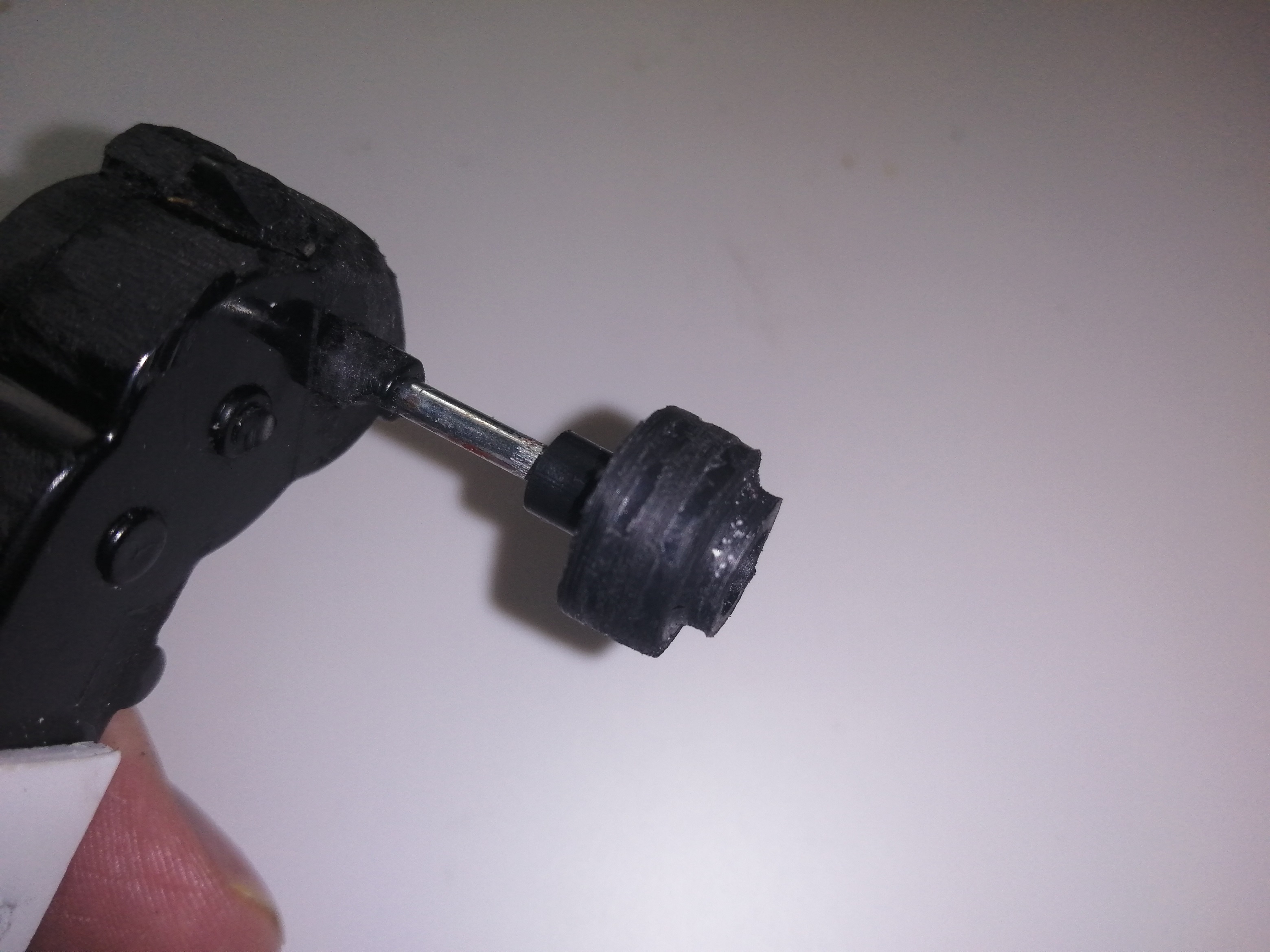

The gearboxes and the drive sprockets are the only parts required. The drive sprocket from the kit was cut down by shortening the shaft.
Not being confident of being able to centre the actual drive sprocket as Louis did, instead, I first drilled the sprocket to accept the stub axle of the kit, then turned down the sprocket from the chassis so that it fitted inside the flange on the kit sprocket. That way, it is perfectly centred.
