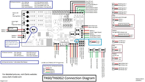

Another question; what is the output voltage for the LED Lighting at the "L" connectors on the TK60G2?

Hello,
Personally, I would say that voltage ditto as original HL, since TK intended to replace an RX 18,
according to the attached diagram, there seems to be an R of 200 homs on L4 and or
connection diagram
http://www.clark-model.com/eng/prod_rx60/index.html
connection diagram

Thank you sir,
Yep, got all that but I can't find where it references the output of L1-L8.
Is it 3v, 5v, 12v or 5v-12v?
Barry
Barry
