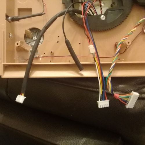

Hi... I'm having problems getting the recoil to work properly on my IBU2 ultimate full option board.. It goes back but doesn't come all the way out. The next fire make barrel come all the way out and stops there.. If I plug in the single wire to the negative contact the recoil goes off all on its own and keeps going till I unplug the wire again. Has anybody any ideas... If possible could someone run me through where the wires in the picture plug into on the IBU2 ultimate full option..TIA.

Hi Colin,
Assuming you have a mechanical recoil and not the airsoft unit :
The black single wire should be connected, if as you said the recoil wont stop the issue probably come from the EOT microswitch.
The setting on ibu2u.ini file as per line below :
;Mechanical recoil/airsoft setup
MrType=0;0=mechanical recoil, 1=mechanical airsoft
MrPulseTime=500;Duration recoil pulse, minimum value 100, maximum value 9999 (milliseconds) used only for recoil type 0
Allow to set the pulse time in recoil mode
If you have the airsof unit you only have to set MrType line to 1
Let me know...
Ivano
Let me know...
Ivano

Cheers guys for the answers. I went with theibumans suggestion and it worked.. Thankyou....
Re: Taigen recoil
Hi Colin,
Fine, glad you fixed the issue but, (just in order to help other forum users who may run into same thing), which was the problem ?
Thanks
Ivano
Thanks
Ivano
Re: Taigen recoil
Hi.... In the ini file it was setup as airsoft unit .Changed it to mechanical and away it went.... Thanks again....
