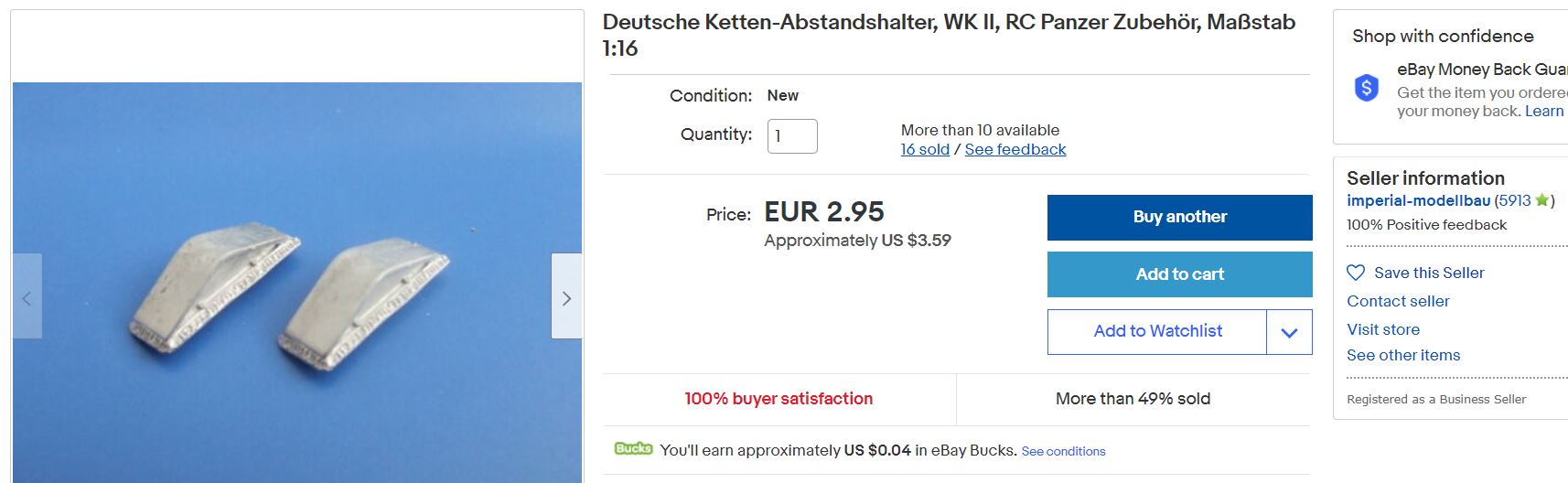

View of the Hummel track adjuster. Notice the presence of a device to push loose track pins back inside the track as the tank advances or back up, its called a Ketten-Abstandshalter, something i have only seen on the Hummel and Nashorn.
RC 1/16 Sd.Kfz. 165 Hummel Late Production - Build
This device is on sale from a seller on eBay Germany. For the cost, it saves a lot of scratchbuilding time.

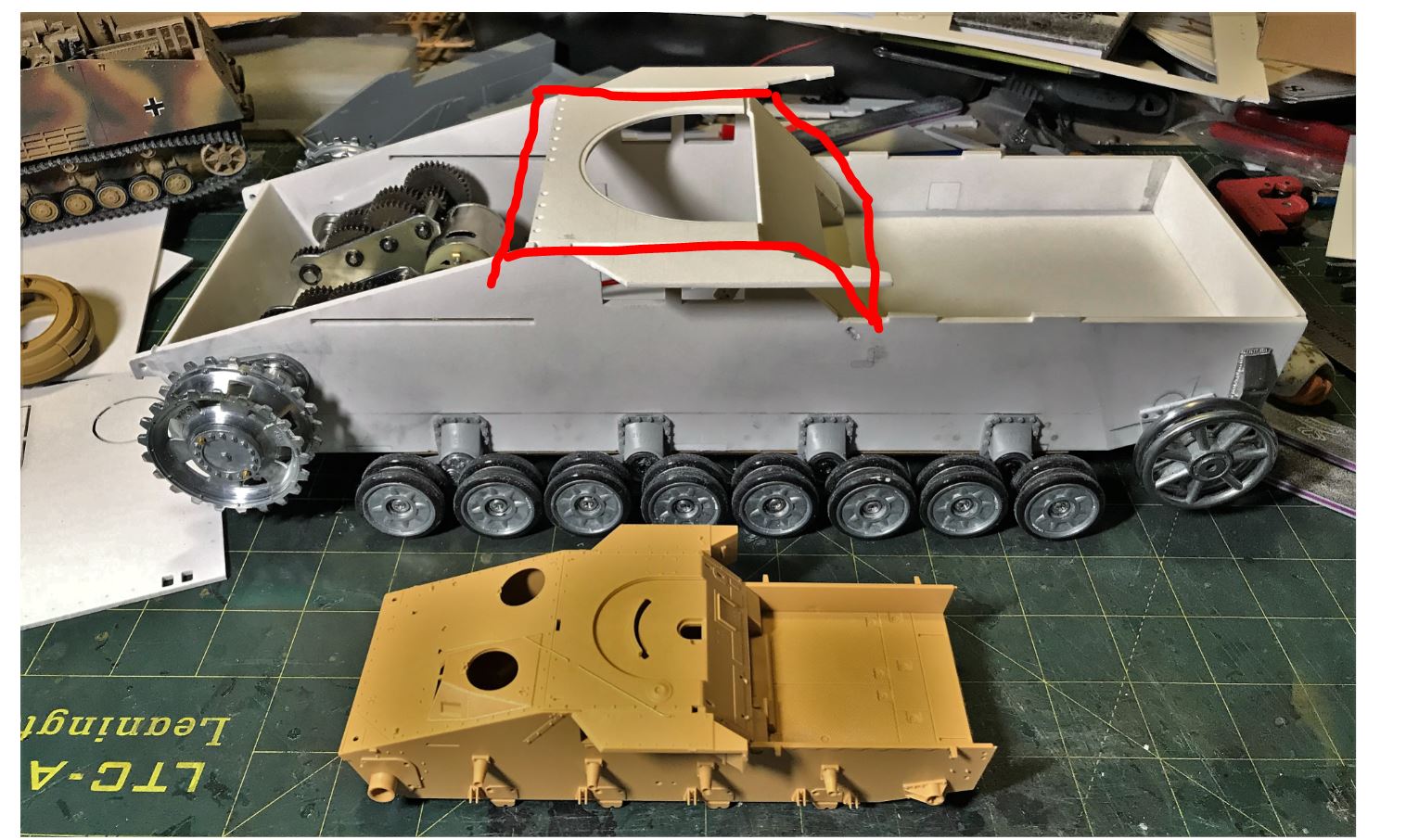

This post is for the howitzer platform.
View of the Tamiya early production hummel. What is of interest here is the howitzer platform for the mount and the floor of the fighting compartment for the crew. Lots of details that will be reproduced later. Notice the lozenge style tread plates. Measurements are taken to verify the Ludwig dimensions. Ludwig dimensions are usually very good but because the floor was 9mm to high (corrected yesterday), i had strong suspicions of other issues.

Now, let's see the situation. It does not take long to notice a major problem. The gun platform is short by 14.3mm compared to the Tamiya dimensions extrapolated to 1/16. I do not mind 1 to 3mm but 14.3mm, that won't go unnoticed. You can actually see the issue and gap just by eyeballing it. It would likely be an issue mounting the gun as well. After some analysis, it needs to be extended at the front and rear. I am noticing that the angle of the glacis is too small so the extension at the front will solve this issue at the same time. The fighting compartment is 9.3mm to long, so extending the gun platform towards the rear will resolve some of it. Humm, i am not happy, Ludwig kit dimensions are usually better than this. I will take time to correct this, something that could have been easily avoided.
An extension of 6.5mm is created for the front. A beam made of 4mm thick plasticard is placed underneath to reinforce the platform.

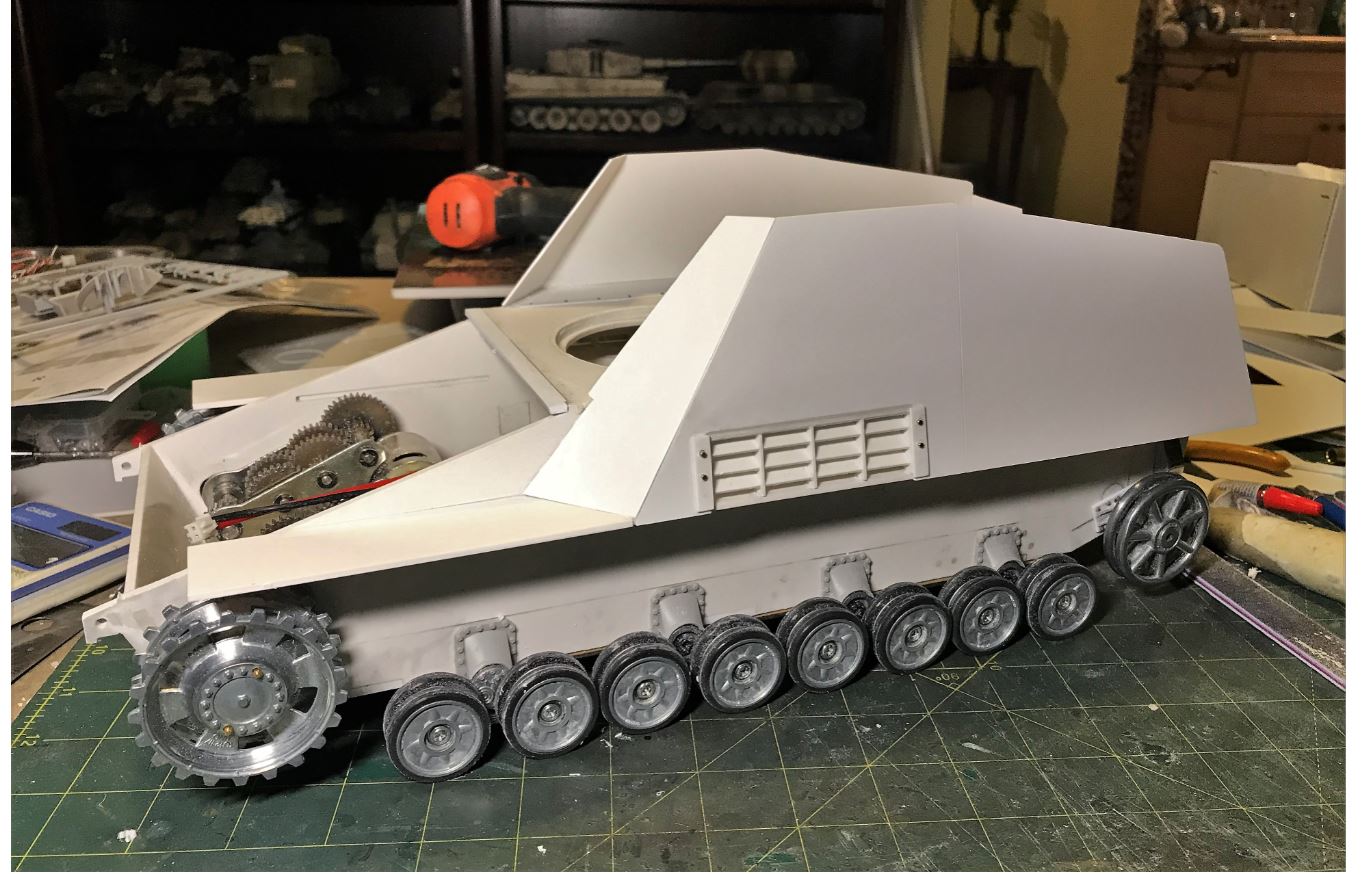

Next step, the armor plates of the fighting compartment.
Regards, Louis
Re: RC 1/16 Sd.Kfz. 165 Hummel Late Production - Build
This post is for the armor of the fighting compartment.
As seen in reference pictures, the Hummel and Nashorn side armor was only 10mm thick, good enough to protect only against small arms fire and shrapnel, and no protection against airburst.

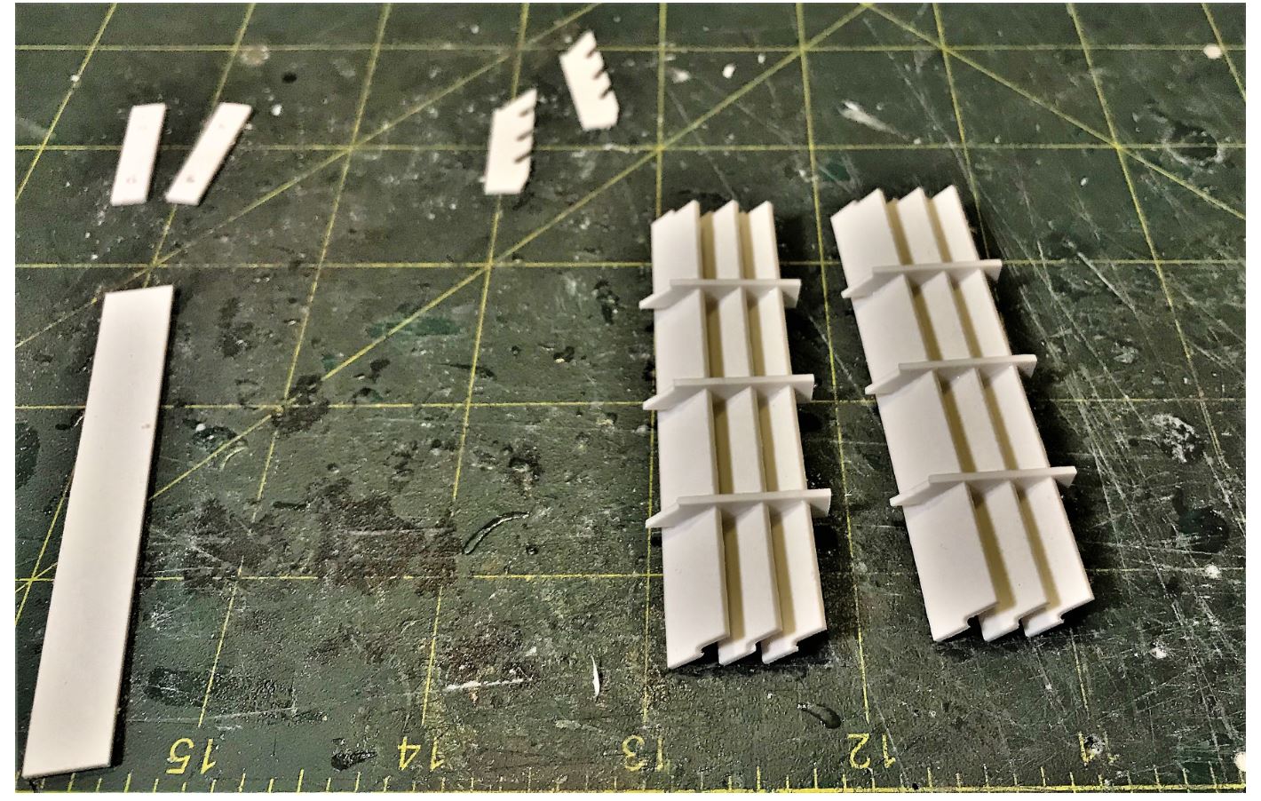

Although a 0.75mm plasticard thickness would have been closer to represent the 10mm of armor, i found it too weak. I opted for a 1mm plasticard, good resistance and which also facilitates the calculations for the required adjustments. To go from 2mm to 1mm plasticard, 1mm was added to the interior sections as the 1mm removed from the armor is given to the overall interior of the vehicle, and as the armor will envelop the fenders, 1mm is removed from them and then given the required angle.
The dimensions of the kit 2mm thick armor sections are excellent and make perfect stencils for the new 1mm thick armor. The kit parts are applied against a 1mm sheet of plasticard with a couple of small drops of superglue and the parts are cut. The new armor is created in minutes.

The armor plates are installed, perfect fit.

View inside the air intakes. By removing the brackets seen between the two holes, i will be able to squeeze in a small speaker on both sides.

Overview of the model as it stands today

These are the air intake parts provided in the kit. Looking good. No assembly instructions are provided but it takes about 1 minutes to figure out.
Straitforward assembly, no issues.

The resulting parts are impressive. They are a perfect match with the references. When i recall the difficult efforts of cleaning the air intake resin parts on the Juckenburg Nashorn kit, this step is clean, easy and results are excellent.

Some minor adjustments are required to install them. The armor above the air intake was 1mm short so i had to put a plasticard to brigde the gap, and then sand and polished for a seamless finish. This gap also exists on the unused Ludwig armor plate, so the mistake comes from there. To anyone doing the same 1mm thick armor as me, you should leave 1mm of extra armor above the air intake before cutting the part.

Now that the air intakes are in place, i decided to permanently glue the frontal side armor panel to seal that area. When compared to the pictures of the real one, i think this is as close as it can get.

The model as it stands right now. The Hummel is taking shape.
