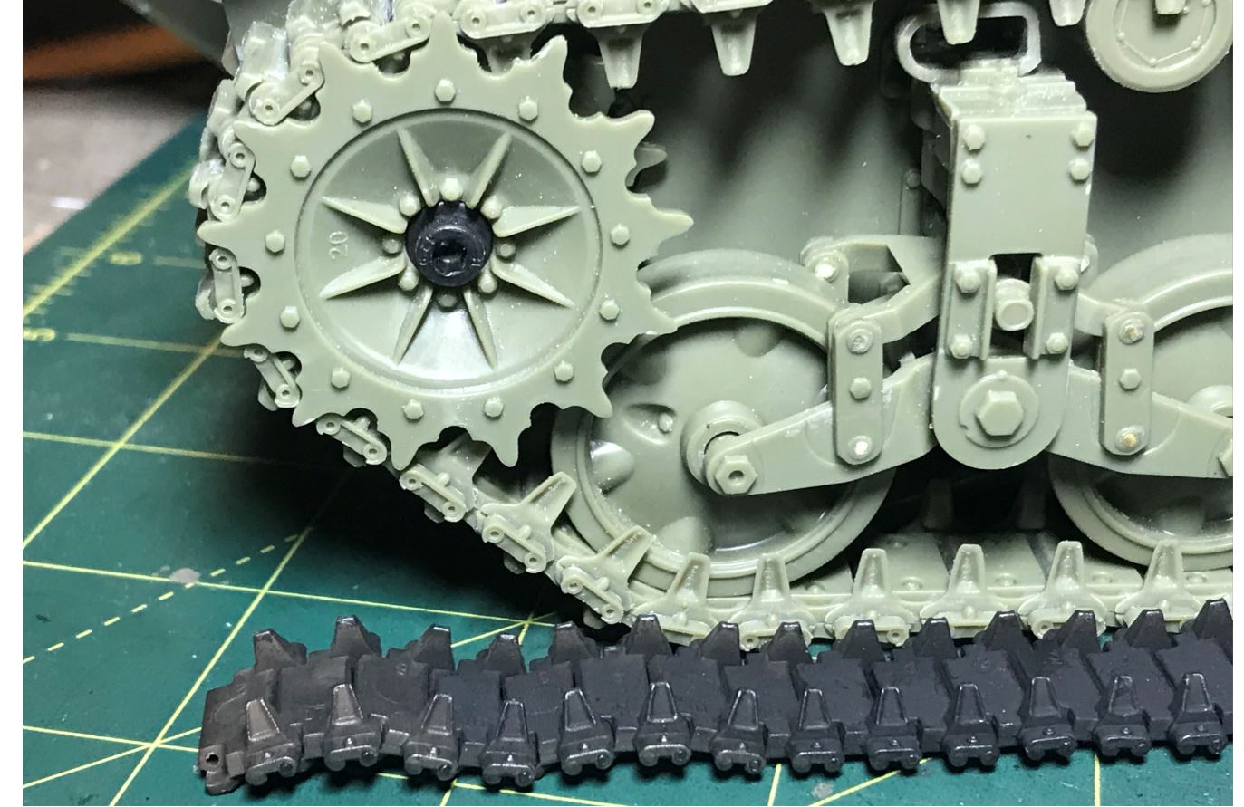

Exhibitedbrute wrote:I have a question. As the tracks appear to be roughly half the size of Sherman tracks what about something in a smaller scale like tamiya metal 1/35 Sherman tracks perhaps?
Good thinking, i had exactly the same thought last week. I have some leftover 1/24 VS M4 Sherman hard tracks from the BMP-1 build. As you can see below, there are a bit narrower with the wrong chevron but the main issue is the overall size of the connector pins and teeth, too small and not matching the sprocket. And i had a really hard time designing a BMP-1 sprocket for them. But of course, with a 3D designed and printed sprocket, they could be used, but won't look good in my views. And they are also long discontinued and extremely difficult to find.

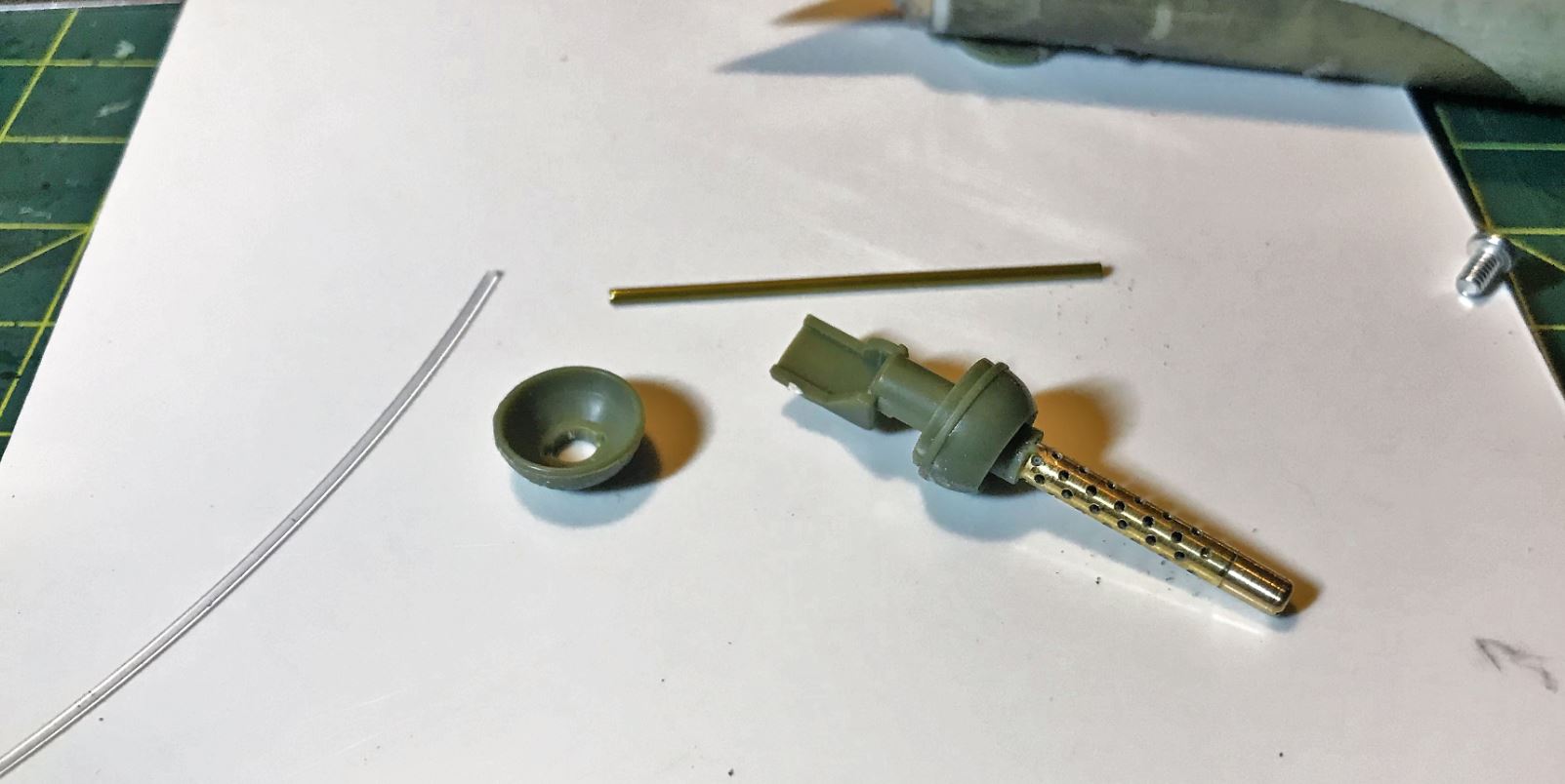

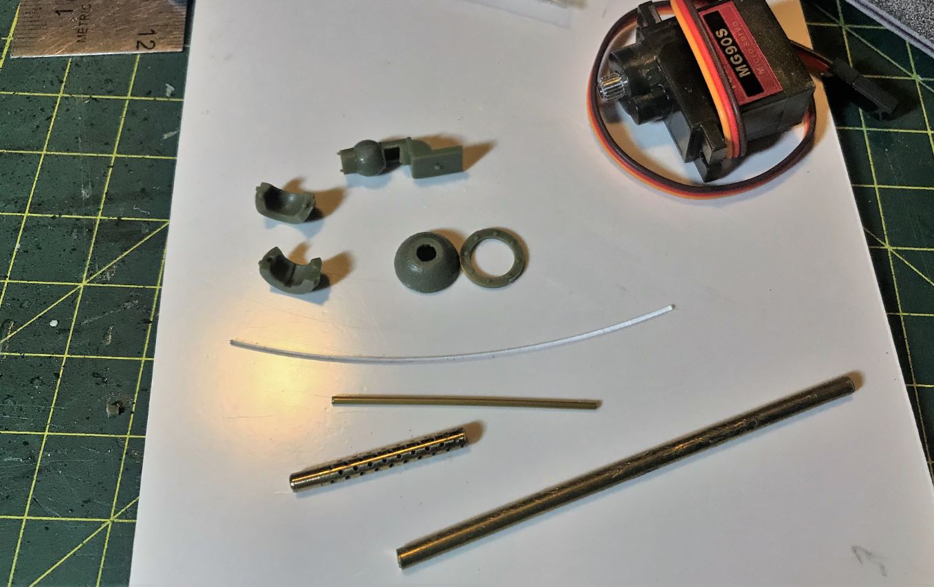

Continuing with the build, here is the bow Browning M1919 machine gun.
Kit and Aber parts are assembled for the build with fiber optics for a similar arrangement used on the turret Browning, and a micro servo.
1/16 RC M5A1 Stuart Light tank - build
The Aber barrel is installed on the kit mount which is allowing for movement.

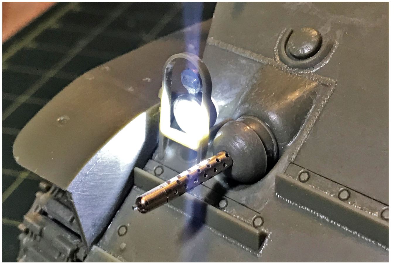

The fiber, LED and brass tube barrel are connected. Notice that the plastic of the LED has been drilled a few mm (without touching the element) and the brass/fibre are inserted and glued inside the LED for a more direct and solid connection for the flash.
The bow machine gun is mounted on the hull. The LED is taking the place of the complete and nicely molded kit M1919 Browning MG that will see better use on a future build exposed outside.

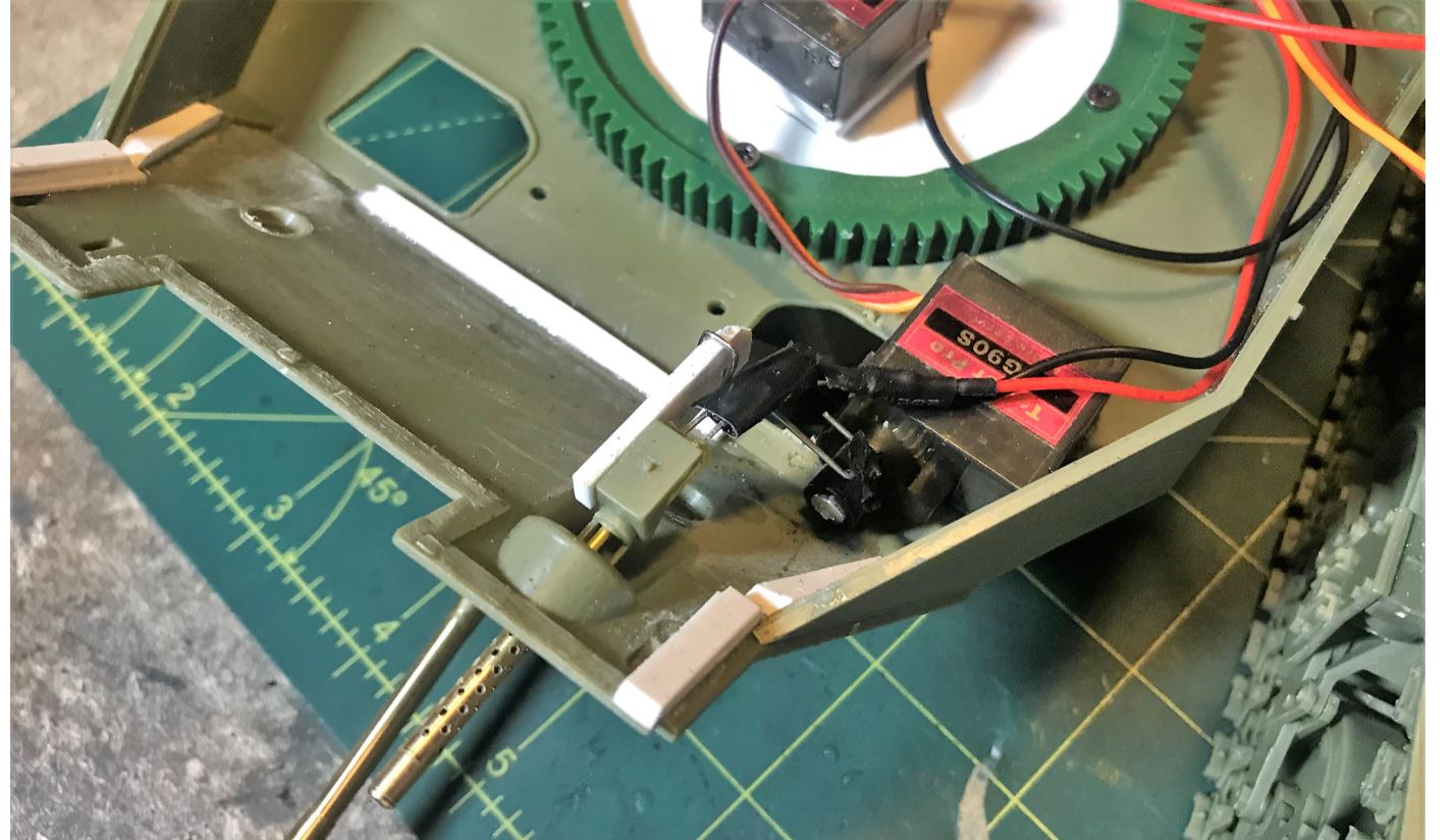

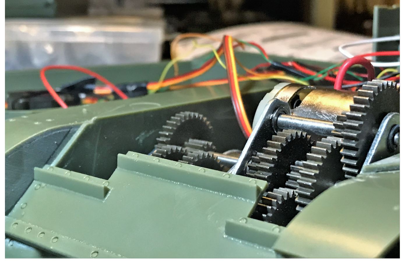

The use of MATO low panzer III gearbox leaves some empty space on the right side of the hull that is usually not available on a Sherman with Sherman gears.
I took the opportunity to design a simple gizmo connection of the MG mount to a micro servo in order to create some movement. This was done in 20 minutes without much planning. A plasticard is glued to the MG mount, and a metal wire connects the servo arm to the MG mount for some irregular left, right, down movement like a wanted. It does work. I am providing a short video on the next post.
The bow machine gun servo is connected directly to an available channel on the receiver and assigned to one of the knob switch.

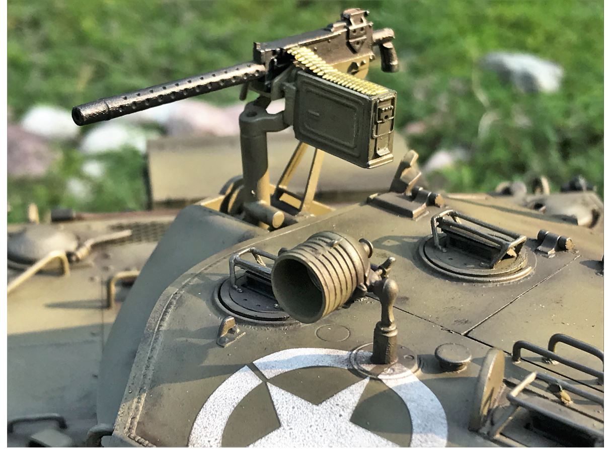

The finalized Stuart Browning bow machine gun. Casting and markings are exceptional.

It is a shame about the tracks, if the pins and connectors matched the would suit the early version with rubber pads, but the stock tracks look like they hold up pretty well

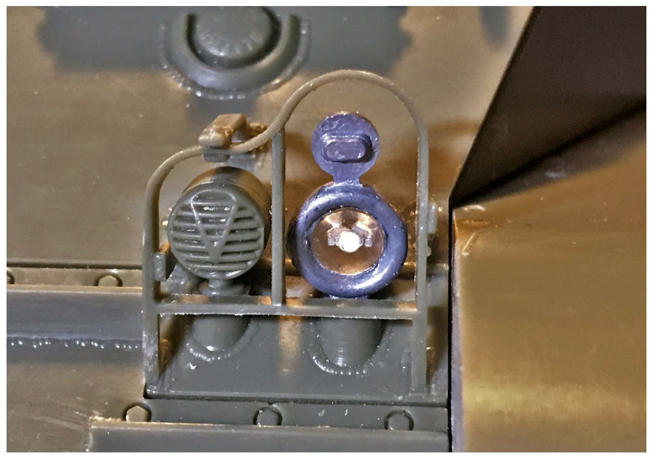

The kit plastic headlights are easily replaced by MATO Sherman metal headlights with LEDs, they are the same as the Stuart.

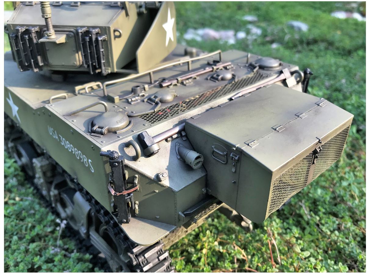

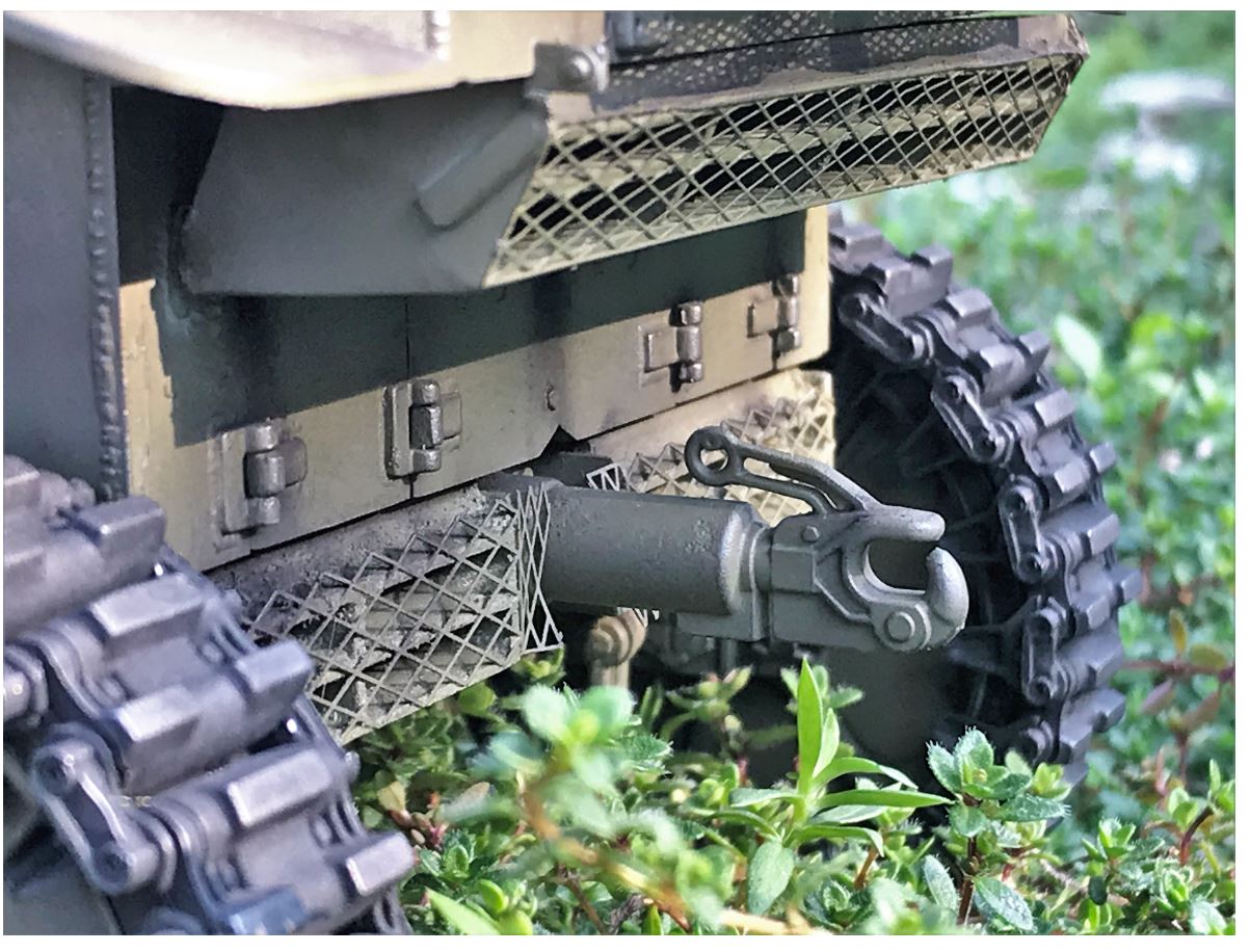

All the grills at the back are a real pain to install. They are made of extremely thin and weak Photo-etching. The designer did not provide any support for them. They will be ripped and destroyed by simply touching them with light pressure, not great for RC. As this is a "kit", i gave it a try to position them the best i could. For heavy RC users, I would recommend filling the holes with a plasticard support and then glue the grill on top, like Heng Long, Tamiya and others would have likely done.
The big box at the back is a storage bin for the crew, added to M5A1 late model to help the crew with the lack of interior storage space. Touch the grills and they will be ripped off... But they look very good as a static display. Putting them on is a most frustrating experience because they hold by the edge of the PE part with no plastic support at all. Do this with superglue on your fingers and the PE parts not holding in place, it gets ugly real fast. Same story for the exhaust grills. The grills should have been made of thicker PE brass, and with some gluing lines on the plastic.

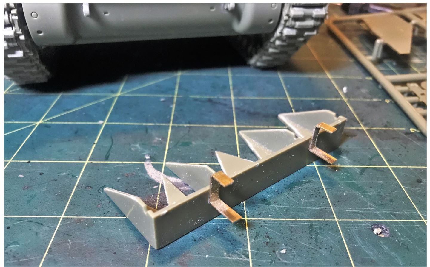

This is the Culin hedgerow cutter coming with the kit, a nice optional feature. The brackets were redone in brass for more solidity because it will surely receive some hits.

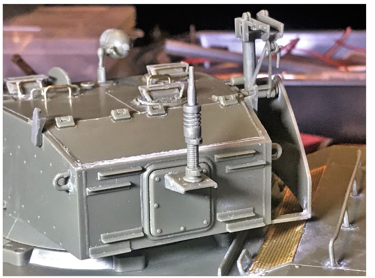

The turret periscope guards are as exciting to assemble as the ones at the front. The mount parts for the larger periscope on the turret left are so tiny, i could not even hold them with my fingers or pliers trying to clean and prepare them.
The were easily replaced with 1mm brass rods with anchor going into the armor.

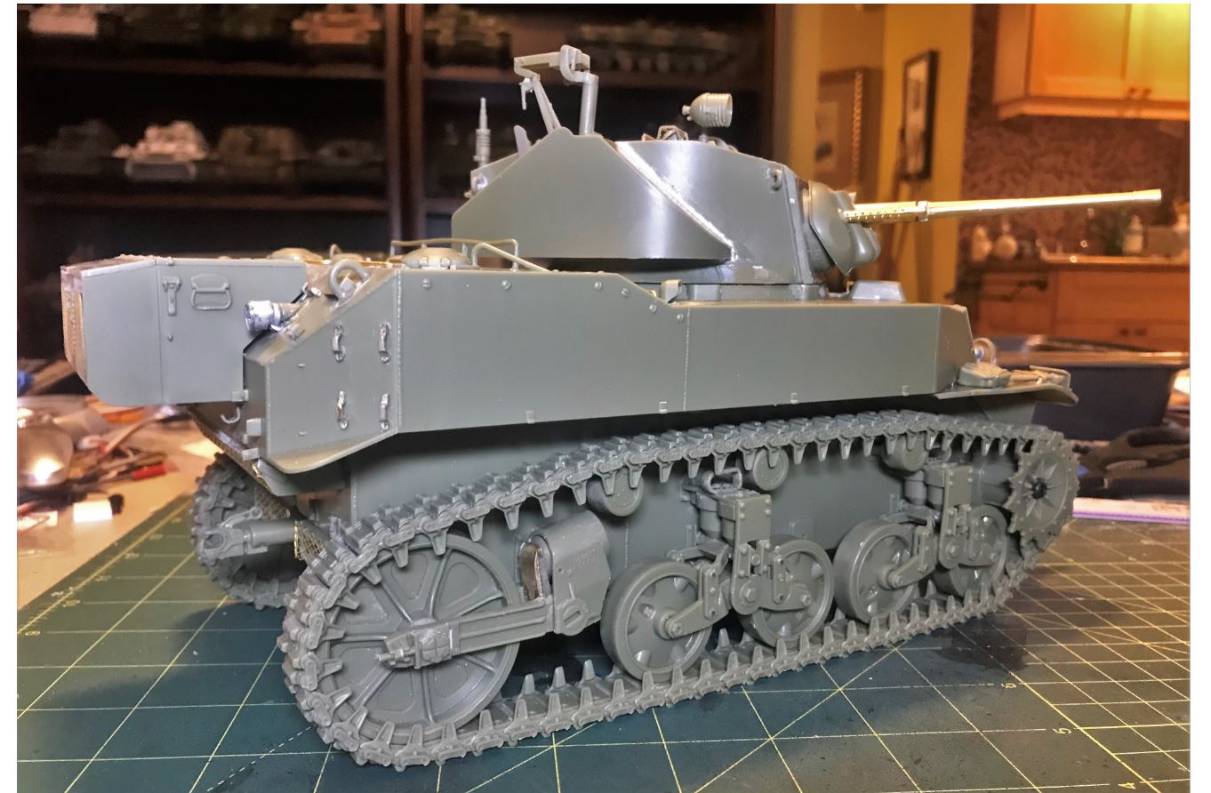

Here is the model as it stands today prior to painting.

The Culin hedgerow cutter, a field modification made during the Normandy battle to plow through thick hedgerow bushes, is a cool addition to a rather small vehicle, making it look a bit more aggressive than it actually is.
With metal tracks, suspension, sharper edges and stronger attachment points, it would be tempting to try the hedgerow cutter in the wife's backyard garden. But it would surely create a mess no matter what.

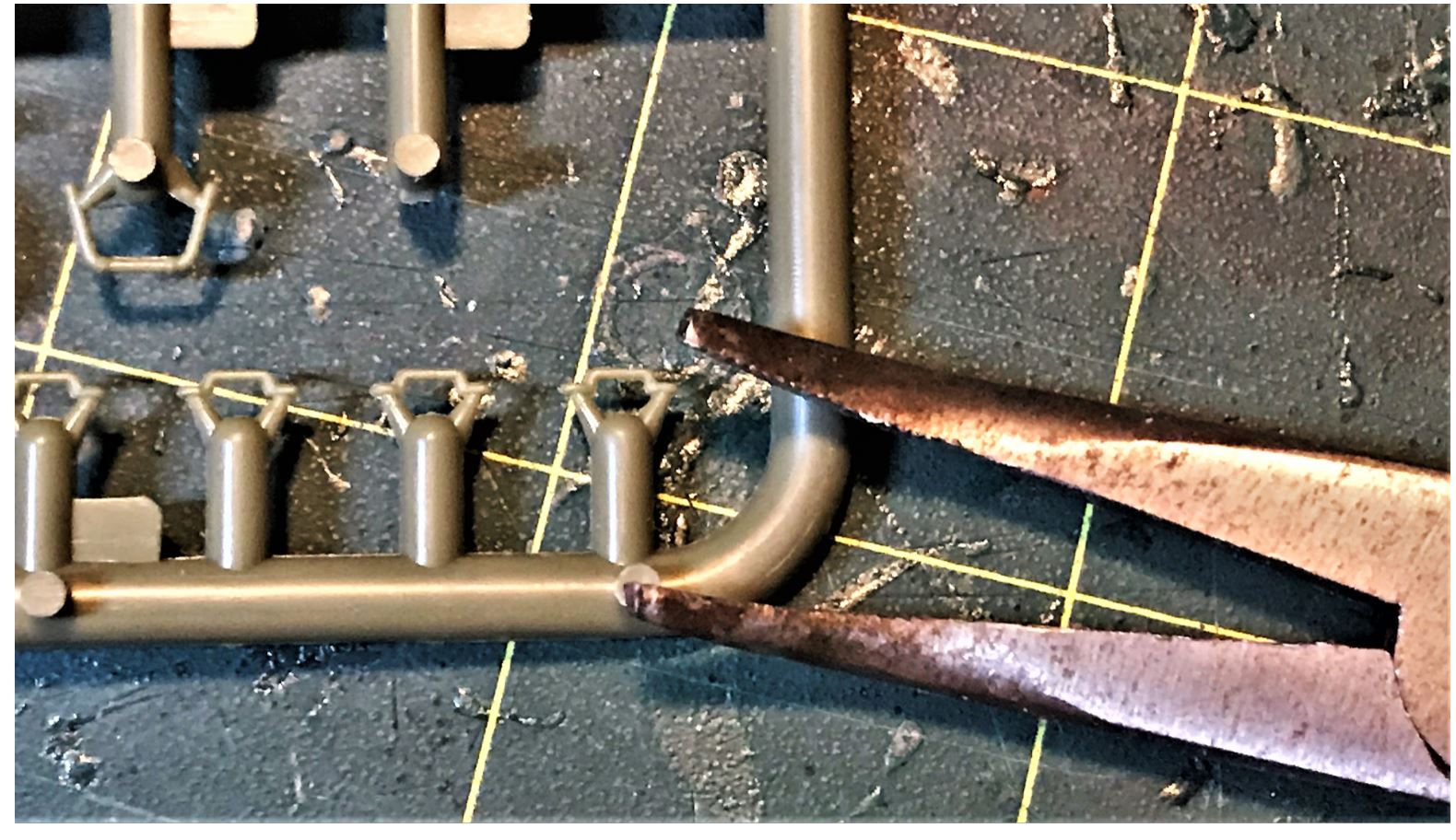

All the tiny, minuscule and fragile plastic tie downs were replaced by ones from AFV Model in metal. They are a little bit larger than normal. I did file them to reduce their aspect but i least i can see them and put them on with my pliers. The tie downs are required because all the tools are held in place with PE straps between tie downs. The kit plastic tie downs below are very small and weak, great for static model but touch them while lifting the upper hull to put in the battery and they break right away.

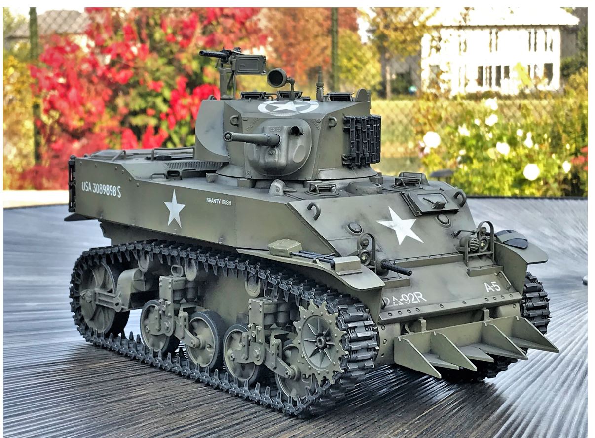

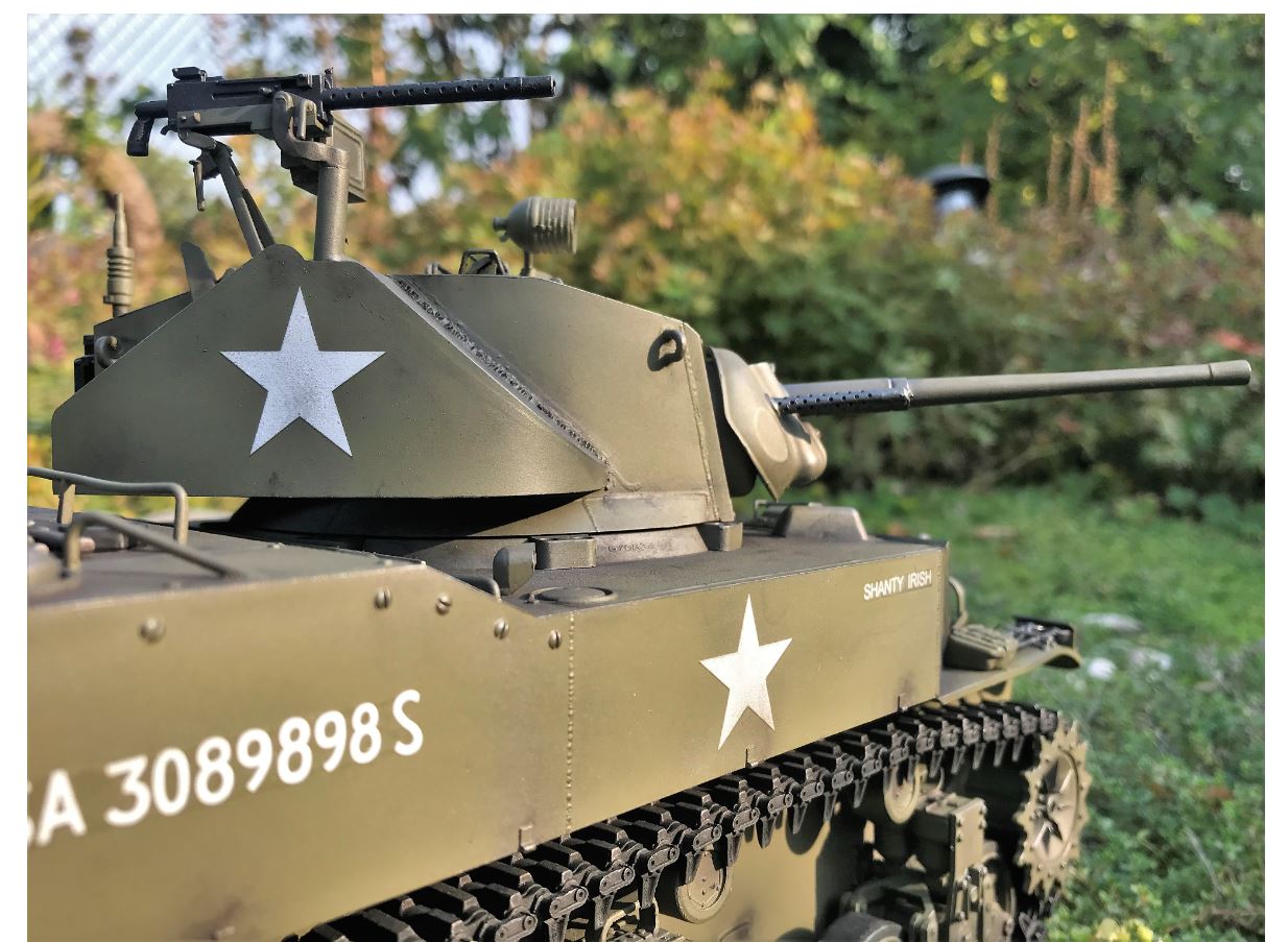

The RC M5A1 model is finished. I painted it with Vallejo Olive drab, and then with an application of black pigments in low areas, and then dry brushed with dark steel pigments. It took about 3 hours. I wanted this one to be really cute and clean so no dirt, dust or mud.. The only issue i encountered is when i discovered that Vallejo primer does not hold on metal (!!!), so i had to peal the Vallejo paint off the barrel and headlights and redo these areas with Tamiya Olive drab. It was a small shock when i noticed the Vallejo paint falling off the brass barrel... I will be careful in the future.
So, here is an extensive tank porn photoshoot of the M5A1, with a Youtube video of the model in action at the end of the last post. At this time, it seems to be a rare sight on the web as i could not find other 1/16 conversions. The high number of parts may turn off many RC enthusiast, but then, that's the price to pay to have an M5A1 Stuart on inventory. Hope there will be more soon. Get to work guys. Its worth it.
