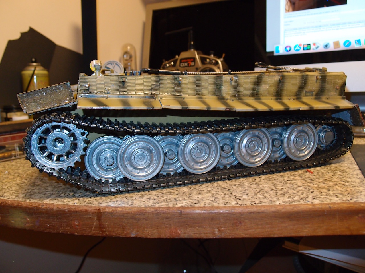

Some stuff from Forgebear, might try and find better late wheels and idlers as these ones have no bearings. Can use them on the HOBBY BOSS tiger if i find some. Thats this build stalled again, gives me time to sort out the new gearbox.

Tiger 1 late wheels , a mate drilled out the wheels and idlers for IGUS sleeve bearings . Smoother now that its not metal on metal.

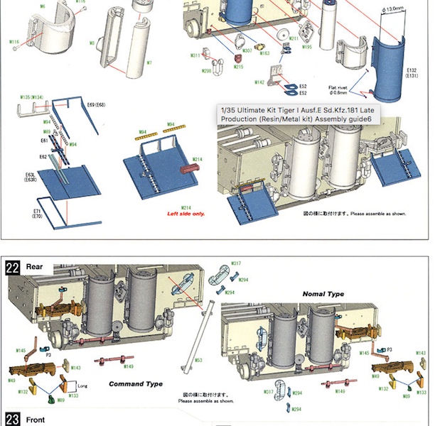

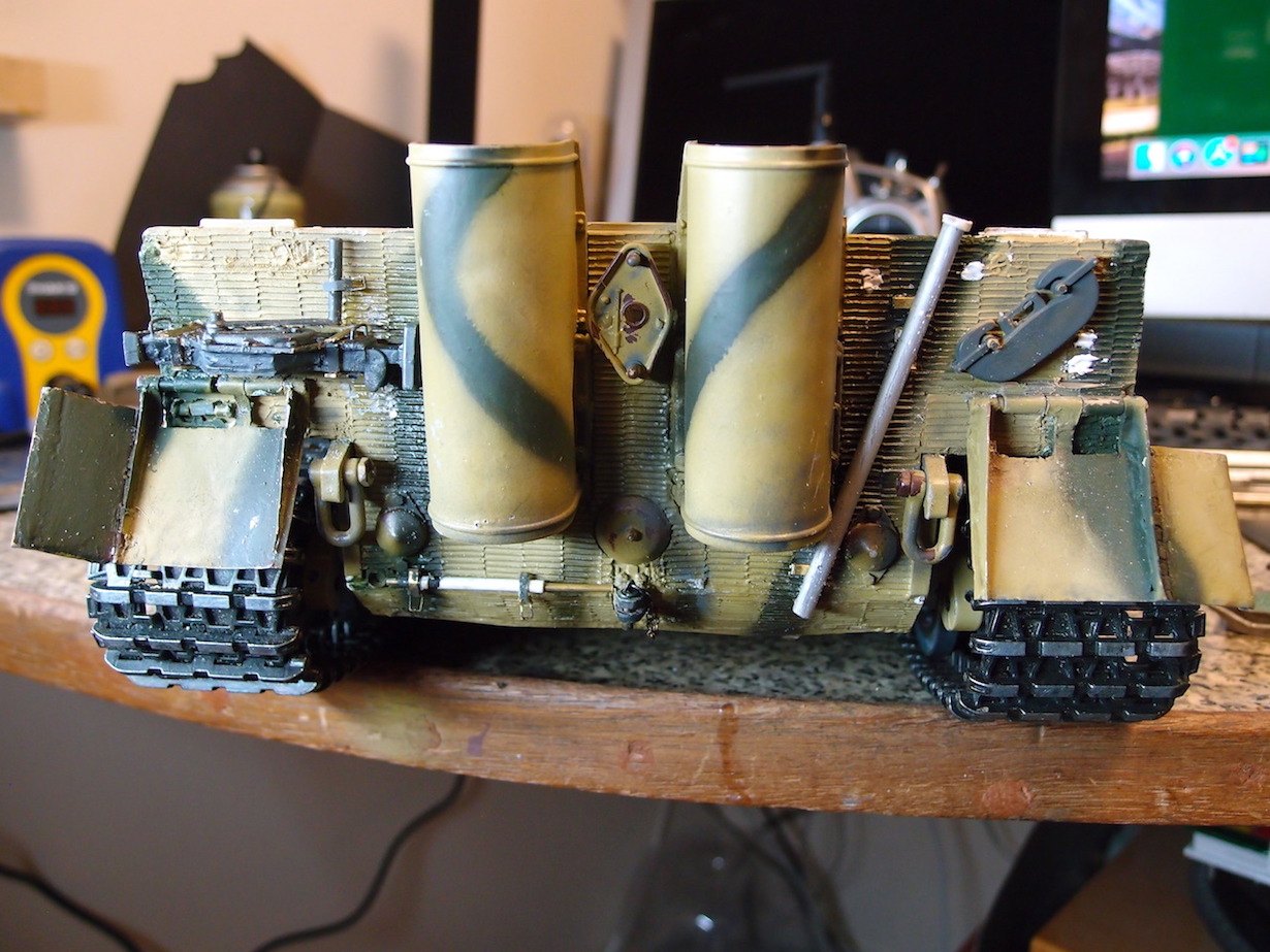

Back onto this one. Late wheels fitted with bearings, late sprockets and idles, fixed the low front end , remade the track puller. I might need to rework the rear as its wrong for a command tank.Its remove extra aerial or just fit the aerial tube on where i can fit it.

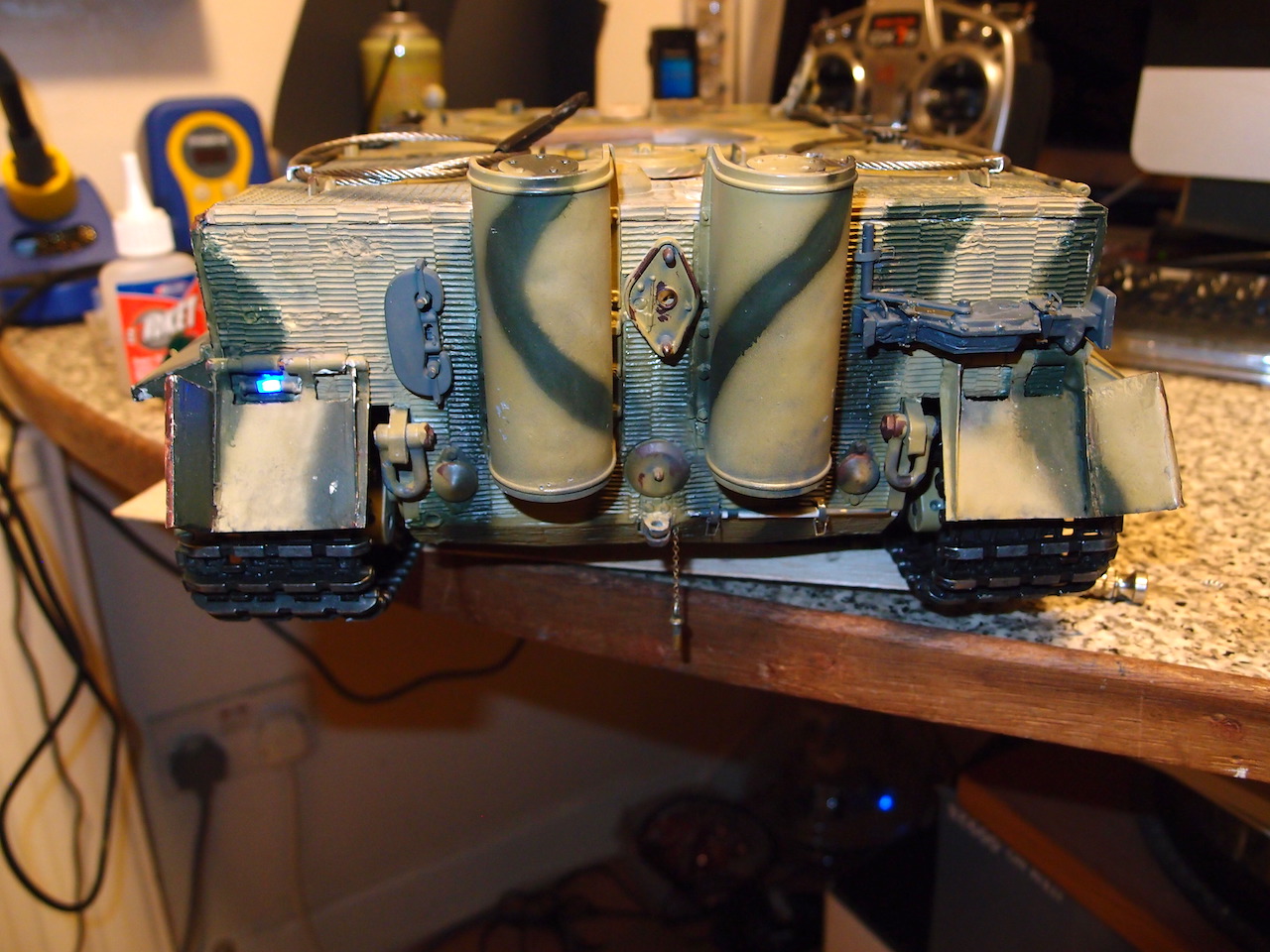

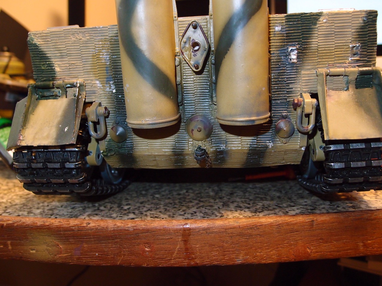

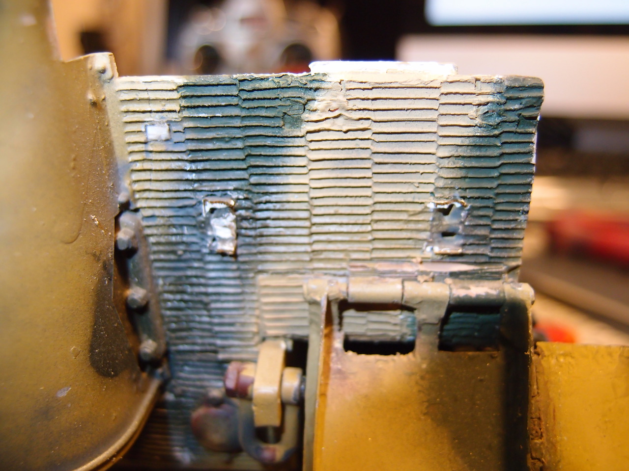

Well lets start again , easier to rearrange the tools on the rear plate than remove aerial and fill the hole.
Re: Torro/Taigen kit Tiger
Fixed the rear plate tool positions, found another pic for aerial tube it gives a rough idea dimensions . Thats the lower hull sorted unless i find another fix

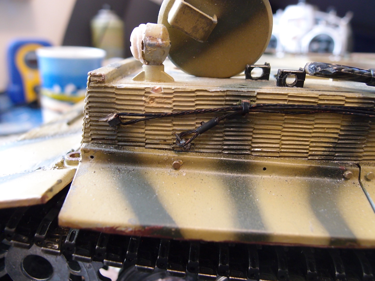

Track puller cable done, cant find a nice steel cable . Brass wire done with Brass black, not very good as i think the wire has a clear lacquer . Paint should help to sort it out after another ZIM touchup or chip some off as damage..

some pics
Very slick work mate,
