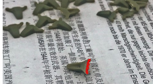

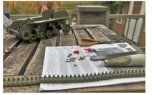

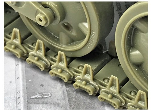

Each tracks takes about 4 hours to built. They must be made workable with each link requiring close attention when gluing. Care must be made to prevent any glue from touching the connector pins. The first 10 links are the most difficult to put together, after that, a routine sets in and its easier. I suggest adding the connector teeth on one side at a time so that by the time you do the other side, the previous one has dried and stronger. Everything is assembled with superglue.
1/16 RC M5A1 Stuart Light tank - build
Adding the teeth is tricky. I suggest putting glue only on the exterior side because any glue that finds its way to a connector pin will seize it and become a major issue requiring its replacement.

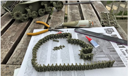

When assembling the tracks, always and constantly go back to the previous 5 links to make sure they are still loose. Once in a while, some superglue from the connector teeth leaks to a connector pin and will prevent it from operating. It is essential to quickly snap it loose as soon as a tight link is found, before the superglue is fully set.
Its not complicated, it just takes time. Put yourself in a mindset that this will take 8 hours of your Covid confined weekend to build these tracks and it will be easier. I went thought it meditating, thinking of former girlfriends, past vacation trips, good stuff like that. And 8 hours is nothing compared to the 25 hours it took to build the AFV-Model Leopard 1 metal tracks a few weeks ago...

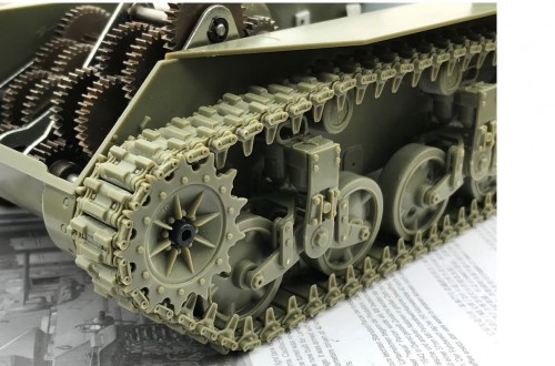

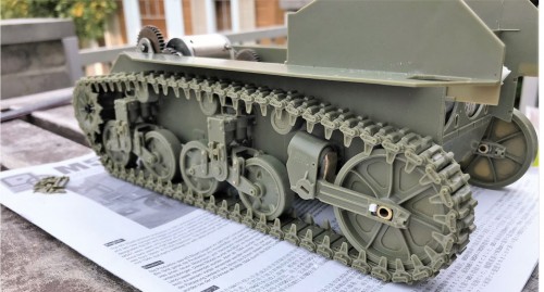

After the first track is completed, i was really encouraged. It looks great and quite strong.

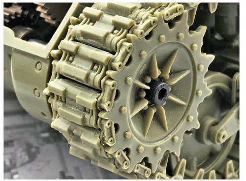

Sprocket looks tight.

The connector teeth are better than i thought they would. They hold in place quite well.

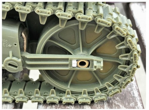

I was really happy to have created a track adjuster. It is absolutely necessary. Its easy to just put a plasticard strip matching the required strength for the tracks. Then the track adjuster cover plate is put on to hide it.

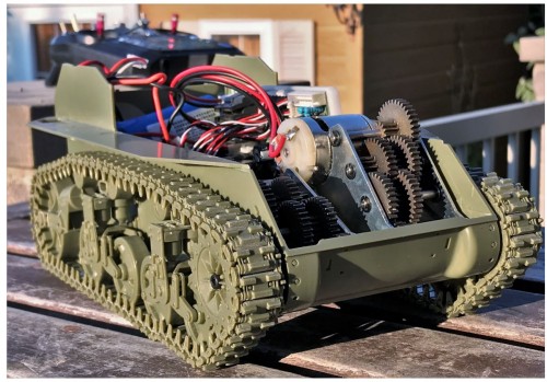

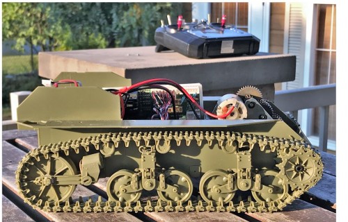

Both tracks are made. The Clark TK-60 board is temporarily connected for the testing phase. I have been waiting for that moment for a week.
Continuing on following post
Re: 1/16 RC M5A1 Stuart Light tank - build
The electronics were simply thrown in for the testing.
NOW, the moment of truth. The RUNNING tests;
Below is a YOUTUBE video of the initial gearbox, sprocket and track testing.
Below is a YOUTUBE video of the running test around the pool deck, with some sharp turns at full speed.
Below is a YOUTUBE video of the suspension and tracks stress test, in slow motion to see it working.
Well, this is it. It is working quite well, a real success. I rate it as; ABOVE EXPECTATIONS
