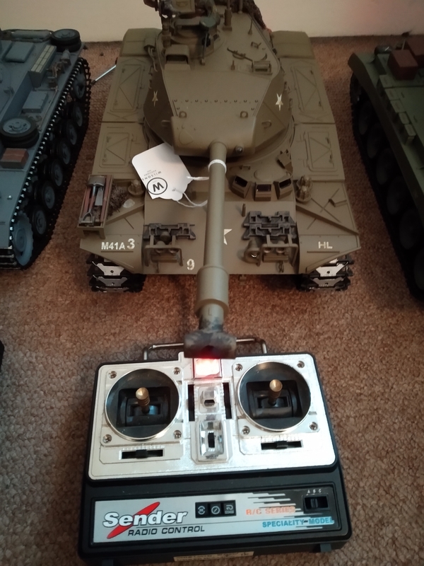

Re: Hi - I need some help my old tanks moving
Yes they have abc symbols
Can you guys help me to bind tank to controller.
Thanks
Thanks
Thats panzer 3 with 1 symbol
The lights are flashing but there is no connections between controller and tank
- img_20200909_184320-1-.jpg (52.88 KiB) Viewed 1454 times
Binding is for 2.4 gig equipment.
You have the older crystal and ABC set ups, they should always be compatible providing both the tank and controllers are the same, as in, both on same letter, or both have same numbered crystal, with the Tx in transmitter/controller, and Rx in the tank.
You said the Pershing also had the number one crystal.grek2000 wrote:Thats panzer 3 with 1 symbol
If that's the case, try using the Pershing controller with the panzer 3. That's providing the panzer 3 has the same number crystal in its battery compartment.
Also, if that is the case about the panzer 3 and the Pershing controllers having the number 01 crystal, it would be a good idea to try the panzer 3 controller with the Pershing, that way we can find out if that controller is working.
