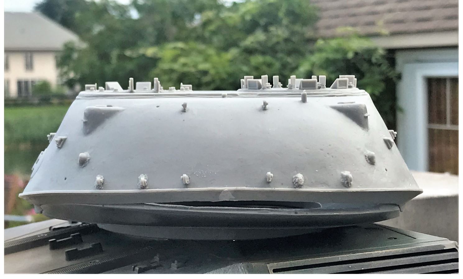

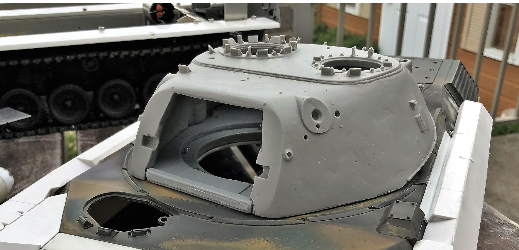

Moving on to the turret in order to work on the integration of the Perfect Scale Modellbau turret to the Tamiya chassis, with rotation, gun elevation and recoil arrangement. None of which comes with the Tamiya chassis or the resin turret.
Looking at the 2 halves of the resin turret, the turret base is not flat and a malformation exists at the back that needs correction. The upper turret have is good.
RC 1/16 Canadian tank Leopard C2 Mexas - Afghanistan - build
Putting the base for 1 minute in the microwave is just enough to warm the resin at a flexible temperature, without being too hot and damaging the resin. My guess is that the timing depends on the power of each microwave so be careful. Taking it out, the base is put on a flat surface to straiten it, and the back is manually folded in place on the upper turret, then it is put in cold water. The small dent at the back that seems like someone pushed a finger in soft resin is a feature that actually exists on the Meng kit and left there.
These are the parts rounded up for the task ahead. Rotation will be with a HL metal rotation unit and a large HL wheel. Gun recoil will be achieved with a DKLM metal unit, with servo elevation. That L7 metal barrel gun is long and heavy, i think the expensive metal DKLM recoil unit is better than a cheap 3D printed unit for the task ahead.
The resin turret base fits correctly in the Tamiya hull. The 2 notch are removed.

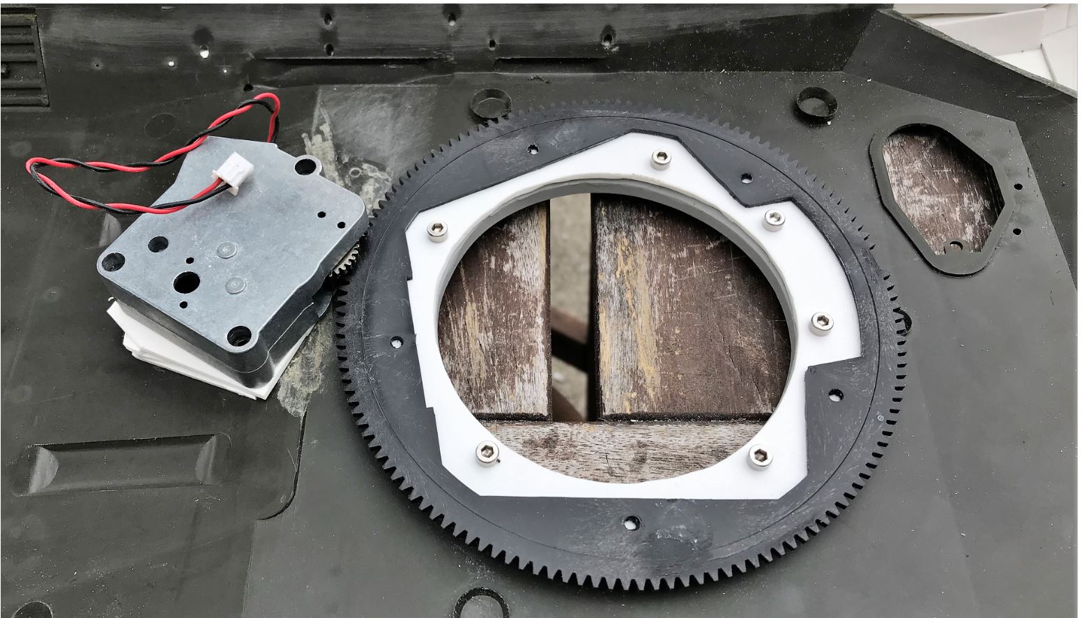

I had a small metal rotation unit in store but it is too small.
Need to use a HL Large rotation wheel, but it is too big...

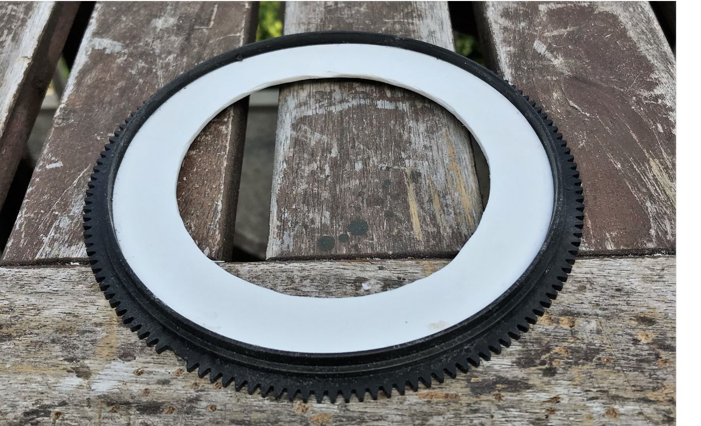

A spacer ring needs to be created in 2mm plasticard to bridge the wheel with the base of the turret.
The ring inner hole is the size of the turret inner hole. The ring is made to fit inside the HL rotation wheel and glued in place. The 2 mm reinforcement rings around each screw hole is removed for a flat base surface to glue the ring on.
After ensuring it is perfectly centered, The wheel is bolted to the resin turret base. A washer was used on bolts in between the two parts to ensure the turret is loose and turns freely. The rotation unit is installed on a custom base behind the turret. It needs to be centered to clear the sides and there is just enough room to clear the Mato motors at the back.
View from above.
Rotation is done, that was fairly simple.

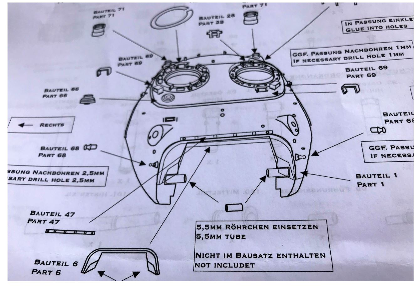

The Perfect Scale Modellbau 1/16 Leopard 1A5 resin turret does not come with much in term of elevation system to build on.
Two notch at the side are advertised for 5.5mm rods. They actually fit a 6mm brass rod.

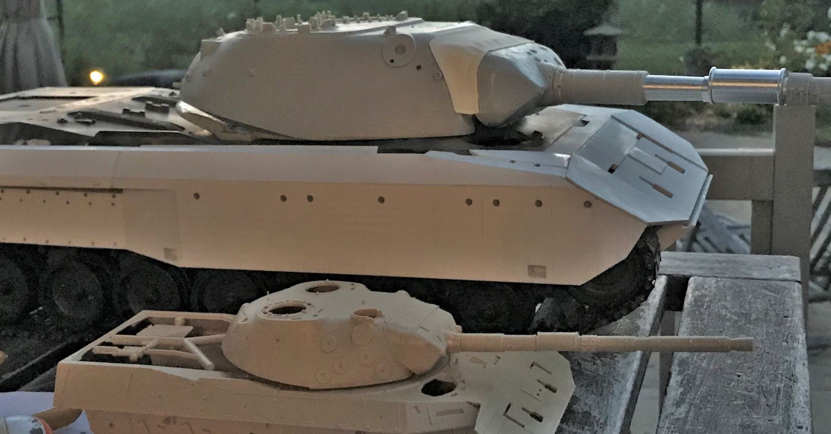

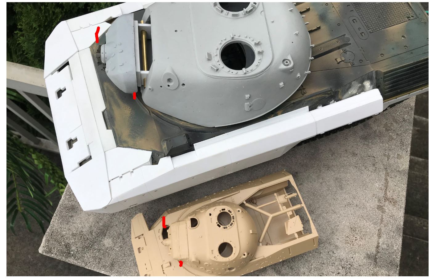

The Perfect scale Modellbau turret size is aligned with the Meng turret. I therefore triangulated the Meng distance between the location points on the mantlet and the turret to determine the spacing for 1/16.
When mounted on the hull, it seems both mantlets end up pretty much at the same location in comparison to the drivers hatch and other markers on the hulls.

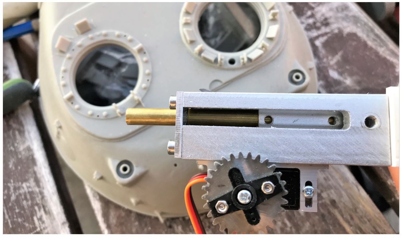

All gun recoil units i have seen are pretty small and made for guns up to 90mm. This is the same situation as what i experienced with the IDF Centurion, the L7 is too large at the root and not long enough anyway to connect to the DKLM metal recoil unit. An extension is made with a 6mm thick brass rod that will fit the recoil unit. The root of the aluminum barrel needs to be drilled a couple of inches to fit the brass tube, that leaves room for the gun flash cables.

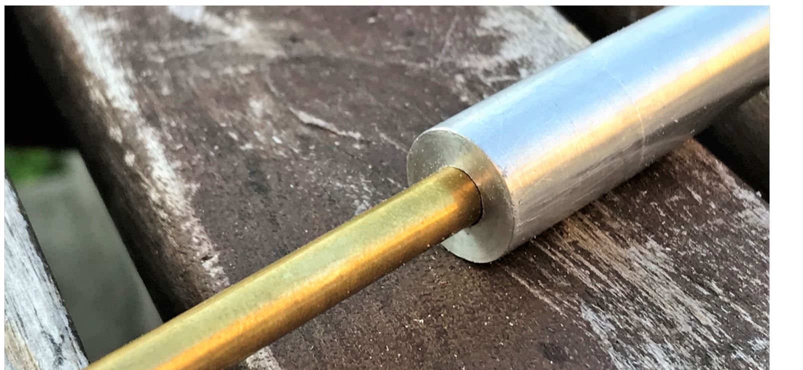

The 6mm thick brass rod is inserted. I did not even need to glue it.

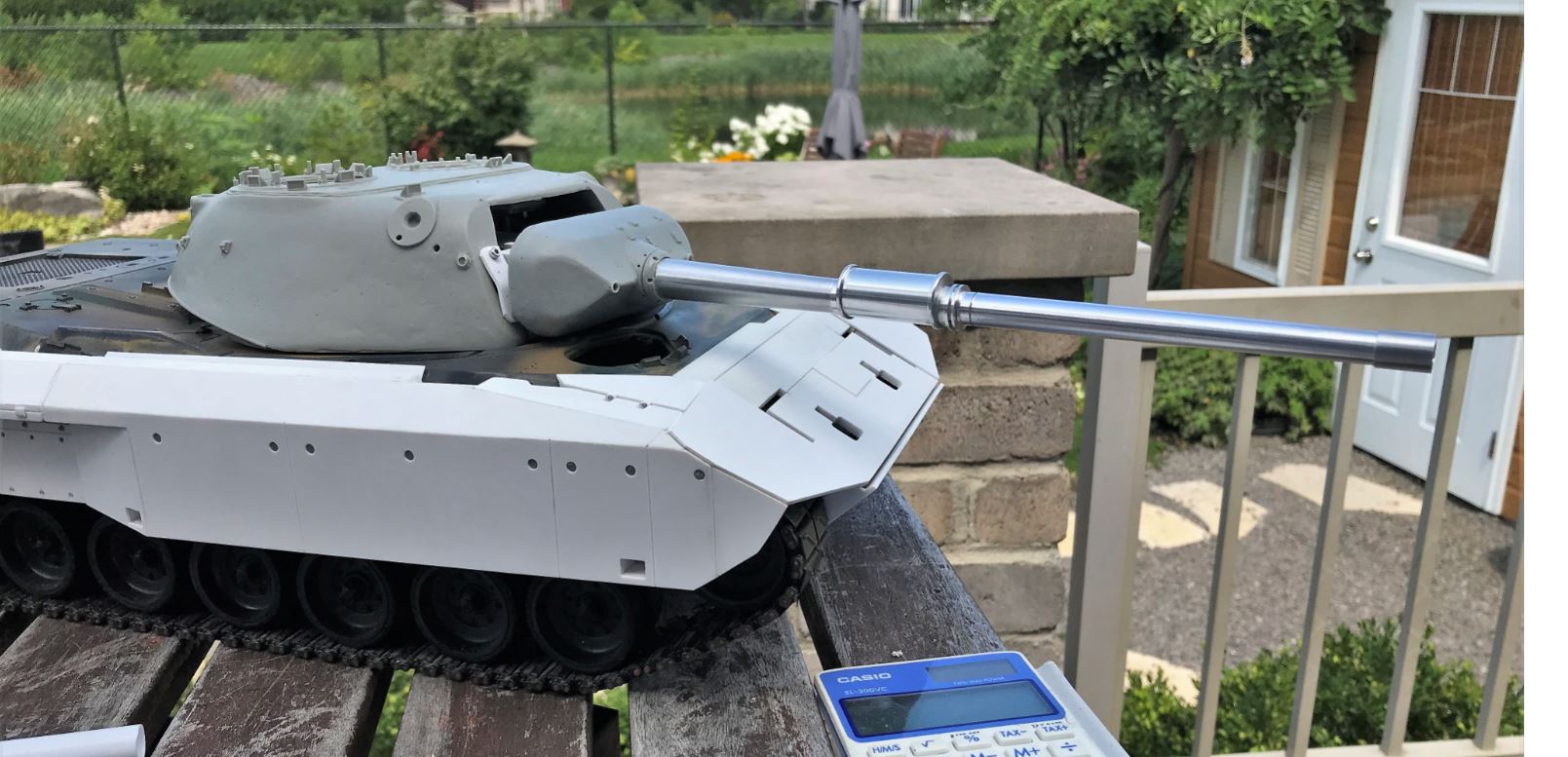

The position of the mantlet is determined by double checking with the 1/35 kit.
Instead of having the barrel holding to the recoil unit at the tip with a small questionable hex screw pin, the brass tube extension is made to enter the recoil unit all the way through by temporarily removing the recoil gear mechanism, then drilling 2 holes in the brass tube at the right location in relation to the required gun length, and then reassembled with the screws going in the brass tube for a strait and solid recoiling metal barrel. The extra length of the brass tube is then cut.
Overview of the 105mm L7 metal gun barrel mounted on its newly designed gun mount and DKLM recoil unit ready for mounting on the turret. It makes a nicely laid out and balanced gun with excellent quality parts.

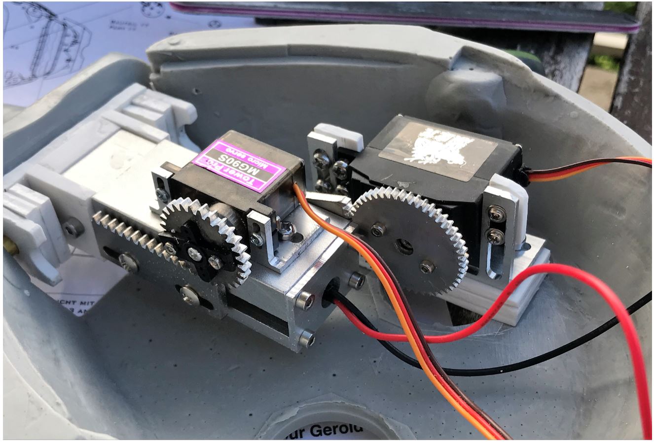

The DKLM elevation unit base is used but the turret is too small to fit a full size servo. A WPL medium size steering servo is installed on the base with some plasticard parts to bridge the gap in size.
View of the inside of the 1A5 turret with DKLM recoil and elevation servo. Gun flash wires are coming out of the recoil unit rear area.

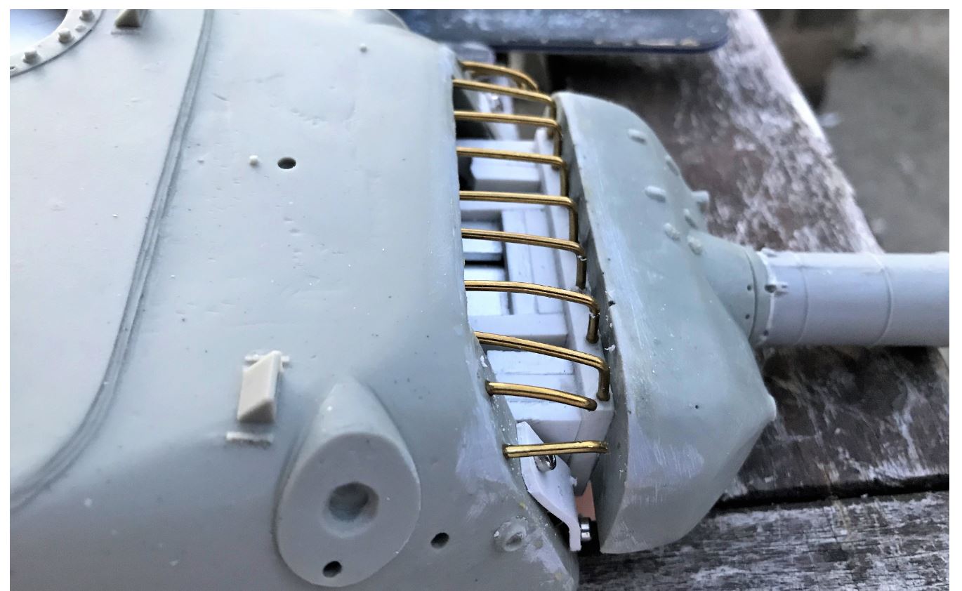

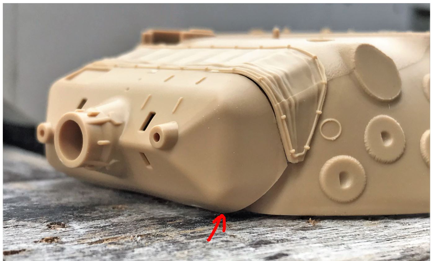

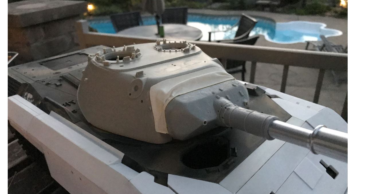

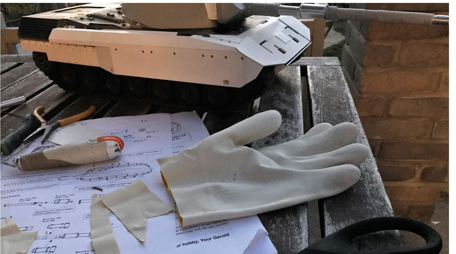

The canvas cover for the mantlet is always a complicated thing to do, results can range greatly depending on the methods and skills of the builder. It is sometimes better to ignore it but in the case of the Leopard, the gap is so wide that it is absolutely required, no matter the results.
Study of the 1/35 kit show the presence of supporting fish bones under the cover. It is a good idea to reproduce them first.
These are made in brass rod, inserted and glued on the mantlet plasticard base after holes are made for them to be firmly in place.
They are kept loose for the hull so that the gun can elevate. The fish bones simply go under when the gun elevates.
Kitchen cleaning gloves have a good texture for the canvas cover. The material is firm but also elastic to some extent. I will use the inside texture.
The barrel elevation is positioned in the middle, the fabric part is cut and glued first to the hull with superglue.
Glue is then applied to the mantlet and the fabric is stretched lightly before being applied against the glue. Then the fabric is cut at the right location. I am noticing that i will need to reduce the length on the side a bit to match references.
I think i put the mantlet at the right height as it compares well to the 1/35 kit position. And the canvas cover shape looks realistic. Considering the disasters of some of my early builds when i attempted this task for the first times, this canvas cover looks pretty good for 30 minutes of work.
Even at full elevation where the canvas material can potentially fold in uncontrollable directions with unrealistic results, the canvas cover does not look too bad. Using a material that can be stretched a bit like the kitchen glove really helps. This is best case scenario. That's a load off.
Frontal view, showing some presence of the fish bones. But they are mainly essential to hold the canvas in place correctly. Some minor adjustments are needed.

Tomorrow, i will finalize it. When looking at the real thing, i can see there are holes with a rod going through hooks in each hole. A bit complicated to repro. I'll sleep on this one.

The Mantel Cover appears to be held in place with a cable passed through eyelets that protrude through grommets/holes in the cover. You could form the eyelets and use a single strand of copper wire for the cable. The grommets will be a little trickery.
