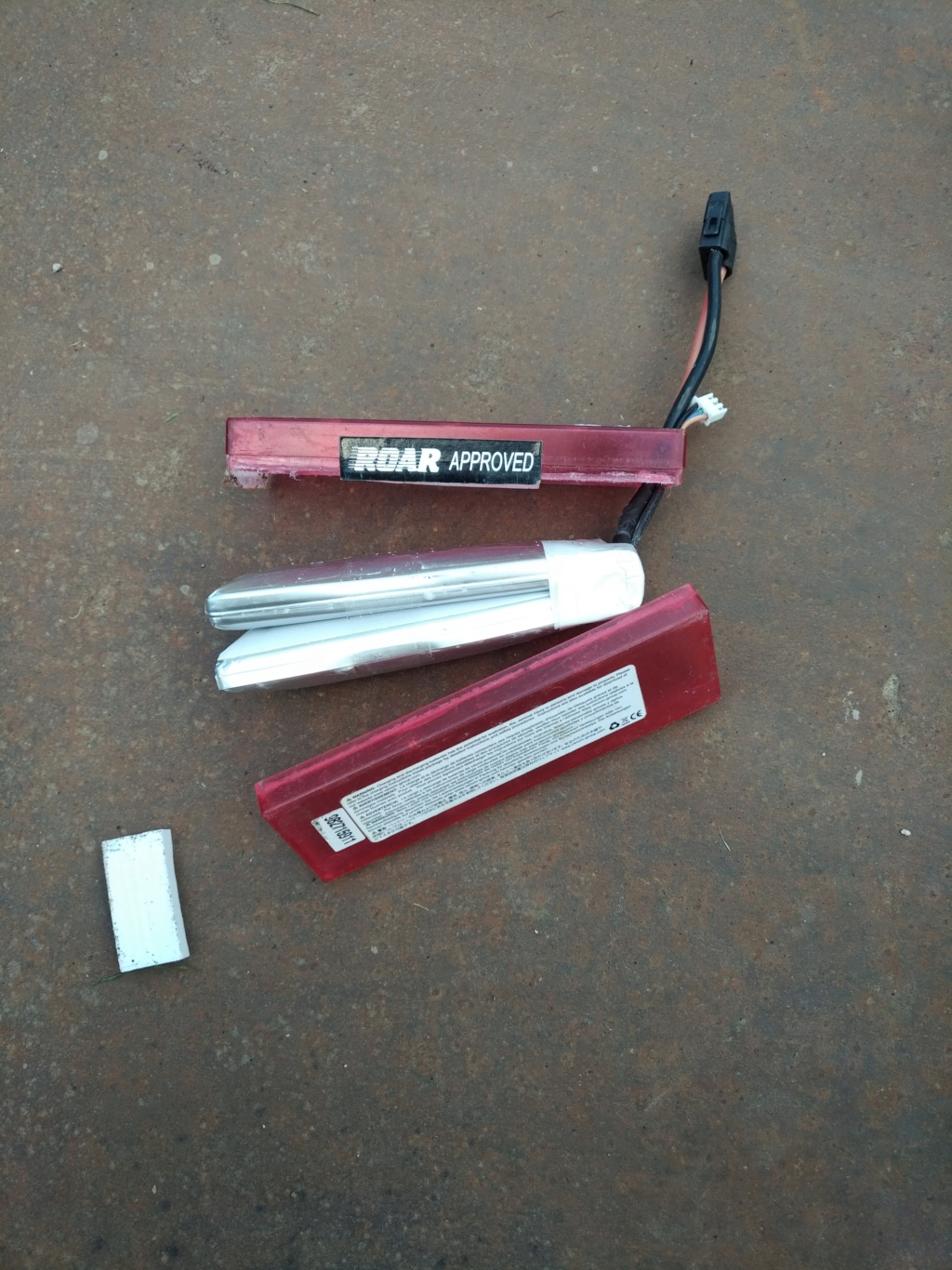

Now I have been using LiPO's for about the last 4-5 years (I have a score of them). I finally had to retire a Lipo battery that had started to swell/puff (it had been used in my RC Cars as well as my RC Tanks).
I noticed months ago that it had puffed to the point of splitting one edge of the hard case. I left it outside for the last 2 weeks and more puffing (due to being in direct sunlight and heat for days on end...) It puffed to split 3 of 4 sides of the hard case.
So the signs are easy to spot on Lipo's. Rate of puffing is not some instantaneous effect that occurs when not in use and as such can be easily monitored. Heat is the #1 killer for Lipo's.
