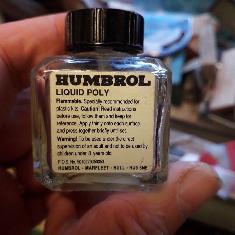

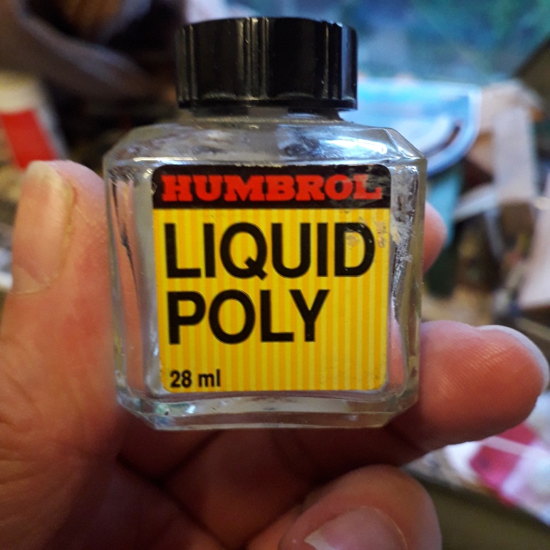

It is perfectly possible to glue the green ABS heng long tank plastic to styrene sheet VERY successfully if you use the right glue.
As mentioned above you need a glue that is both ABS AND STYRENE compliant then BOTH plastics are melted and weld together to give a very strong bond.
This is what i use, its VERY aggresive on styrene sheet and melts both together so try not to spill any on it if so let it dry THEN sand it off, the glass jar has a brush in it for application.
It also smells very strong when used for a short time.
